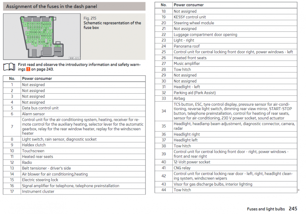

Have you cross checked with the manual? regarding fuses?
I do not know what and where are going. Almost half of the box is empty.  I looked in the manual and I cannot find the fuse for the infotainment system.
Fuse 10 check? touchscreen

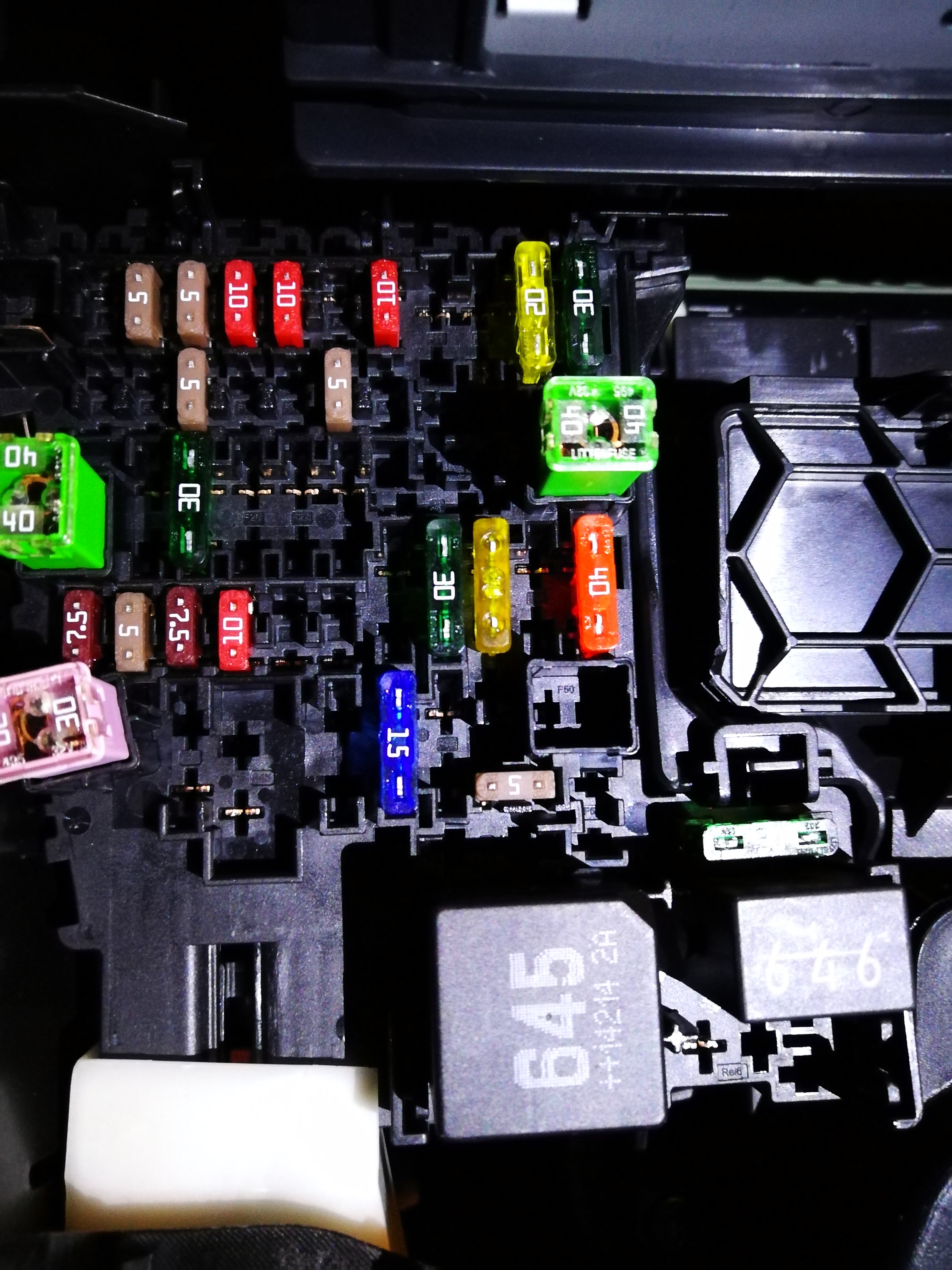

Here is a picture of my fuses.
You don't appear to have a fuse in 12 the radio fuse
What happened to it? Is it possible I moved it by mistake? I see it is one in 13. Could be that the one? What fuse should be there? 20Amp?
Solved!!! it seems I misplaced the fuse whilst I checked them.
