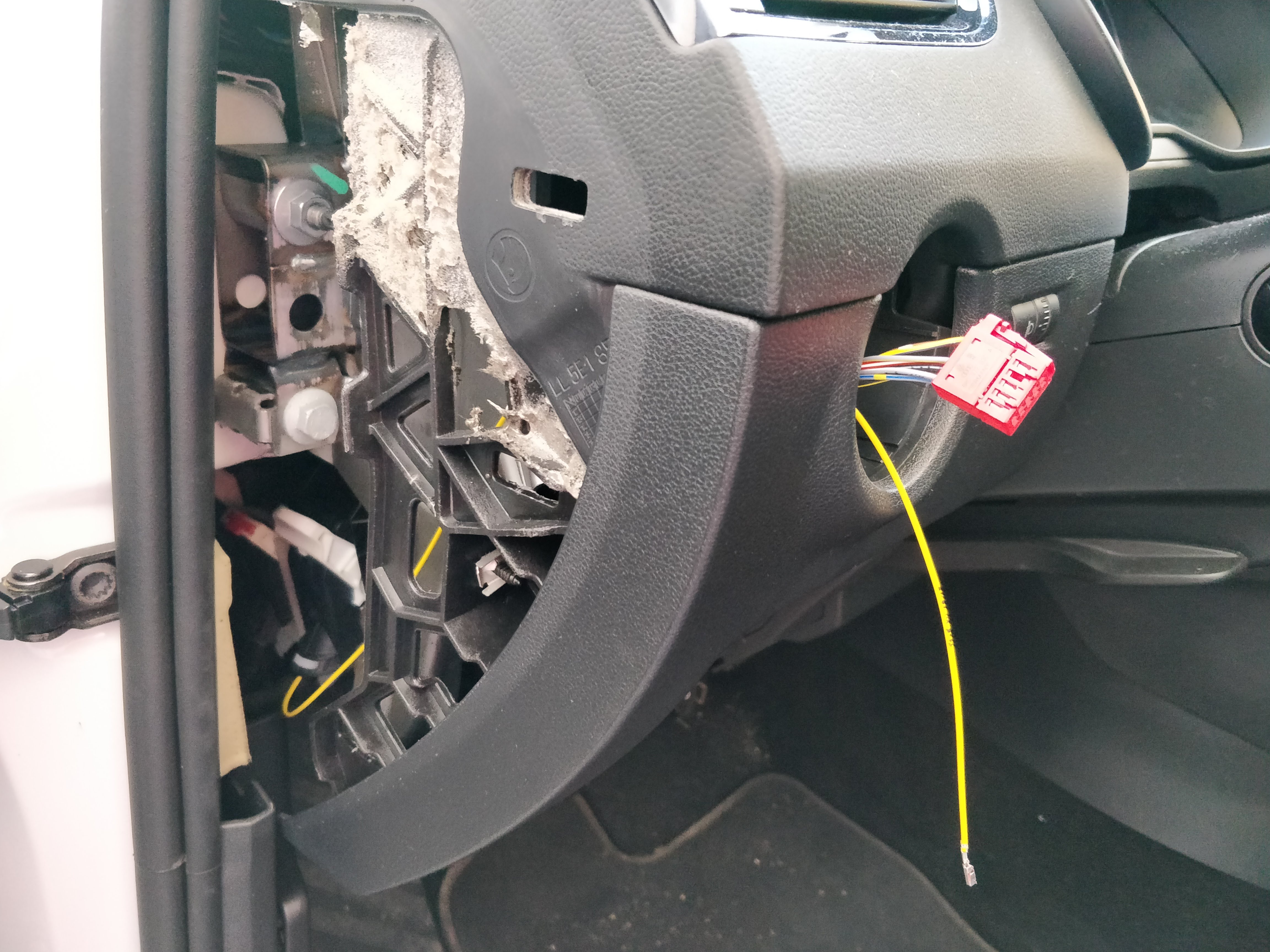

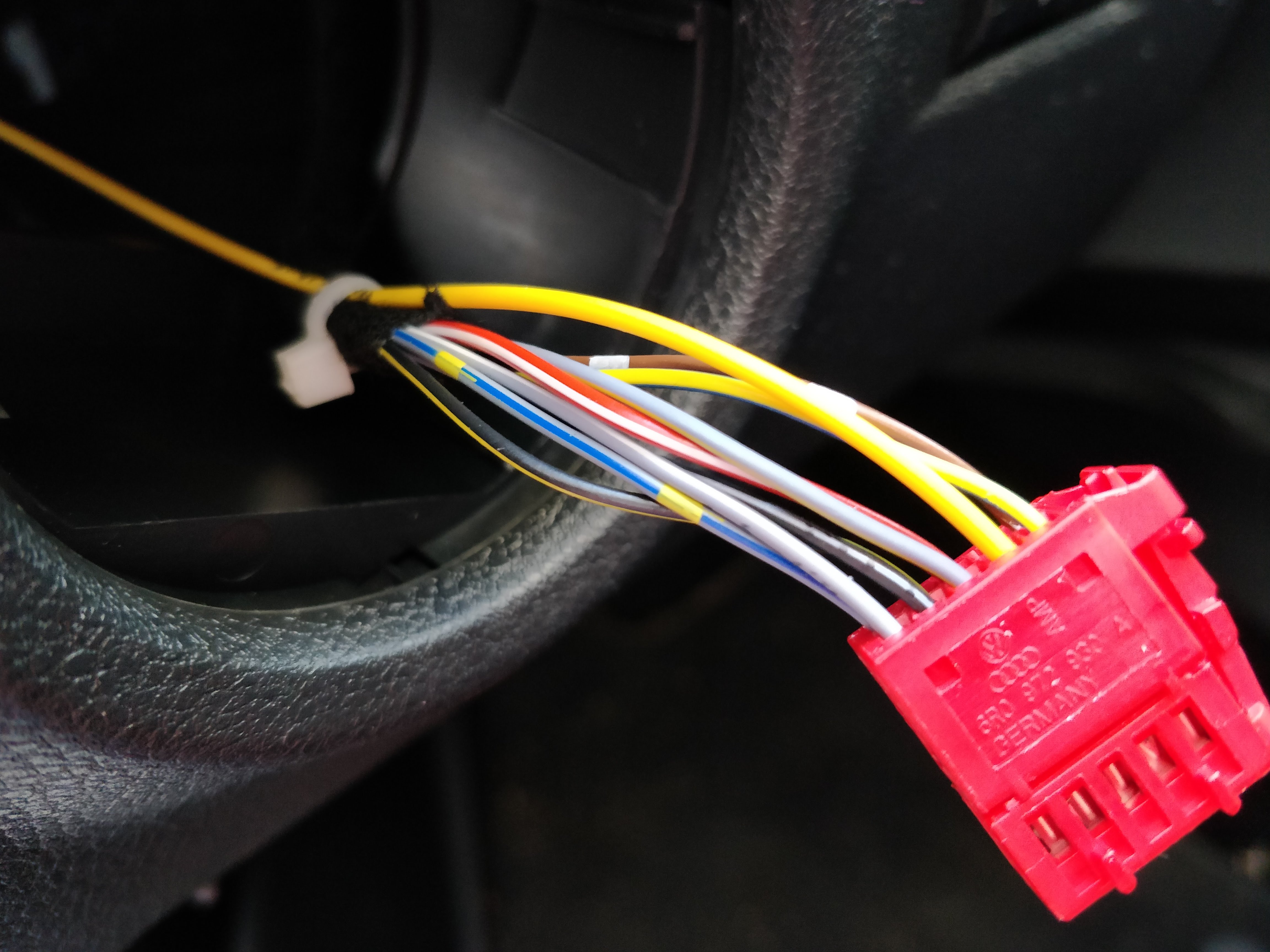

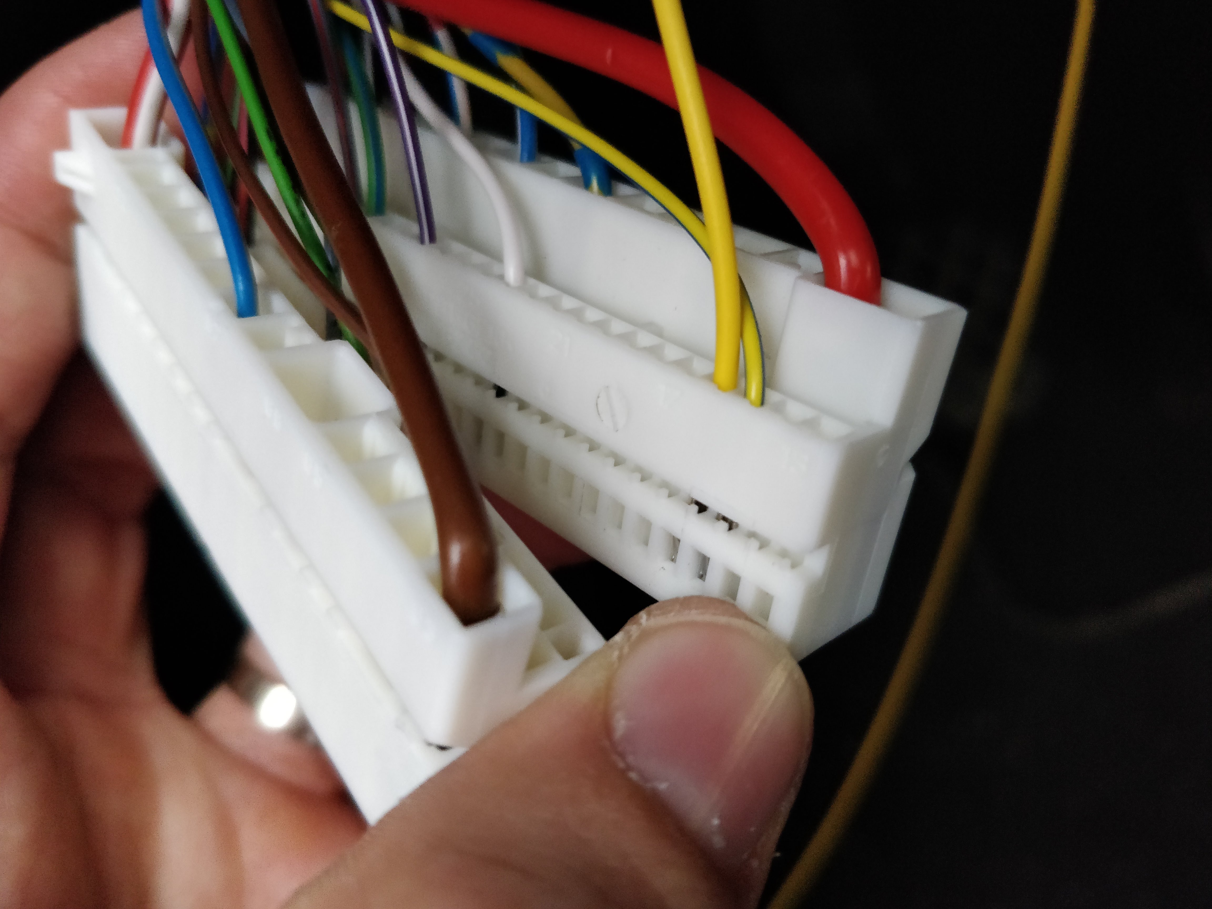

Hi all,
I've already installed the new sensor, the switch and the extra cable (Switch pin 2 to BCM pin 16).
Just can't find the correct encoding, can anyone help me?
Thanks
