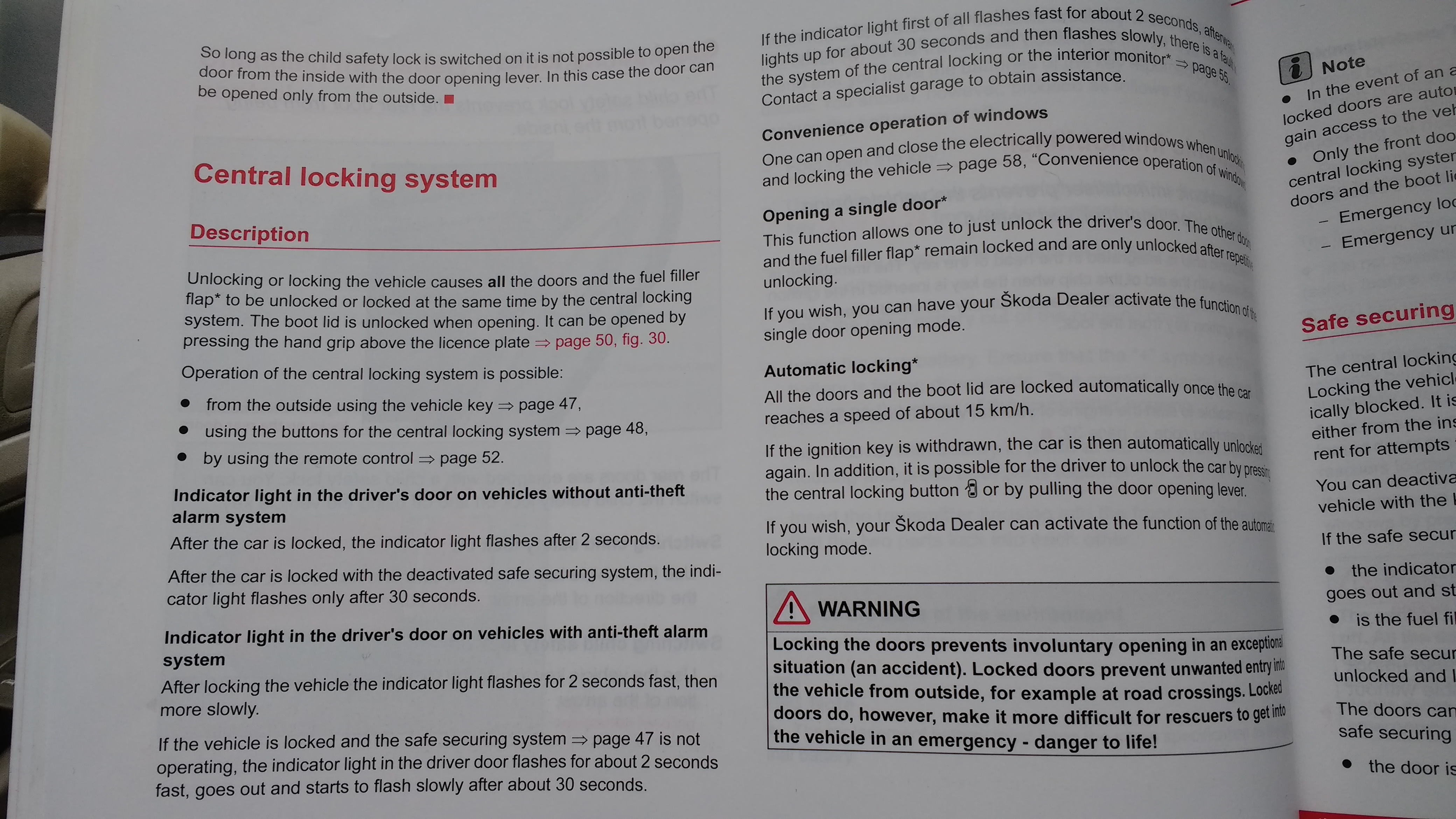

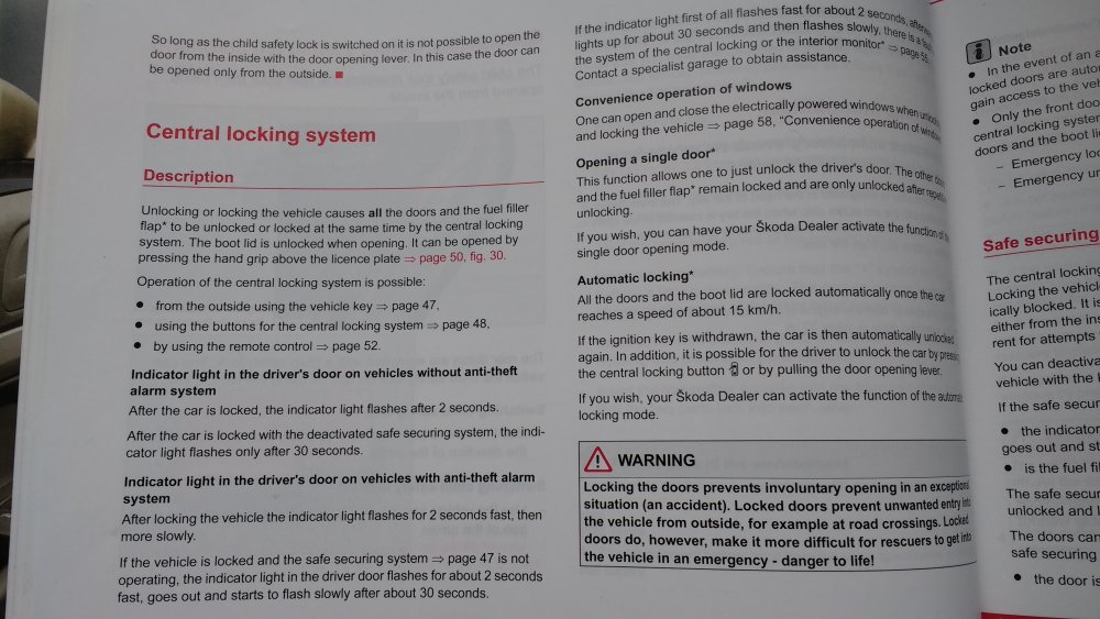

In my owner's manual it gives details on page 46 central locking system.
You must have a different manual cos there's absolutely nothing about it 5 pages either side of the central locking bit or page 46 in mine.
imageproxy.php?img=&key=66c1d7df650950daI tried uploading a photo of the page but keep getting an error.

Severn flashes is the NORMAL amount when everything is working correctly. Other information is indicated by the length of time between single flashes once it has locked.
cheers guys. Odd that one book says that and another doesn't.

When I bought my Scout brand new, rather than issuing  me with the latest handbook, there was a separate supplement stuck inside it with all the latest updates and changes.
