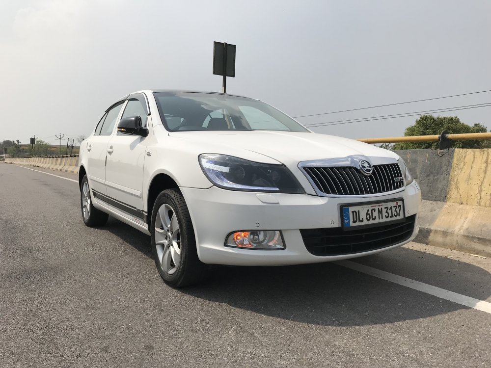

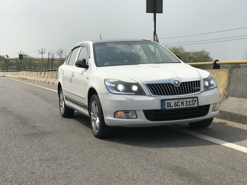

1. Reversed the stock DRLs to act as blinkers and stock indicators to act as DRLs.
2. Rear C shape on the tail lights is now L shaped and the brake lights only function as full time brake lamps(No position via brake lamps)
3. Activated US lights but gave up on that as the DRL function was gone.

2. LED DRLs and puddle lamps
3. Full LED rear panel (Philips brake and fog lamps, reverse lamp, indicators and postion lamps) inlcuding license plate lamps.
4. Used H1 LEDs on high beam but now upgraded the front lights to Quad-Bixenons including headlight blackening to piano black

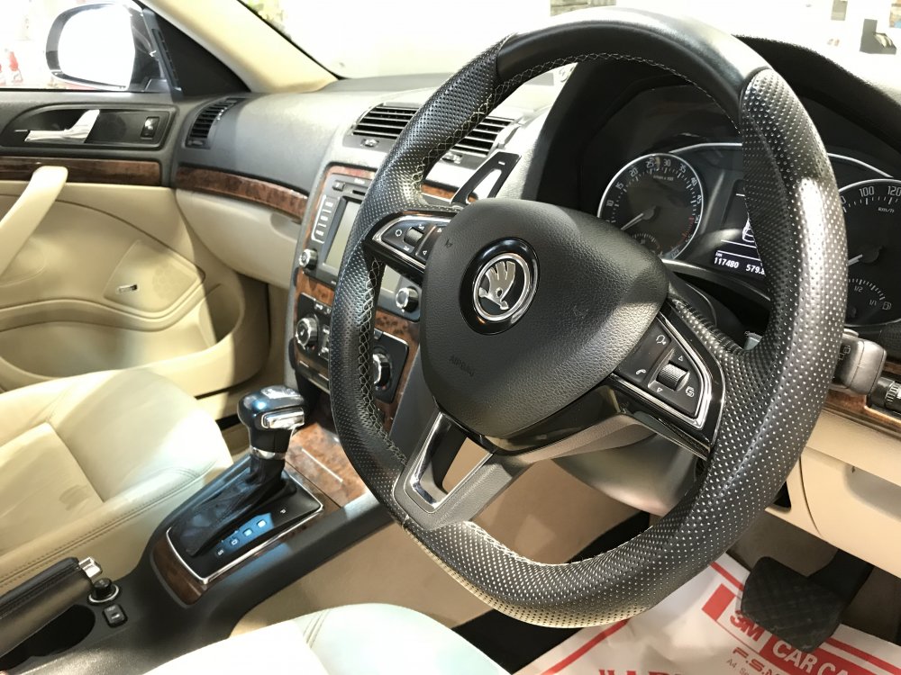

6. Flat bottom Steering wheel with paddle shifters

I know you all want to see the car as it is now so wasting no more time on words now. Let the pics speak. Please share whatever you feel about the car.
