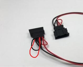

If you wouldn't mind, could you explain the process of relocating the wires and how difficult is it to do so?
Basically you take the earth loop and move it to the middle and the live loop to the outer. Hope my dodgy diagram helps?
Oh, you do that with the adapter? Afterwards, the two plugs should fit and work fine inside the adapter right?
Picture of the plugs from the car: lmv15dX.jpg
Yes hope that makes it easier to understand? The brown and white are the earths and blue and white are the lives. Its always a brown with a trace line that's the earth on the speakers. You will need to do the same on the rears as the other  plug is for the tweeter.
Edited by Guest
It does, will order them and try it. Will let you know if it works out, if it doesn't work, I believe the only option is crimping or soldering which is something I wanted to avoid.

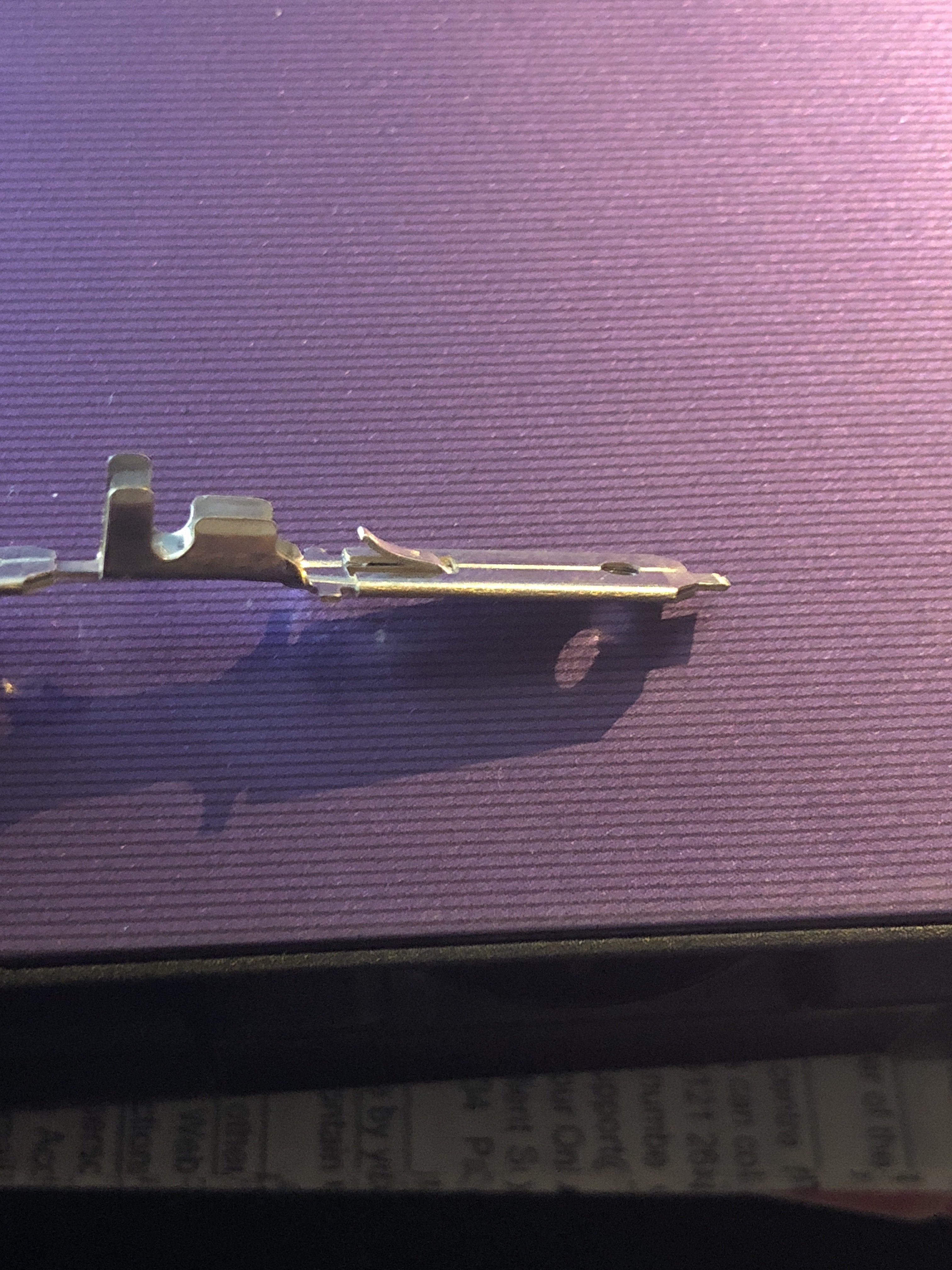

Hi, just received the adapters today. How do you exactly swap the wires? Do you just pull them out by the wire as there isn't anything else to grab them or do you use a tool to do that? Just want to be sure so that I don't end up breaking the adapters.
Hi
sorry for late reply. There is a small locating tab on the terminal. You need a very small thin screwdriver or pick to push the tab down, then the pin can be removed, the tab pushed back up then push into the new position.
On 3/7/2018 at 14:34, Skoda_Driver1972 said:
13 hours ago, Skoda_Driver1972 said:
Hi
On which side is it exactly on? The flat side (left on the image) or the grooved side (right on the image)?
I can’t remember sorry it’s been a while since I did mine. That’s a bigger pin but that’s what your looking for. Look in the end of the connector that plugs in and you might see it.
Got it, that makes sense. Appreciate the help.
