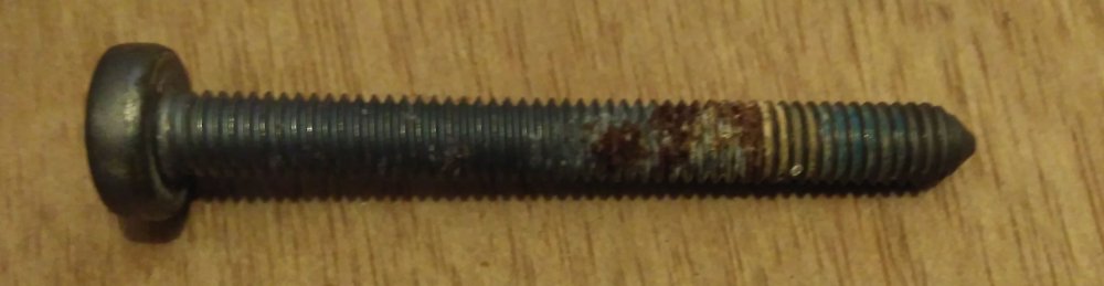

I did take the plastic engine cover off, just to check there's nothing obvious being hidden. Good job I did, as the bottom LH screw was rusted in. It nearly sheared off a torx key, and I had to use a 3/8" drive version to break the rust grip, not something I'd have been able to do with the tool set I carry in the car.
