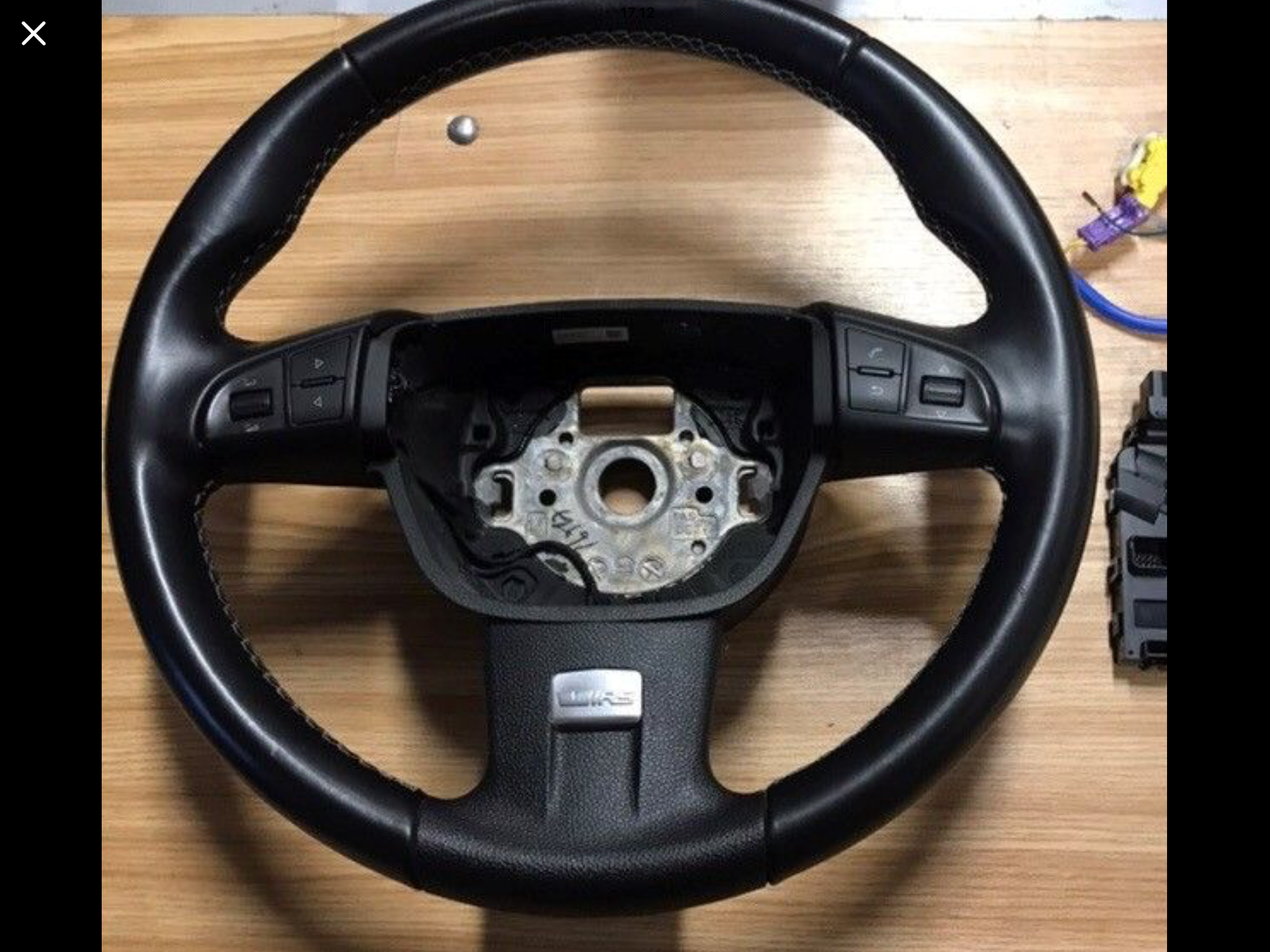

is it possible to put a multifunction wheel from a Octavia year 2011 into ta Skoda fabia 1,2 greenline year 2011.
The multifunction wheel has paddels in both sides and i Think int comes from a vrs.

So now i have made the connections from bcm to the steering wheel and it works.
is there anyone who can help me with the spare parts number for the airbag wiring loom for my steering wheel, (picture shown above).
