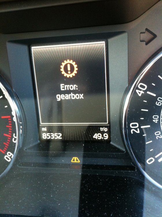

Despite being a manual car, the auto gearbox warning light is sometimes coming on! Any ideas, anyone?
What car, what light (is it an exclamation mark in a gear)?
Fabia 2. 1.6 TDi 62 plate, yes it is the gear with exclamation mark
I can only suggest that you get it scanned with VCDS and see what faults it has recorded.
I have never heard of that light iluminating on a manual car, but I could be proved wrong.
I will try a scan tomorrow, I hope.  That lamp is not even mentioned in the manual car handbook; nor does it light up on switch on. Trouble is, it comes and goes with no discernible pattern.
@m collinson - This sounds like a software issue rather than an actual problem, since you don't have a slushbox to throw slushbox fault codes.
Car is an elderly neighbours but is not showing this lamp any more; going to a awkward ti find, I reckon.
Well not to worry on that.
Has that person had the car near a Main Dealers in the last 18 months or so and had 'The Fix' carried out by any chance?
If they have had it then they have 24 months of the Trust Building Measures Warranty from the time it was done,
so they can just use that to have Skoda UK pay for a diagnostic on why any warning light is showing, especially a Auto Box fault / overheating one on a Manual car.
It was Cogs was it?
It was not the Brake / Parking Brake warning was it,
Brake Shoes with an Exclamation Mark,
Edited by AwaoffSki
Have you actually been driving the car when the light came on or is your neighbour telling you what happens?
Yes, I have seen  the lamp lit, it was definitely the gears lamp, EA189  fix not been done, car not been to a Skoda dealer since out of warranty,  as I said, its been OK for a few days now .
