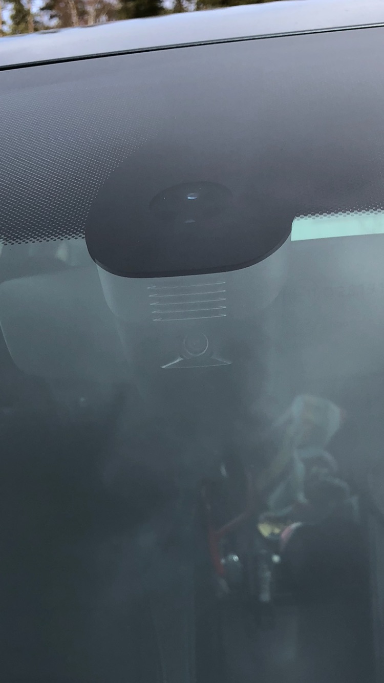

Hi,
I have a Kodiaq 190 TDI Style with area view, park- and trailerassist.
Is it possible to activate TSA and/or LA only by coding or do I have to do hardware installations also?
Regards,
Robert
If you have the camera in the windscreen then it can be coded.

Ok, I have to check that.

Yes, i have a camera in the windscreen :)
Is that a factory fit camera (or a dash cam) as it’s different to the others I have seen.
Factory, My car was build in week 2 2018.
It may just be a MY change then... or it may not be the correct camera.

How do I decide if it's the right camera then?
The only way to be 100%  sure would be to scan the car and see if it has a ‘A5’ controller
Ok. Thanks
Pretty sure that's a standard 'lowline' camera that is used for high beam assist. It's very similar to the camera I added to my MK2 Octavia for HBA.
You'd need a 'highline' camera for TSA and LA. It has a completely different mount and would need a new windscreen fitting...

Ok.
Can anyone find spare part numbers on the windscreen cameras available for Skoda Kodiaq?
At a guess, your lowline camera is either 565 857 511 A or 565 857 511 B.
A highline camera is probably either 3QD 980 654, 3QD 980 654 G or 3QD 980 654 H depending on when the car was manufactured.

manufactured in week 2 2018
If you got the upgraded camera, you will probably need a new windscreen I think.
