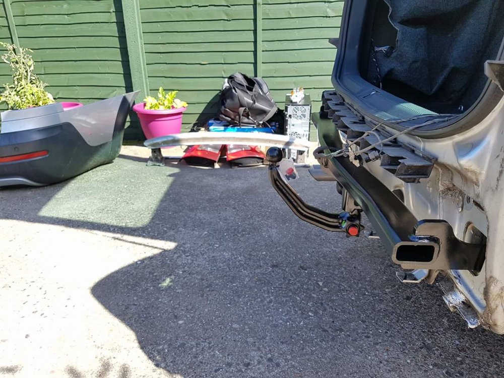

On my Oct 2 Scout yes.
Both rear lamp clusters had to be removed, the exhaust dropped off the back hanger to allow the metal heat shield above to be removed (to gain access to a hidden bumper bolt) and I managed to get to the screws in the rear wheel arch by just jacking the rear of the car.  On mine the mount holes fro the towbar were already there  (assume this is the same for all) and the cutout in the bumper was already there from factory (this maybe only on the Scout).
With the towbar fitted and bolts torqued it was all re assembled and a cold beer :)
Then I fitted the wiring loom.  Started at the back, control module in the boot (by rear passenger wheel well), loom run behind passenger seats and then under trims to the front driver footwell and then up to the fuse box.  The biggest pain was picking the wires from the back of the fuse box.  I managed it with a small split pin but would advise buying the correct tool from eBay as there only a few quid.
Finall coding on VCDS.  I'd say it took 5hrs all in to do having never done anything on this car before and having to work things ou.  It looked an absolute minefield on the instructions at first so I read through and highlighted every applicable page.

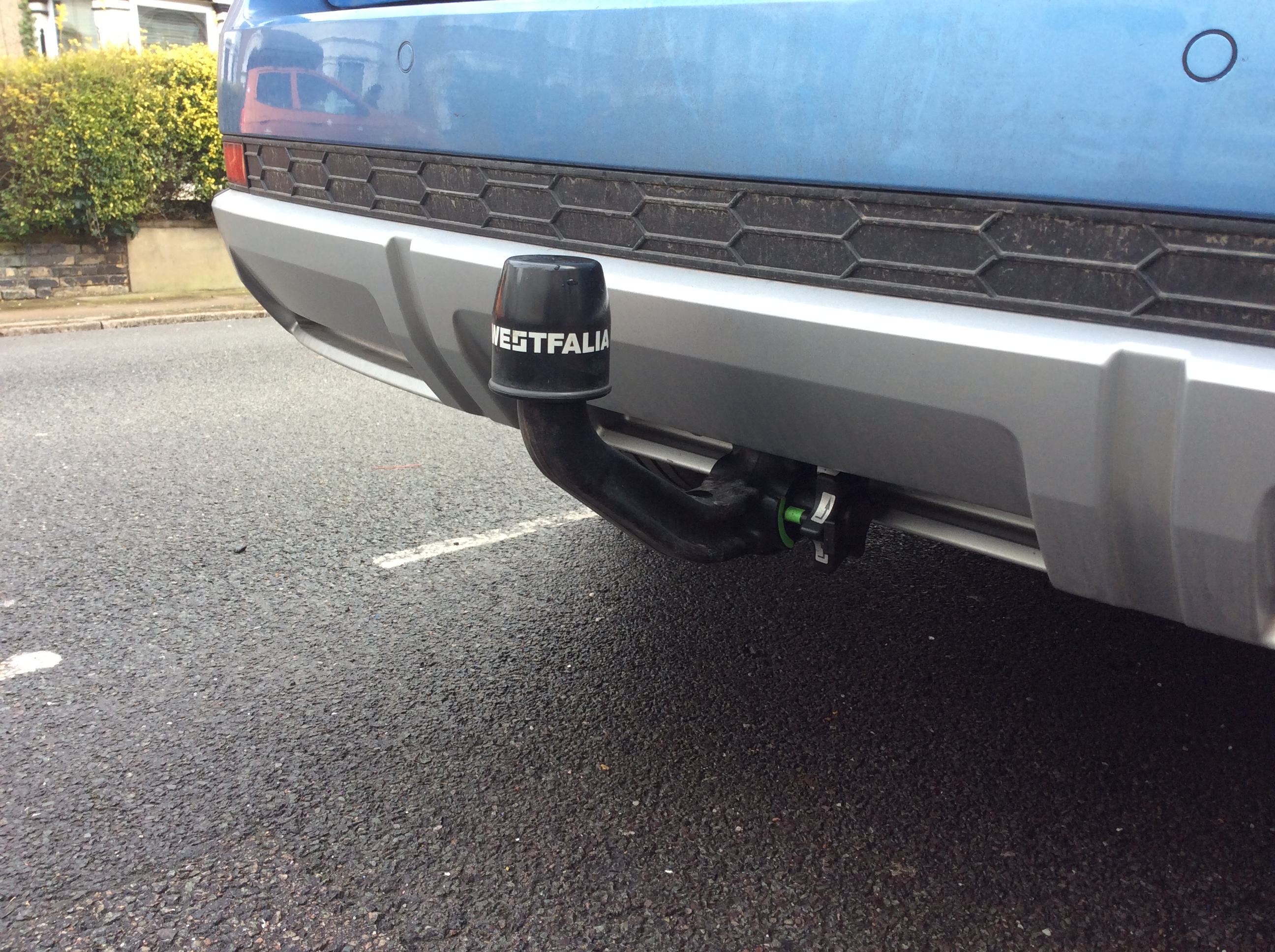

I fitted a detachable Westfalia with the proper plug and play loom which is more expensive but I felt it was a better quality product and the plug and play loom was for ease of fitment.  You can download the instructions on line to review to see if you would be happy to do yourself.

Funny you say that.  One of the reasons I got the Westfalia on the Oct 2 Scout is it looked half decent (as far as towbars go).  My Oct 3 Scout has a factory detachable (unsure who makes it) and it looks bloody awful.
I took the Westfalia off my old one, if it would fit the Oct 3 I would swap it over!
