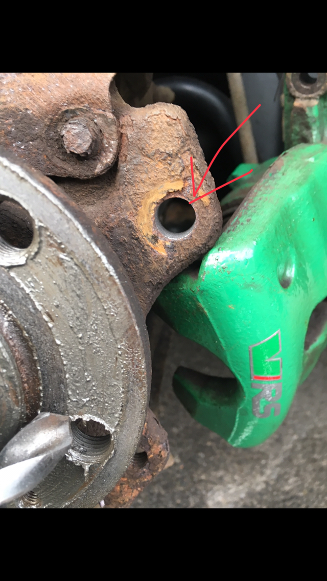

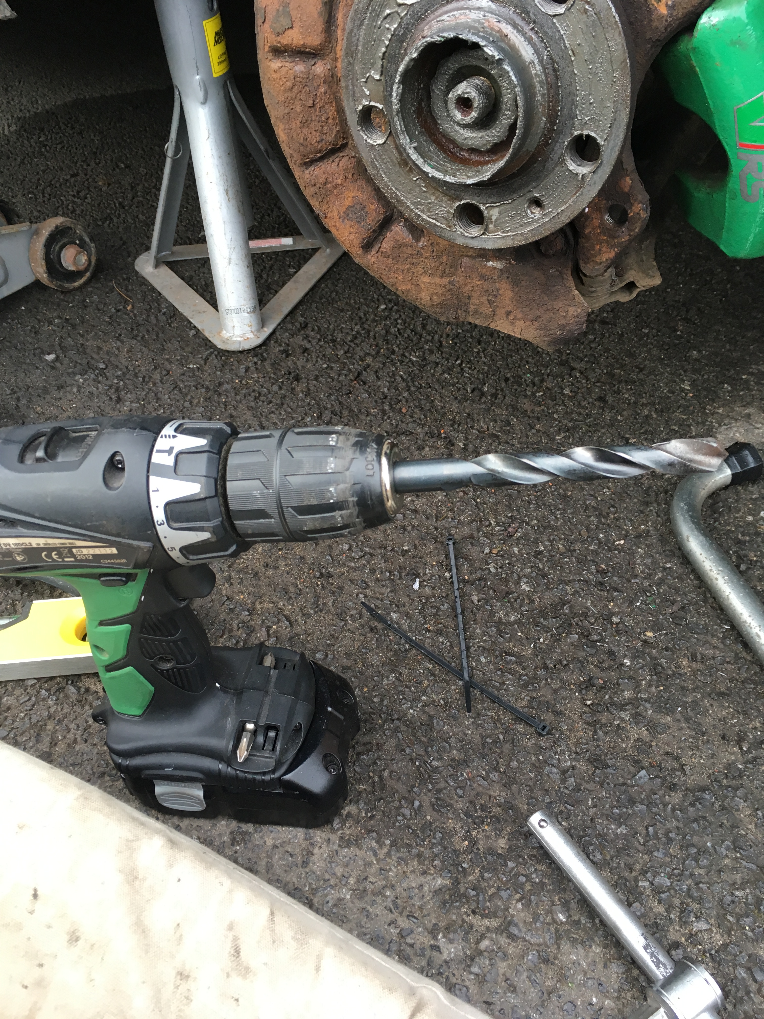

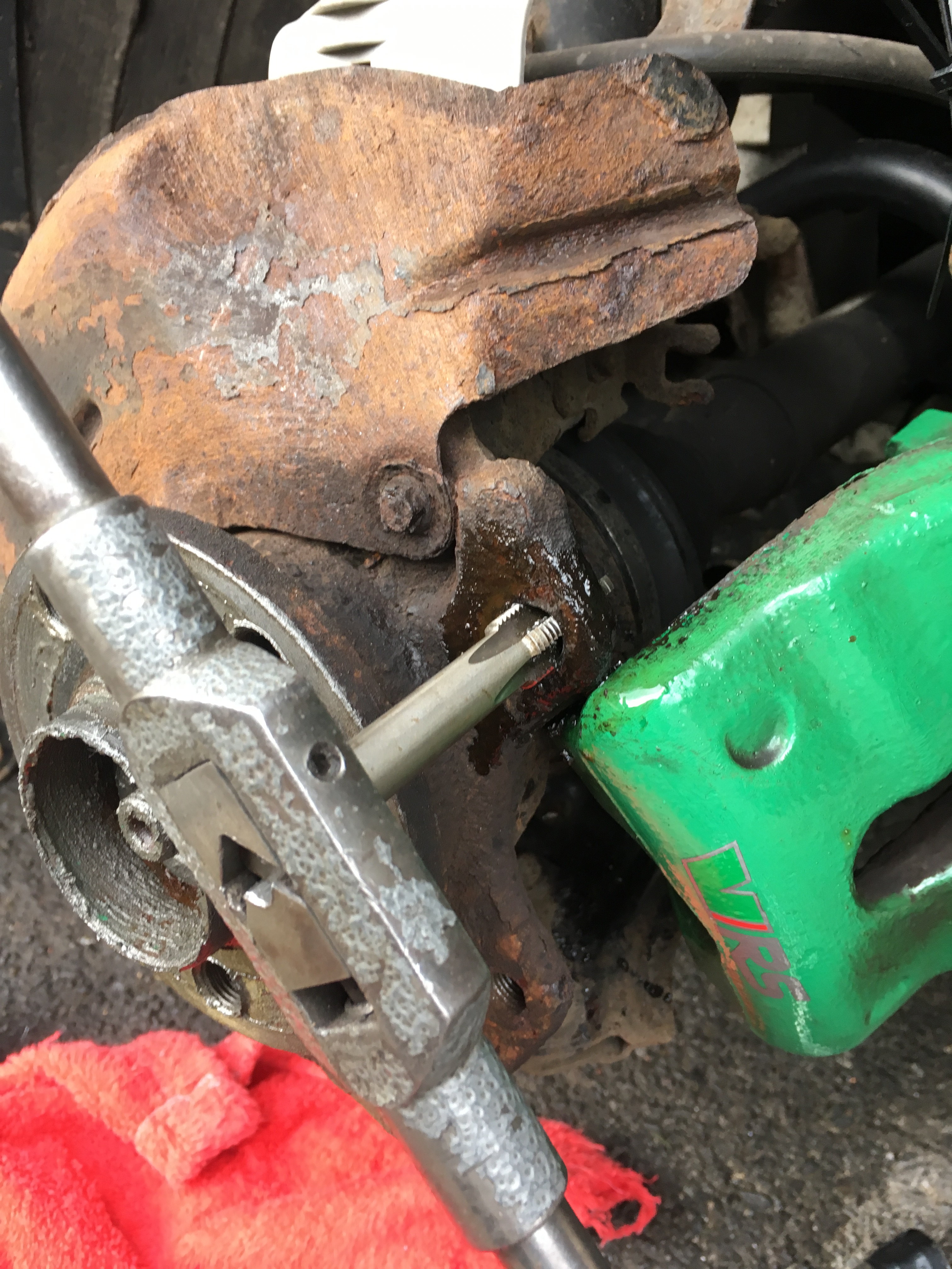

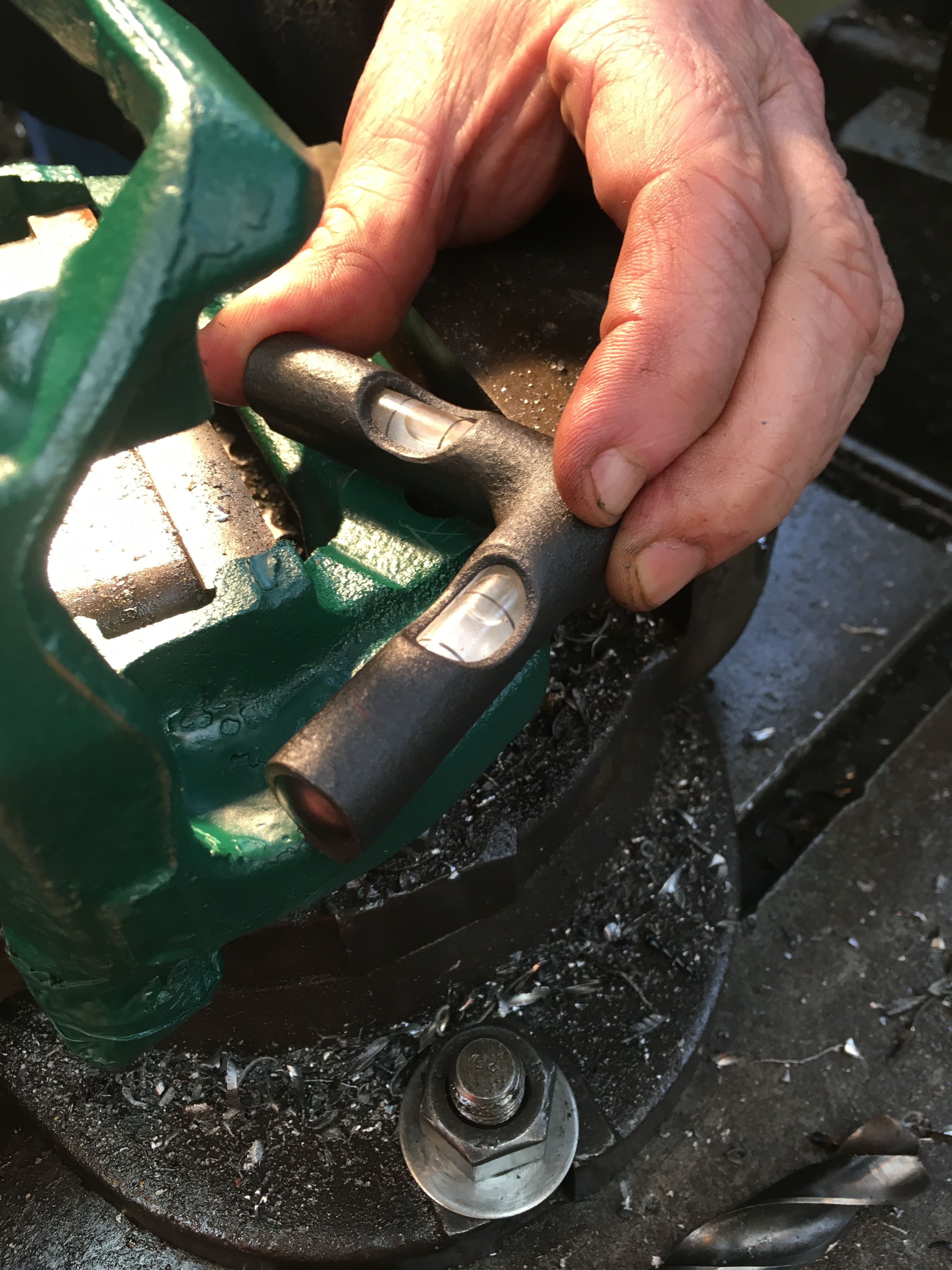

All sorted Wino. I drilled and tapped the hub to M14x1.5. I used a 31/64" drill by the way. Then opened out the carrier hole on the pedestal drill , making sure the job was level. Then fit a brand new M14x1.5x50 bolt ( which I had to cut to length) I couldn't get a serrated flange had bolt, so opted for a flat washer and serrated washer courtesy of Hawkes fasteners Middlesbrough. I gave the carrier a quick sandblast and paint whilst it was off to freshen things up. Then boxed back up. All is well. just a case of bedding the brakes in now. I haven't got a photo of the finished job as I was trying to beat the rain and forgot to take one.
