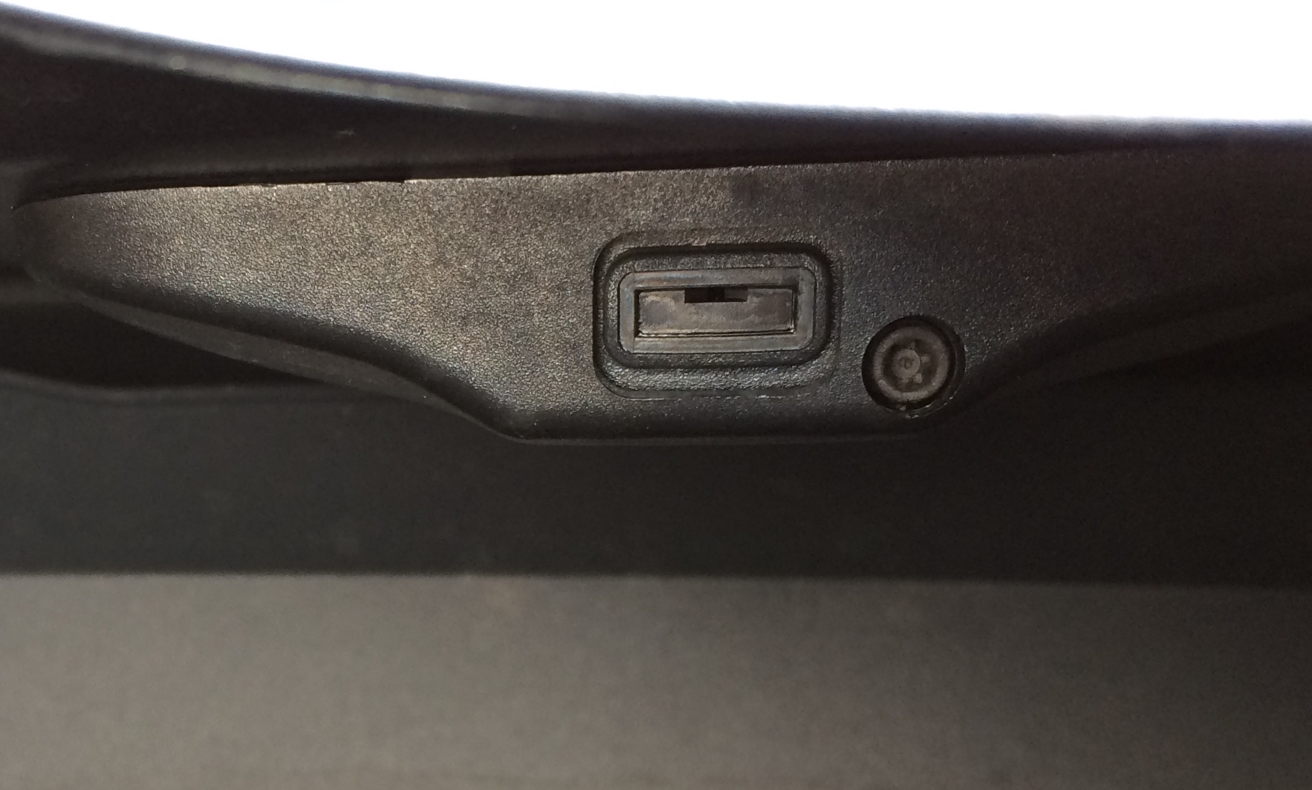

As touched on in passing in another thread, the little screw on the screen wash jets does in fact provide a little adjustment of the nozzle.
I originally thought it was a mounting screw, but a nice mechanic put me right when I complained about a poor jet and dodgy LH blade.
A Torx 10 key lets you tweak the nozzle.
I gave mine a half turn anti-clockwise and it seems to have raised the spray slightly. Still to road test at speed.

Good tip, thanks.
