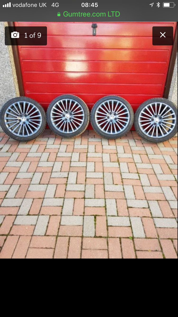

Morning Matt thanks for you time and help these are the wheels . As long as you think they will fit I will go ahead and get them, it’s just that I no nothing about wheel sizes etc ,and Skoda say 8jx18 44
Skoda sirus alloys part number 3T0071498HHA7

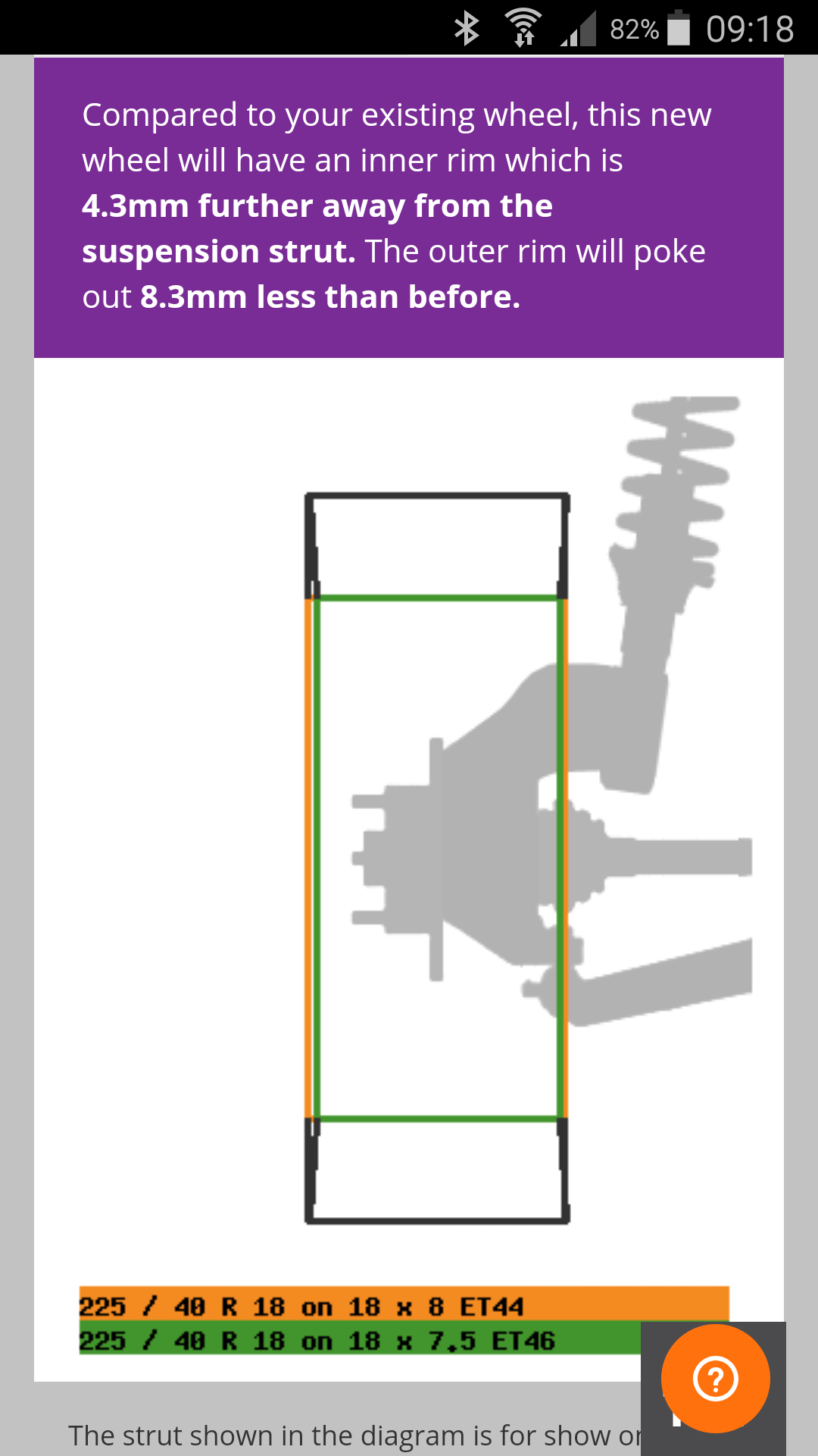

Measures 18x7.5j with an offset of ET46. The screen shot below from willtheyfit.com details new prospective wheels vs the 'skoda recommended measurements' in post #1.
It is all I'd need for me to know they'll be fine.
In short, the face of your new wheels will sit a little (less than a centimetre) further into the arch than the existing ones, and the inside edge will be less than half a centimetre further away from the suspension strut.
Hope this helps
