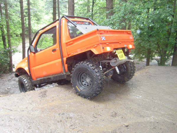

I used to run H2o in the rear tyres of offroaders for tyros etc, but only in summer as the balance was a bit off in winter, spring, autumn and sometimes even summer.
Edited by Offski
