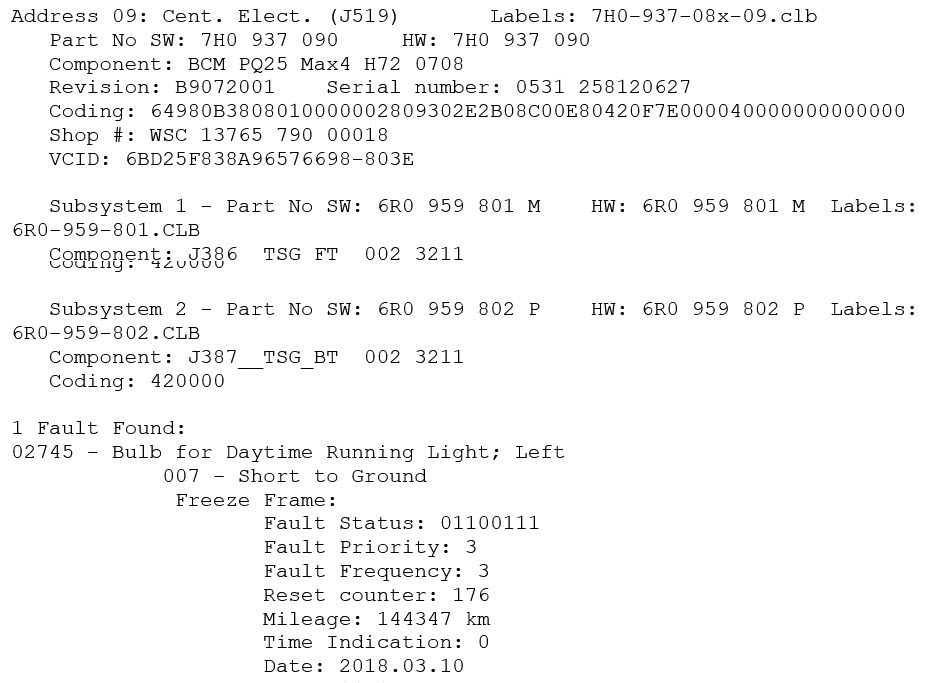

Ran a VCDS test and got the attached readout.
My feeling is there is bad connection to some kind of relay/switching circuit that controls switching on/off the DRL's with the main lights. Problem is, I have no idea where to look!
