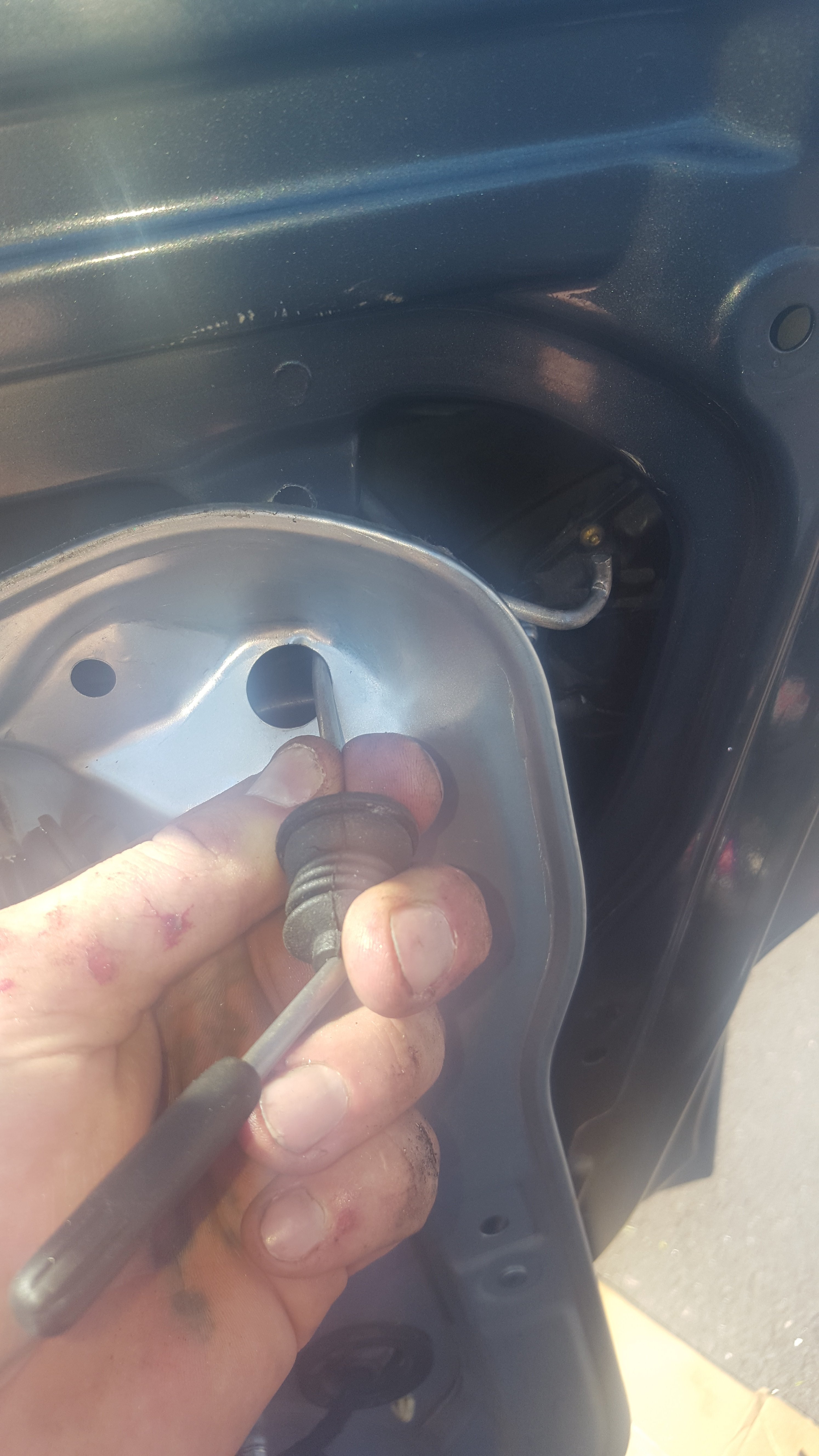

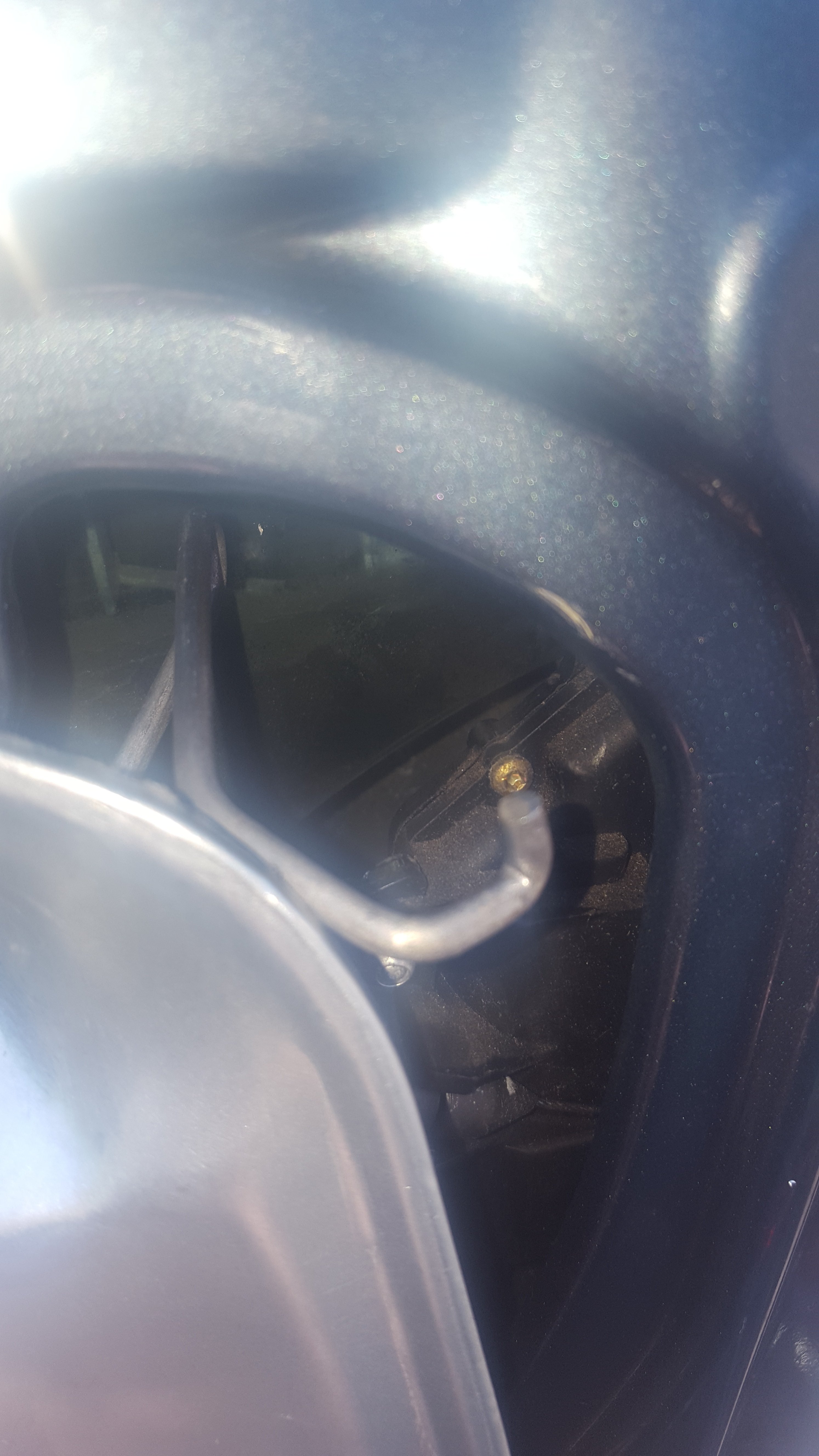

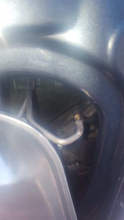

Hey TMB, all was going brilliantly until putting new panel in and the little lock knob wobbled out of place ! Where does it re-attach to?! Please help!
It fits into the door lock mechanism. Chances are the plastic part that holds it into place has cracked or snapped. They are of poor quality tbh and are a swine to refit due to lack of space/maneuverability.
..... and also a massive PITA to reattach to the lock mechanism and refit the carrier without dislodging it again!
After some wiggling, waggling and slight bending I got the bitch back in place! Sits about 3mm lower in the door card now but still works, goes up and down with lock/unlock! Feeling chuffed with myself and now have functioning windows in time for summer! Many thanks again briskodians! :D
