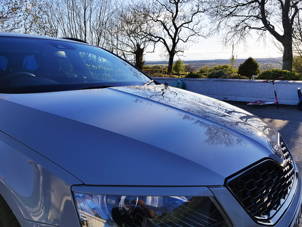

Recently converted to Fusso 99 based on recommendations on here. Can't yet comment on durability (It's only been on the car a fortnight) but I'm told the 2 coats I gave it will give me 6 months plus of protection. Topped it off with Megs Ultimate spray wax - gives the car a really sharp look.
One thing to think about (I learned about it on here) - Fusso (and similar polymer sealants) will only work properly if applied directly to the clear coat, so you would need to strip the dealer-supplied protection before you start, to get the best results. If you are just looking to add to the existing protection, a wax would do you better. If you decide to seal it, a top tip for the Fusso is to put it on extremely thinly and take it off before it has chance to dry.
