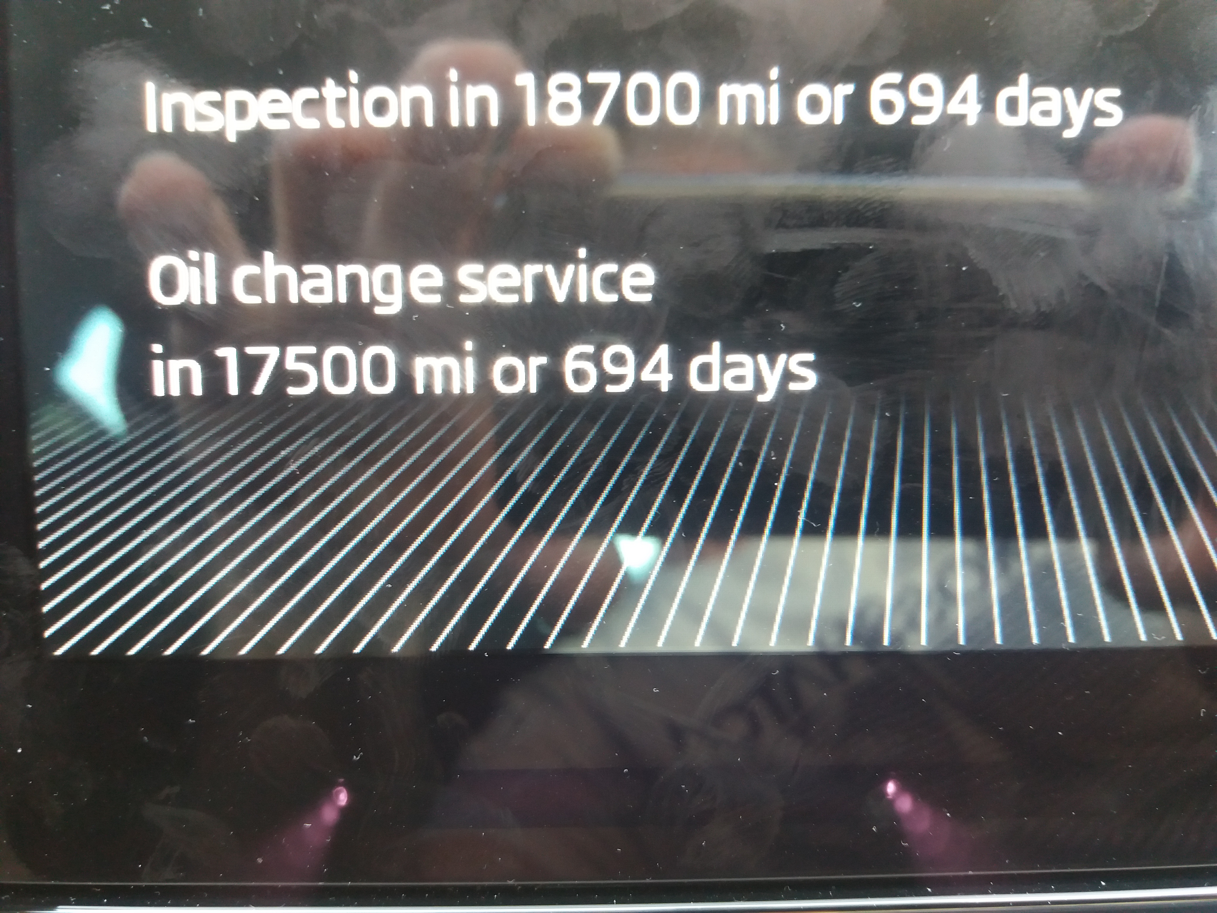

and what is your Service Indicator set on, Variable / flexible servicing as it left the factory or is it on Fixed Servicing, 9,400 miles / 372 days.
http://volkswagen.co.uk/owners/servicing/regimes
Edited by Offski
Spoke to 2 technicians. I don't know if one was master tech. Dealer contacted Skoda Technical and Skoda downloaded updated software to dealer. No mention was made of PDI or transit setting. Mileage on handover to me was 13 miles. There is a date in engine bay 12 02.18. The car still kangaroos although the revs don''t drop so much. See the pix for service indicator20180421_143611.thumb.jpg.5f7335cfe2d172692dc80ebf3db61812.jpg
