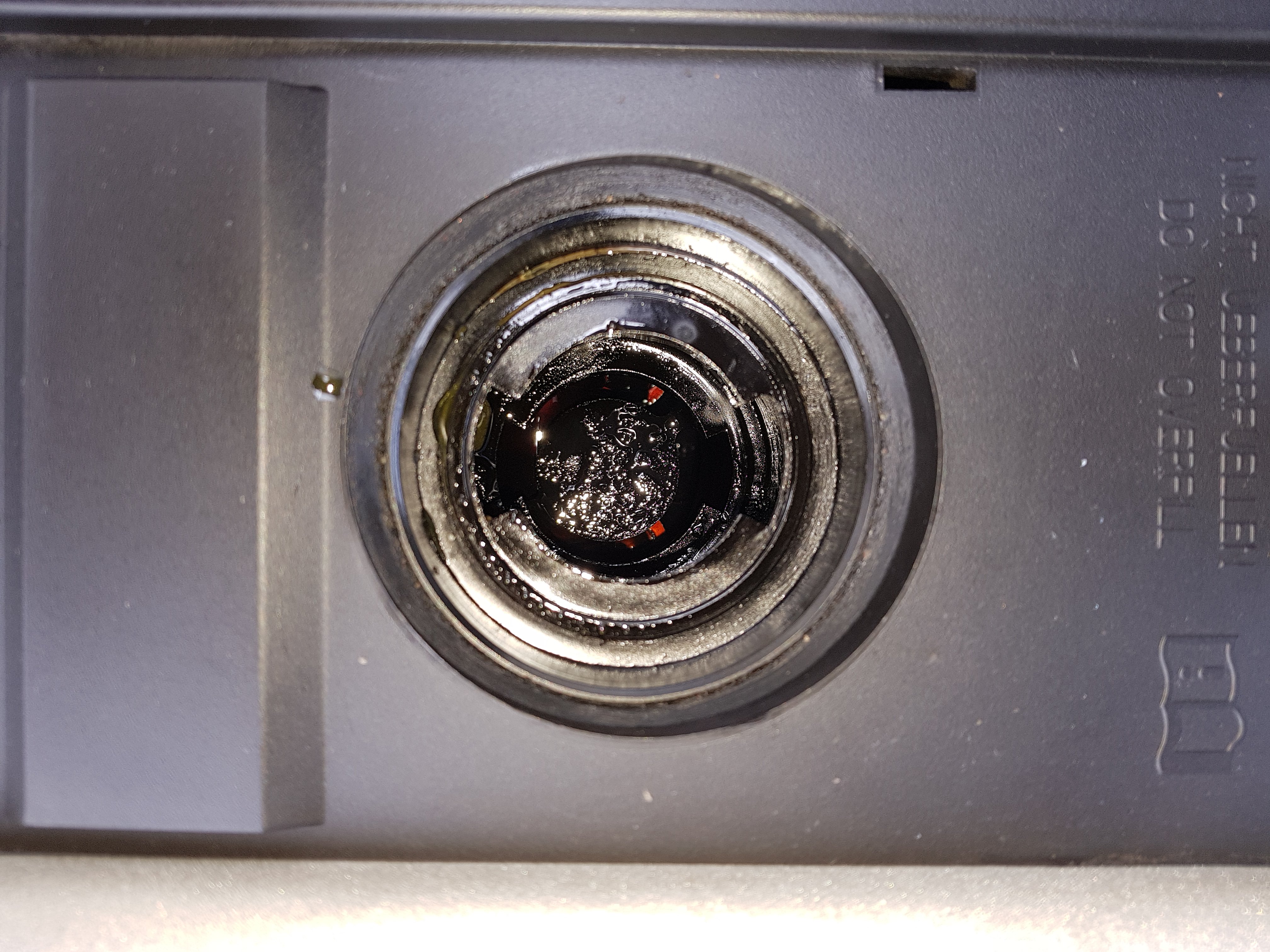

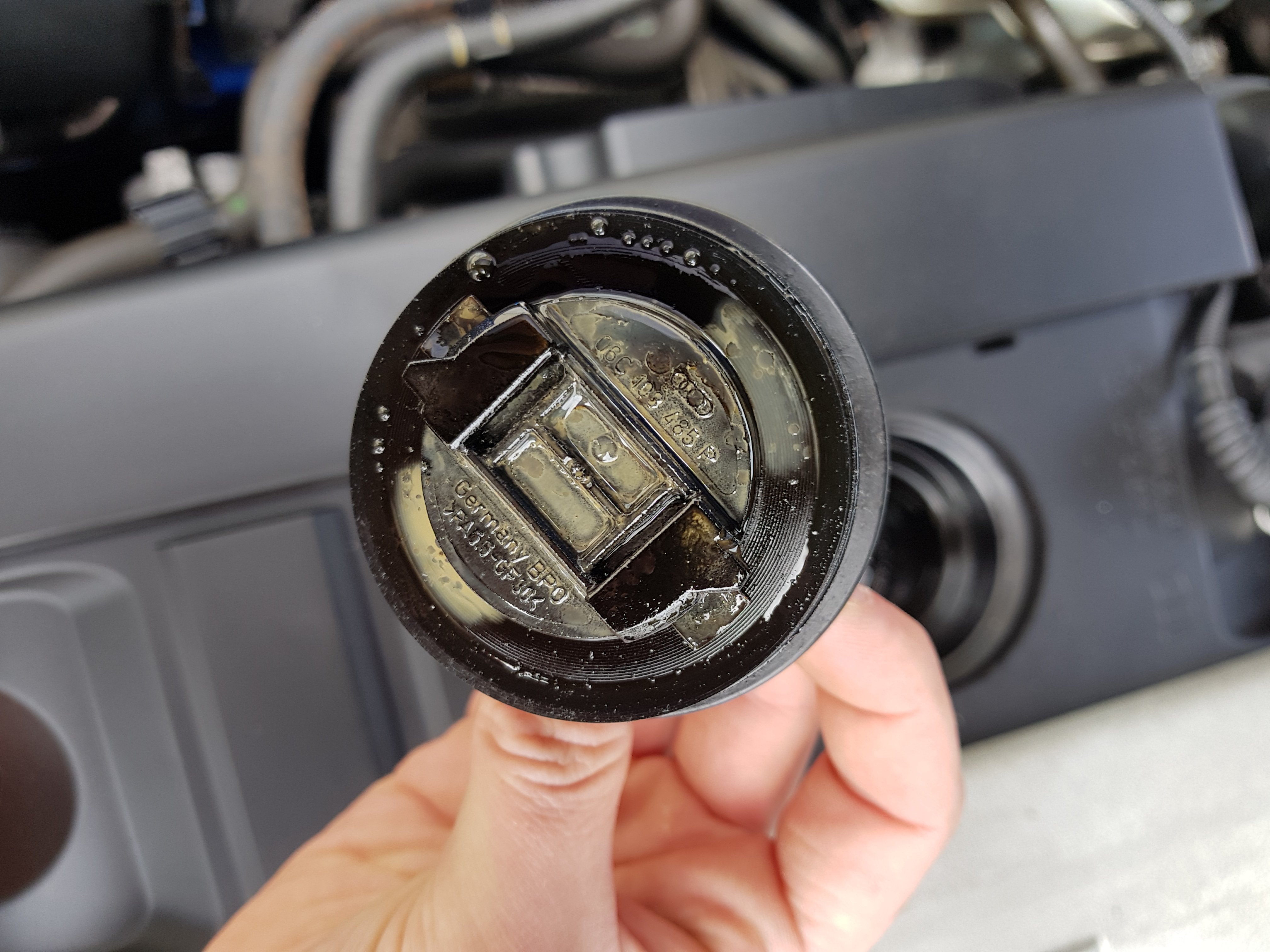

It all looks good but when I checked under the oil filler cap I noticed some mayo'ey gunk under the cap. I couldn't see any on the dipstick, I've also attached some pictures.
I've read on the forums that this is a relatively common thing, however I'm reluctant to throw over 3k at a car that could potentially have a HG issue!
What do you guys think of the pictures?

Need to take it for a good run and well warmed up and see if the Mayo disappears
For obvious reasons don't rule out a head gasket failure but I have a petrol vrs and mine is really bad for doing it. Especially in the winter time. Like mentioned above take the car for a lengthy test drive then check the dipstick and it should be clear.

I'm going back to look at it again later, trouble is the garage are going to do a full service before I do, presumably making the mayo disappear after doing an oil change... Am I right to assume that any signs of a HG failure could be covered up by replacing the oil/coolant?

I think I'd be more worried by the blackness/crustiness visible looking into the filler area, than that very light mayo on the cap.

Yeah that's also a worry!
