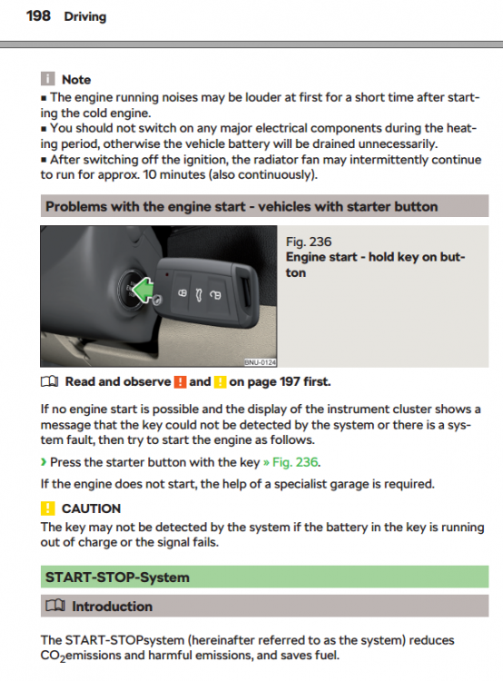

Does this help?   Manual p. 198-199.
Thank you for your quick response I tried what you suggested and the car started straight away. I did notice when I pushed the button with the key the red light on the key flashed so i'm hoping this means the problem is fixed. - fingers crossed....
