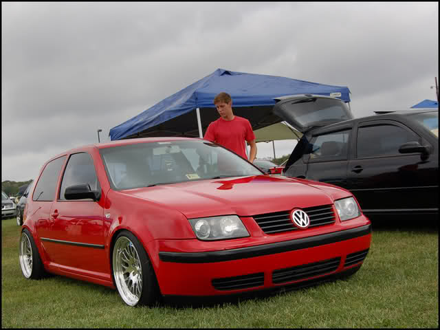

Reminds me of when people used to create a Bolf.  It's a lot of work but if it's what you want to do then go for it.
Bolf
