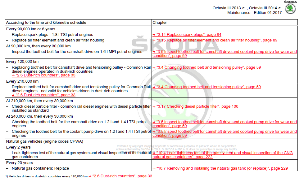

timing belt when to change
I asked skoda today when i was in for my inspection about the timing belt when to change it
they have told me on a 2017 1.6 tdi  its a massive 140k
this sounds to much
whats your views on this guys
Personally I wouldn't go beyond 100k.  Belts are a load better than they used to be.  Even so, everything has a limit.
The 2.0 tdi also has a 5 year limit.  Could be the same with the 1.6.
Maybe this table will help:
yeah its the same 5 years or 140k
think ill go 70k i just had a insignia 20 tdi 2013 the belt snapped at 69k vauxhall told me they are good for 100k
