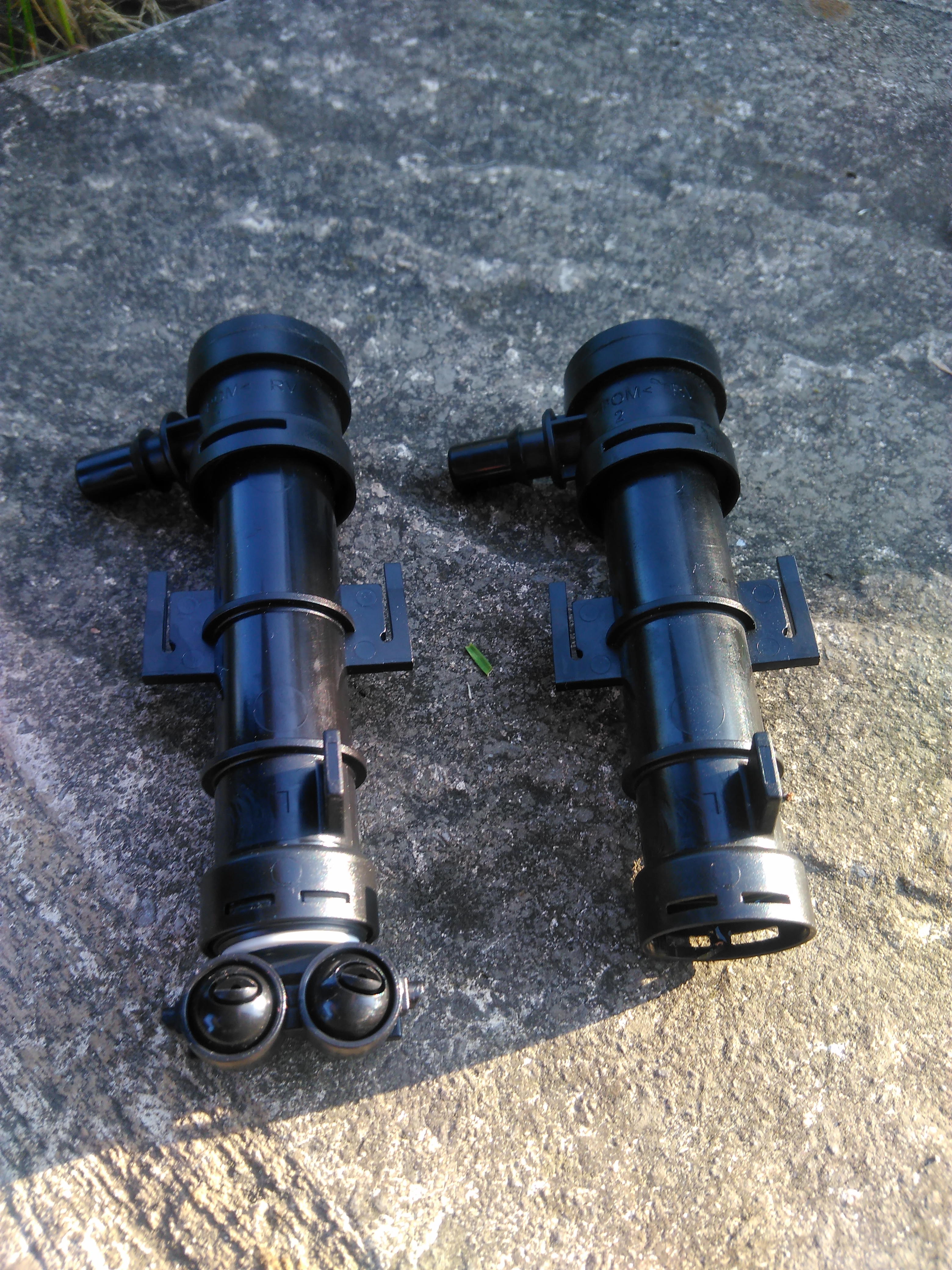

Having had a headlight washer lift tube blow off over winter, I finally got round to replacing it.
Passenger side is easy to take off with the bonnet up, just a bit of twisting and tab pushing to unclip and pull out.
New part number 5L0.955.965C replaces the part 965B.
Just over £30 from the main dealer.
These are shorter and thinner than the pre-facelift model.
The only difference I see is the C part has a redesigned bit where the jet nozzles clip into the main tube.
New part on left, you can see the white circlip which is the only difference I can see externally
