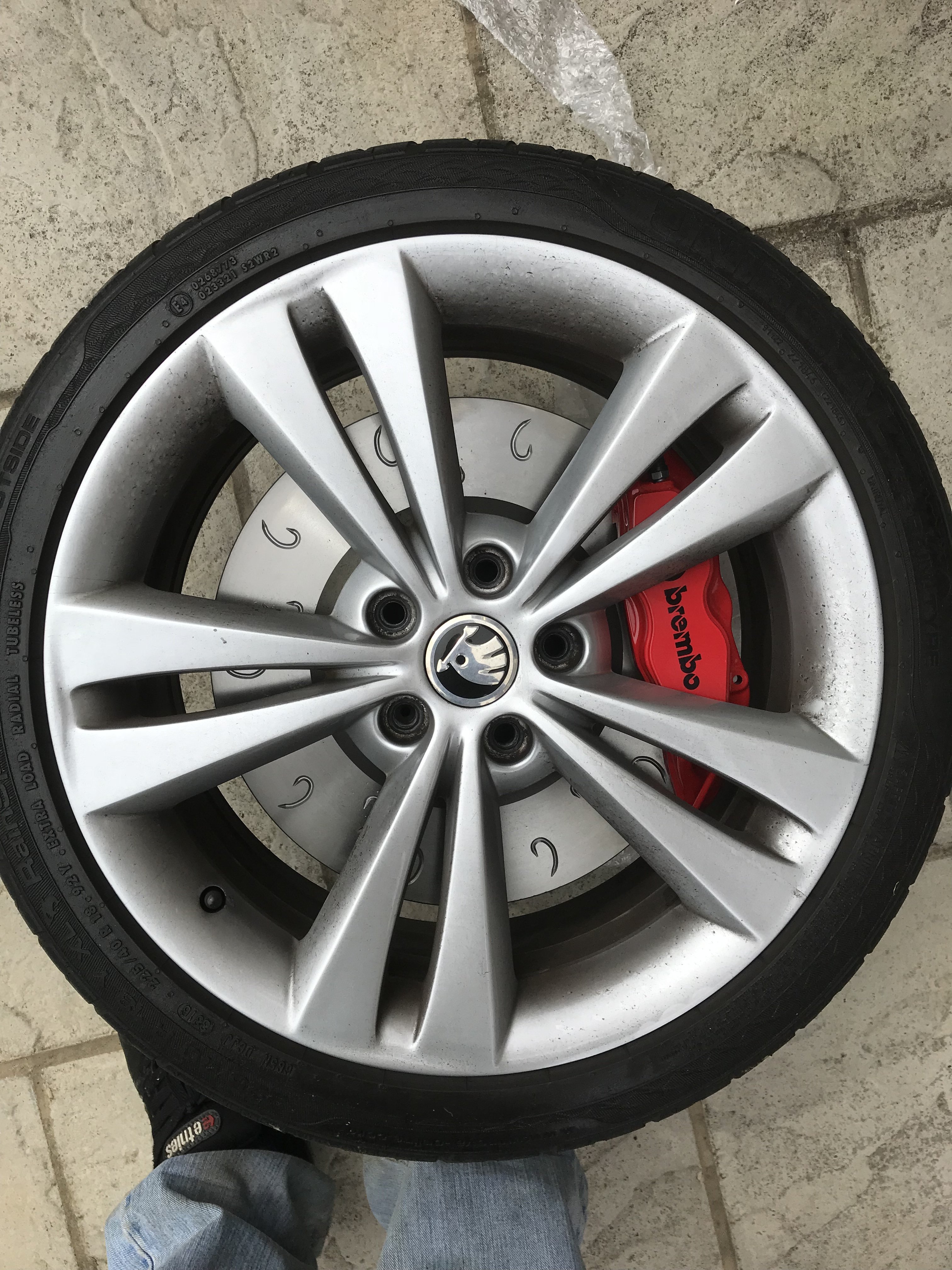

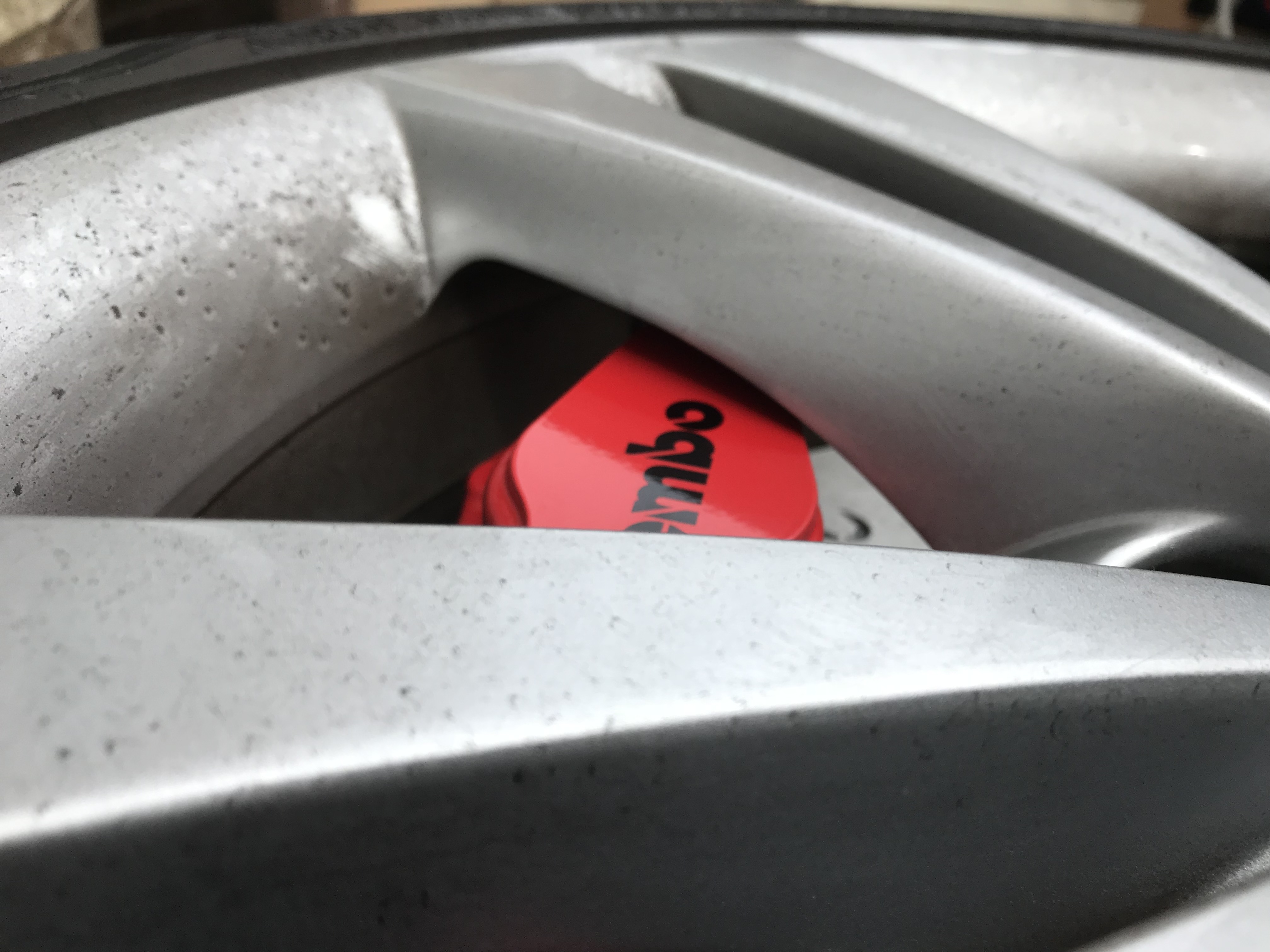

Mocked up the new brake install on a bucket today to double check wheel fitment.
Glad I did as it showed that even with 15mm spacers already fitted the wheel fouls the front of the caliper.
Bigger spacers needed. 20mm should do it just fine (checked this with the 15mm already fitted plus a 5mm universal spacer I had around)
With 15mm spacer
Edited by Quiksilver_TR

The 20mm spacer is too much. Wheels look to far out.
Already order up a 15mm one to swap.

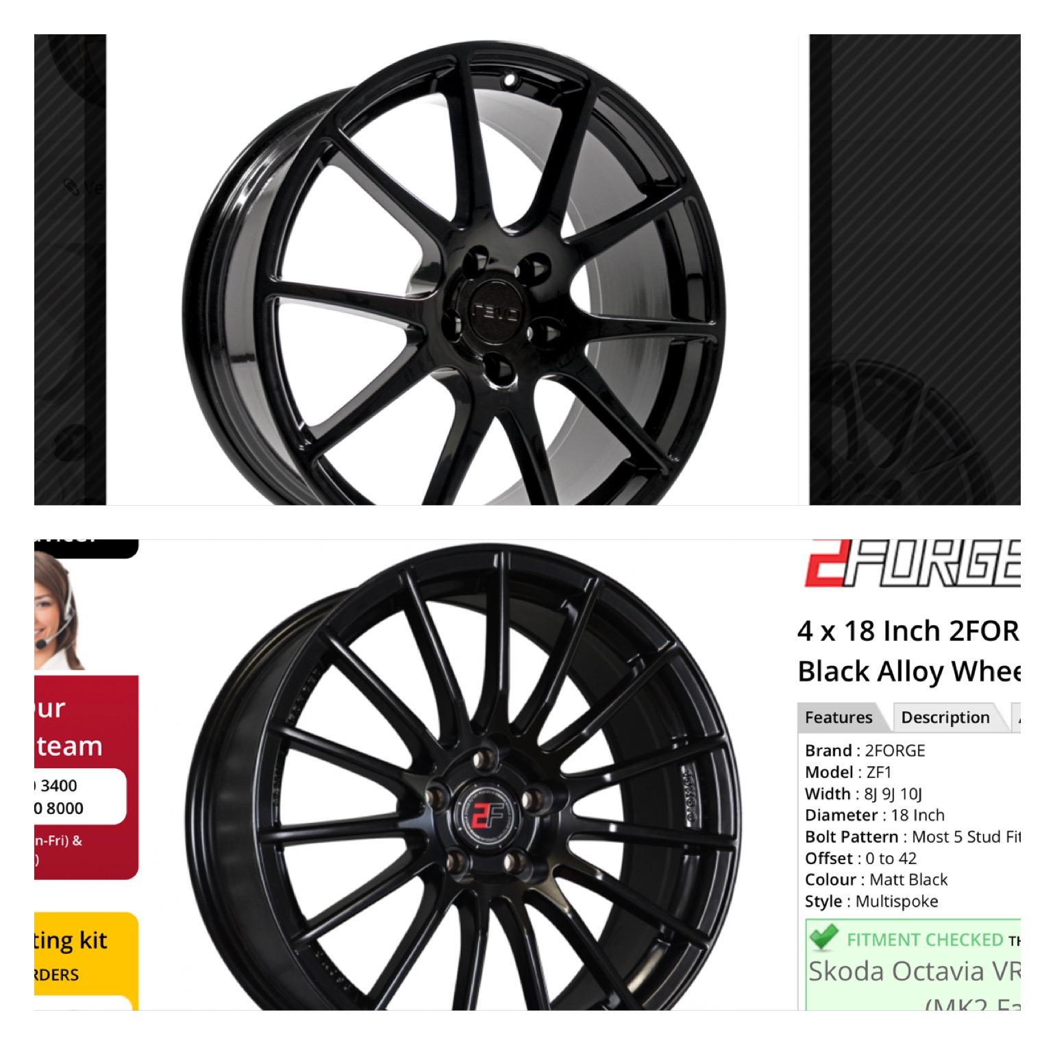

Thanks mate, less than 1000for Brembo 345mm is a good price. What’s the difference in braking , have you used them yet ? Also what do you think about 2forge alloys, gunmetal or black for white car?
Edited by vrsdx57
Alloys come with ET 42 which pushes them out by 16mm so it’s just perfect , no need for spacers.

I like the 2forge wheels (3rd ones pictured are my preference) and they would need to be gunmetal for me.
black can look like steels.
