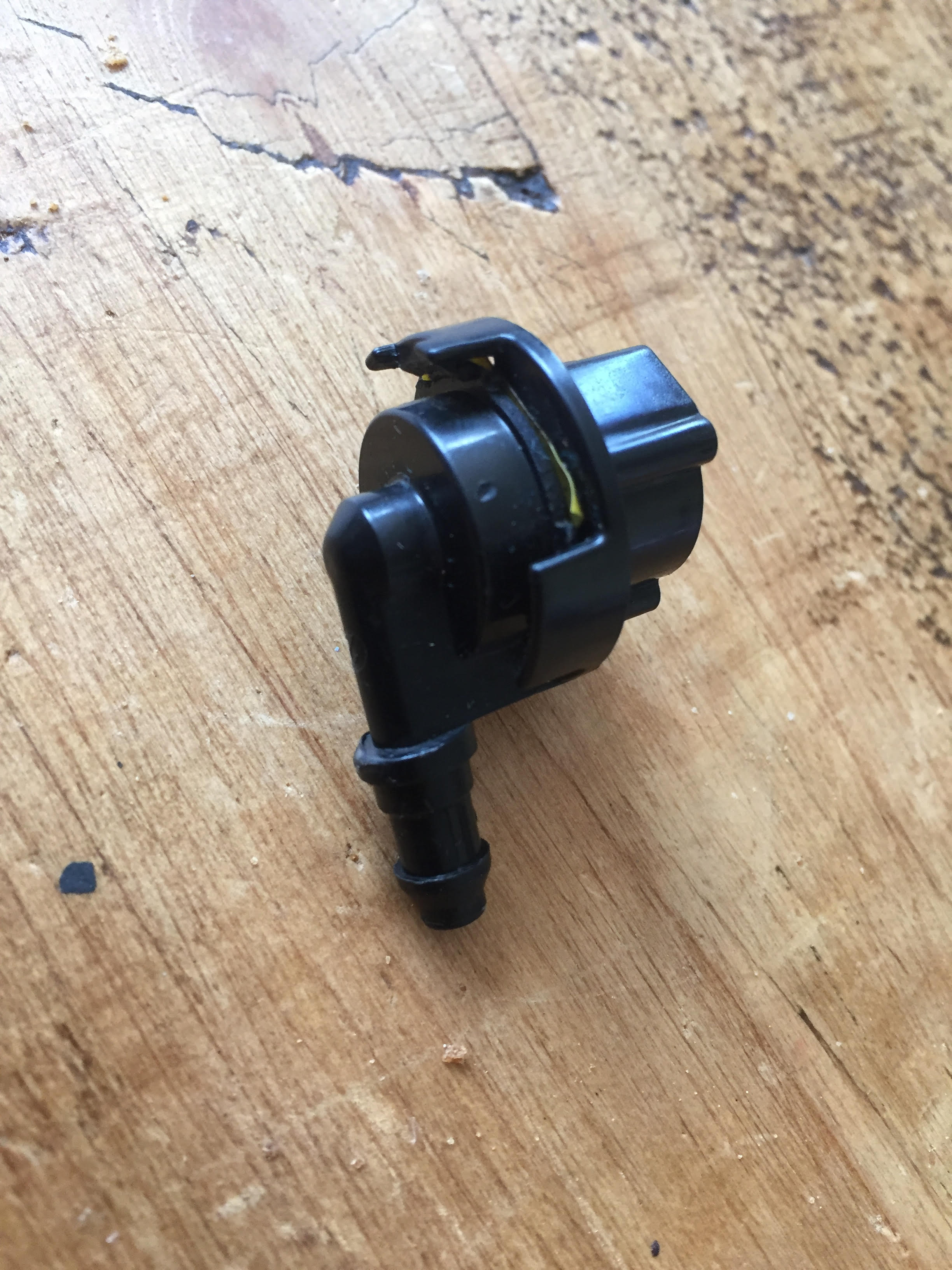

Does anyone know a part number/name for this bit that attaches the rear wiper motor and the washer hose? It rotates with the motor action. Mine is leaking and the garage claims i need a whole new motor...
Hi does this part just pull out?

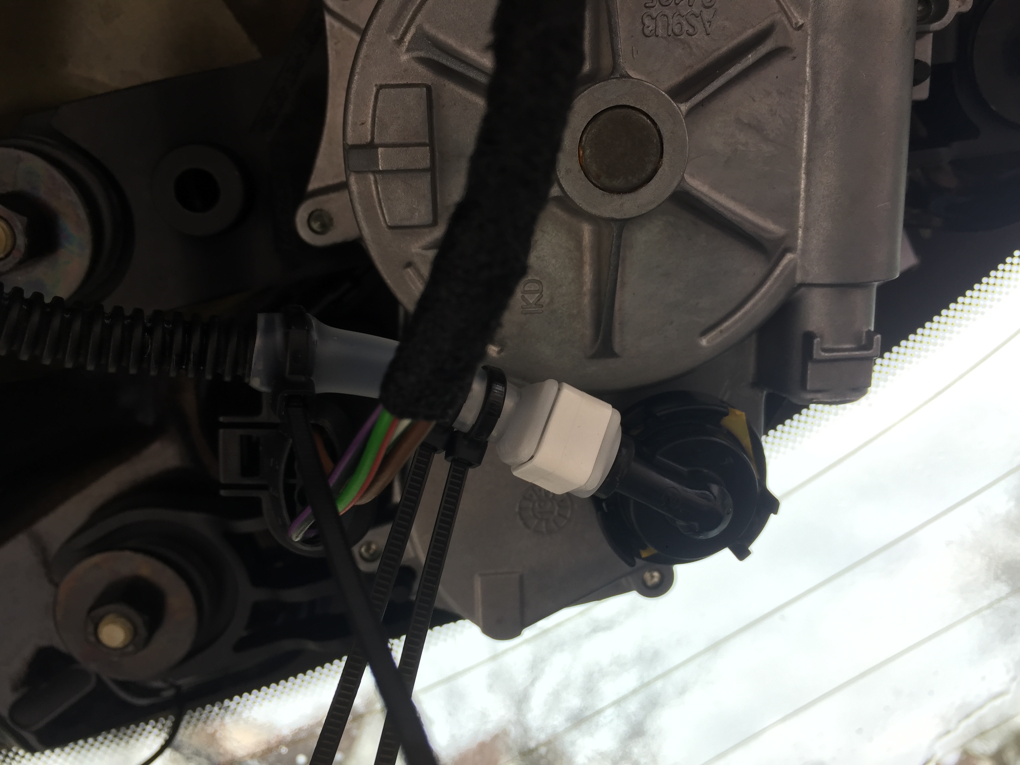

This is how it attaches to the washer motor, it just pulls off.

Cheers Josh is the black interior easy enough to remove from the boot I need to gain access to change the motor unit
cheers
Neil
this is a rapid and the panel is just a small bit that comes off easy, dont have to remove the entire boot cover.
