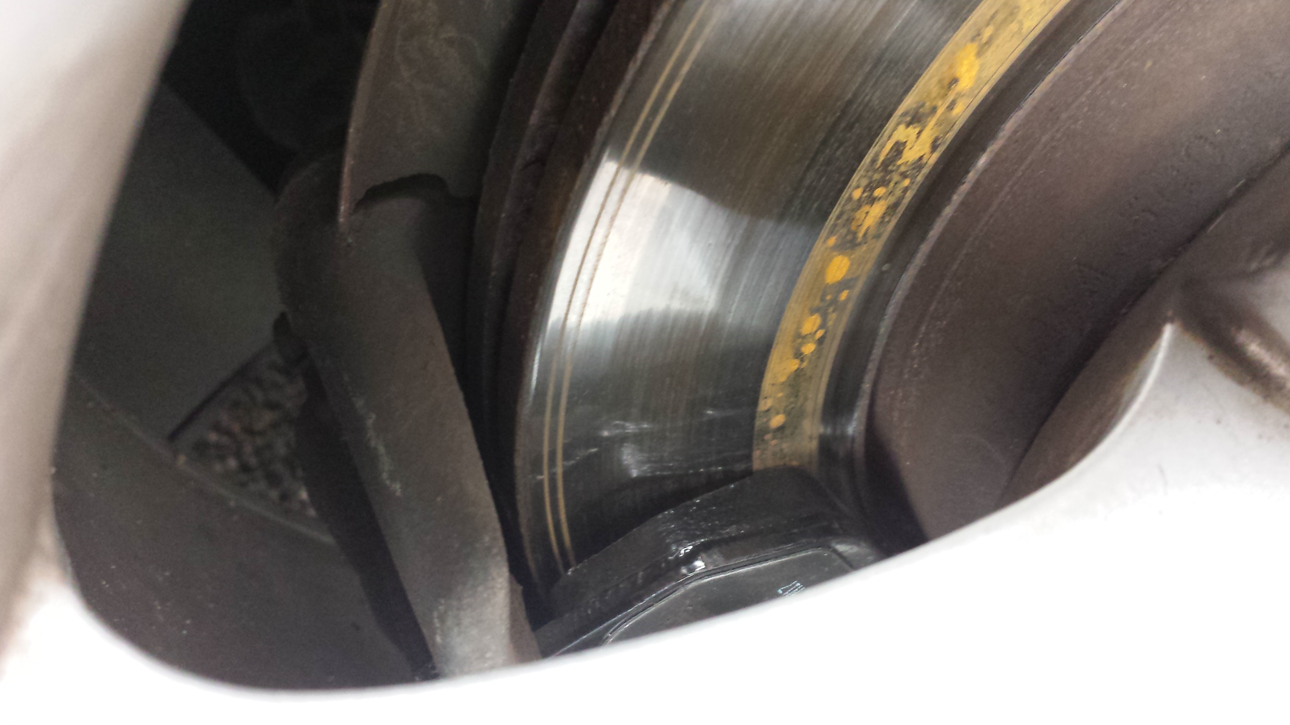

Just to add a bit more to this having had another look:  on looking at the front discs, there is a thin rust circle on the inside of the front discs (close in to the centre, corresponding to the inner edge of the brake pad - see photo).  It looks like the pad is too thick and thus rubbing on the disc - not sure how this would cause an intermittent noise unless the disc is warped?
The original pads that I removed were Ferodo VW4454 - thickness: 17.4mm, length: 146mm and width 57mm.   The Pagid ones that are now fitted are T2438 - thickness: 17.2, length: 146.25 and height: 62.3mm.  Is the fact that the Pagid ones are wider the cause of the problem?
The pad looks like it is sitting at an angle and not mounted in anything- it just looks wrong in that photograph.:dry:
Pads are meant to rub on the discs.:wondering:
Edited by gregoir
Gregoir: you're right, looking at that. Thanks.
They were parallel to the disc when I fitted them - I wonder what has happened.  I'll be taking them off tomorrow.
I took the pads off - they were mounted correctly but the photo doesn't show that the pad face was in contact with the disc and it is the wear indicator/shoulder that makes it look weird.  However the pad is too thick, hence rubbing on the disc,  as well as too wide and rubbing on the hub.
I have put the old pads back on - they still have a fair bit of wear left - whilst I source the correct size (anyone know? I will put this as a separate thread).
