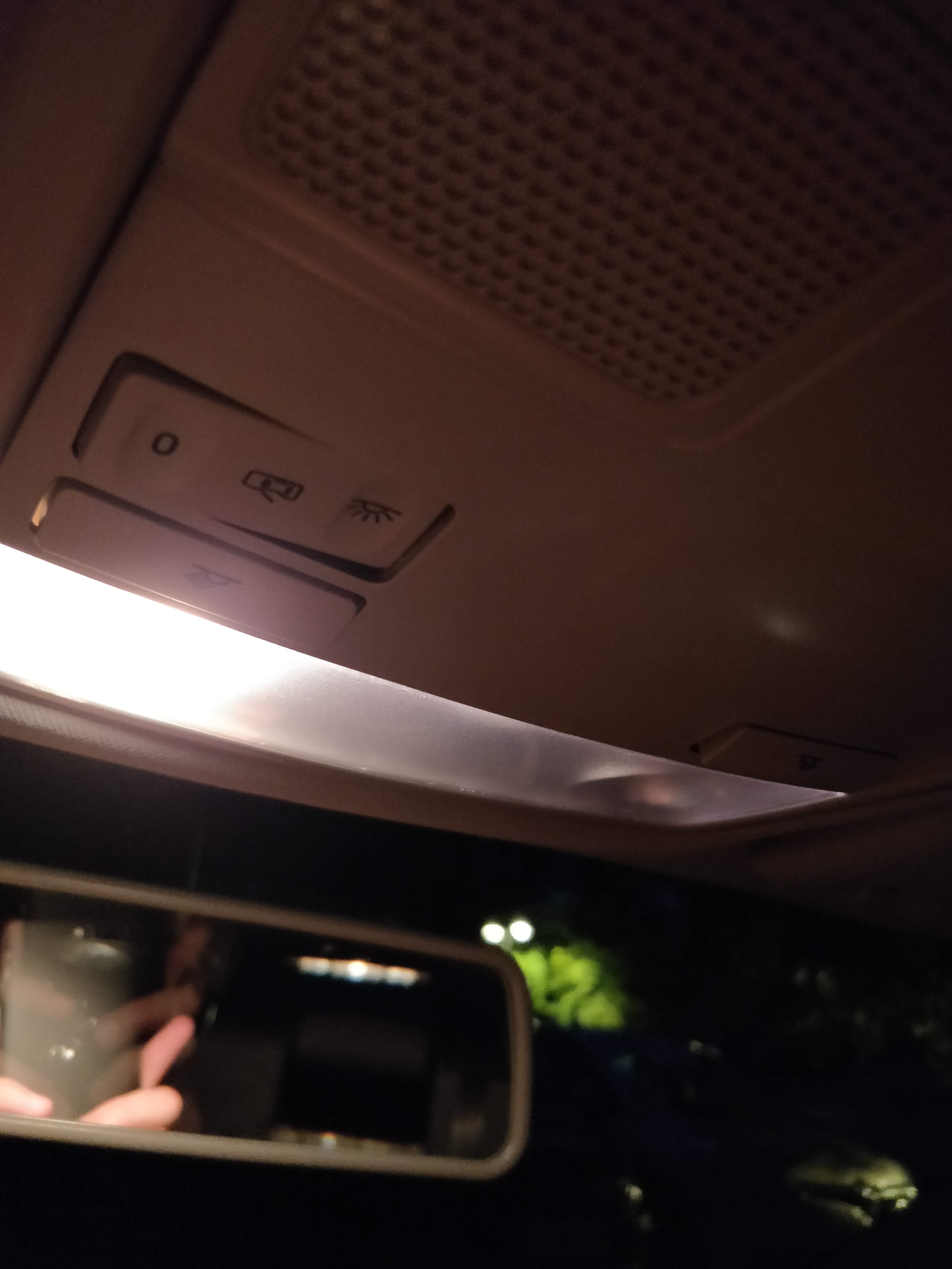

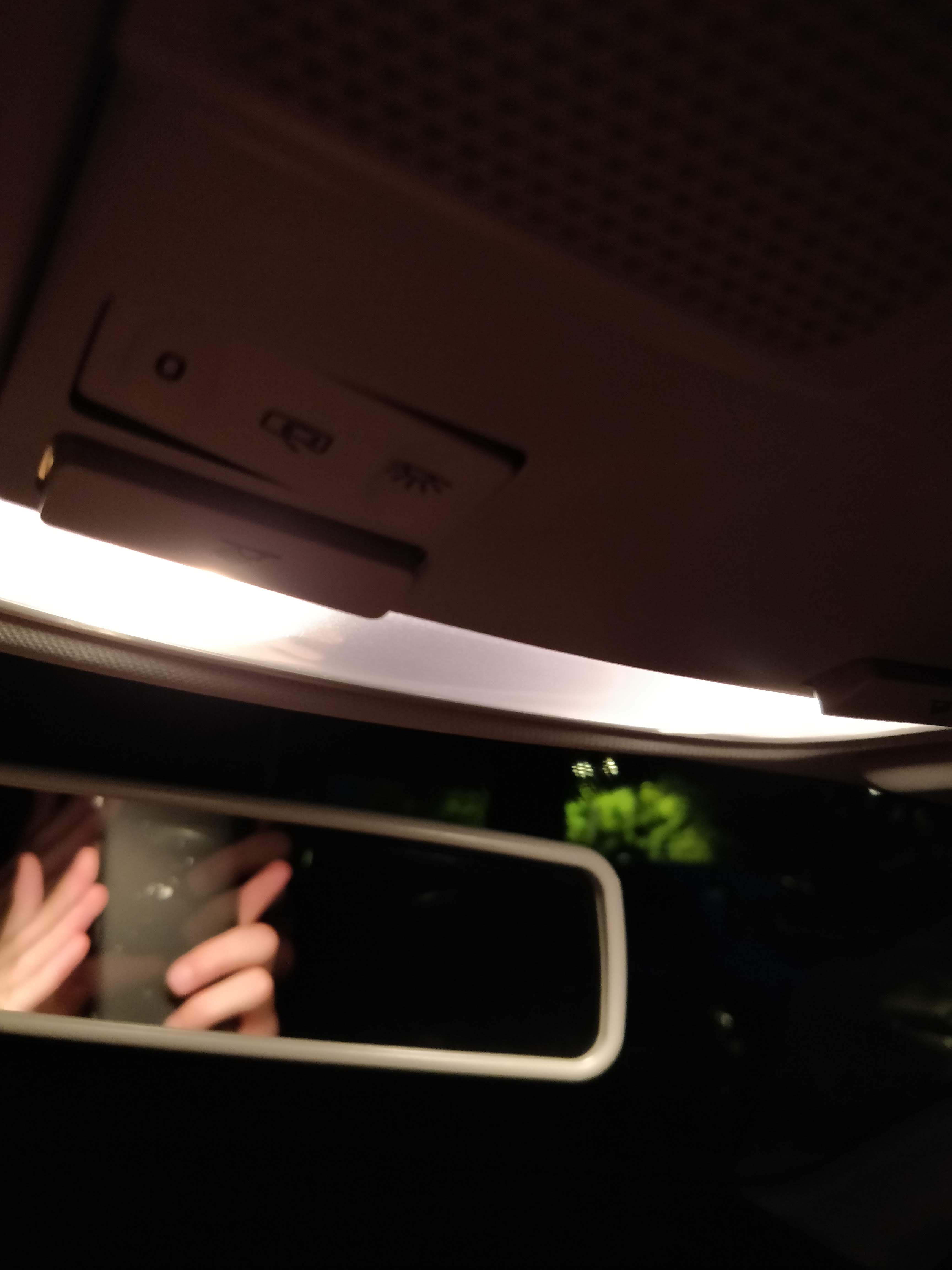

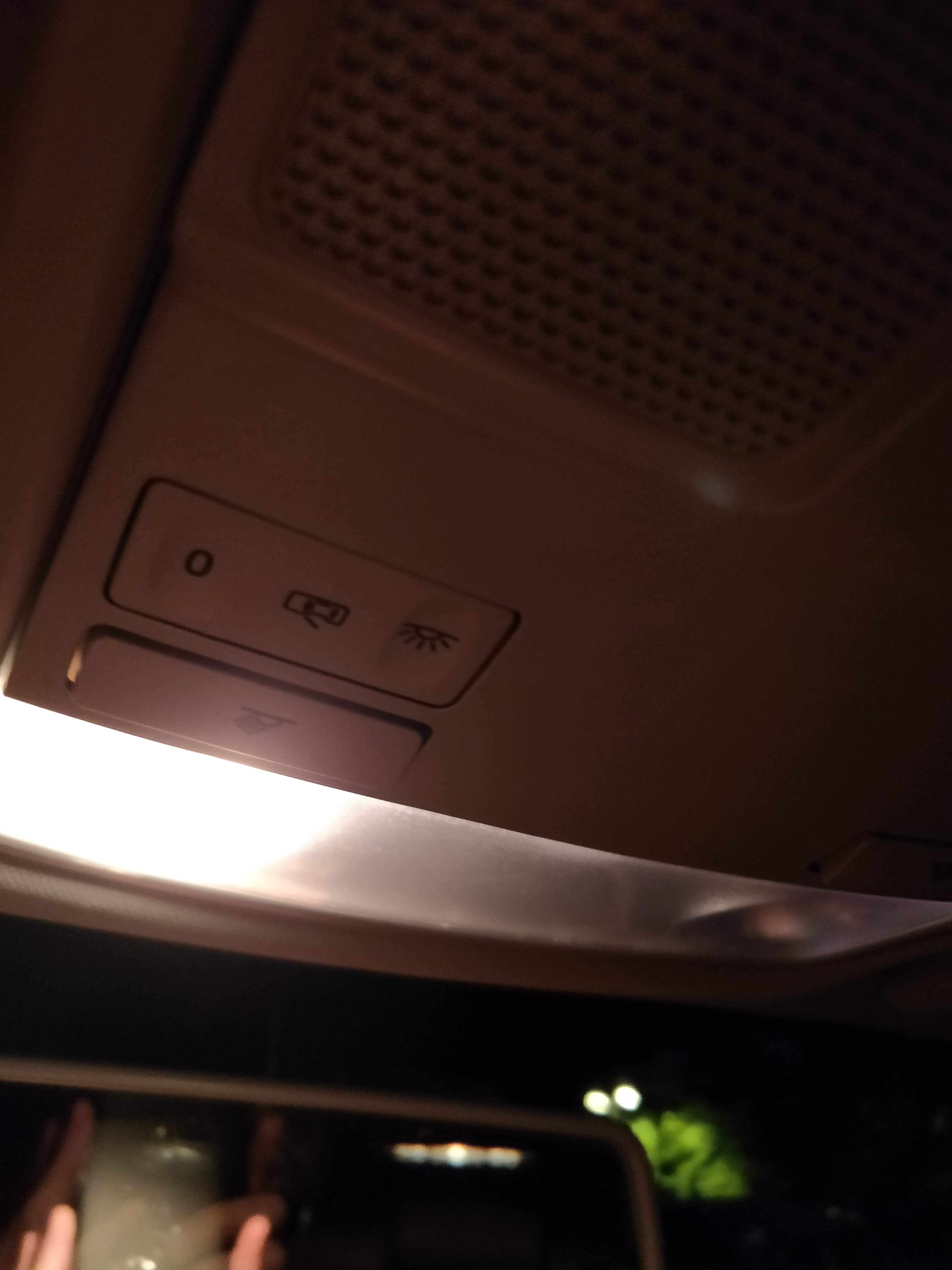

interesting. i have everything set the exact same way but only the left one lights up (see photos). If I turn them on with their switch it lights up normally, just not when the doors are open or if the switch is set to turn them both on. I guess the only thing wrong here would be the master(off, door, on) switch.
