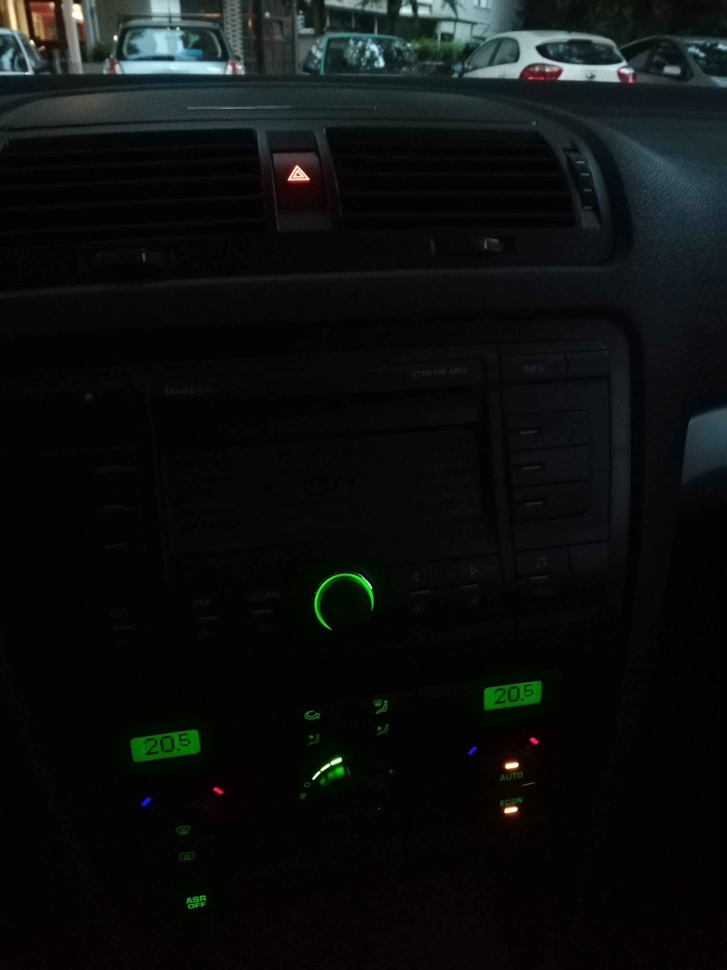

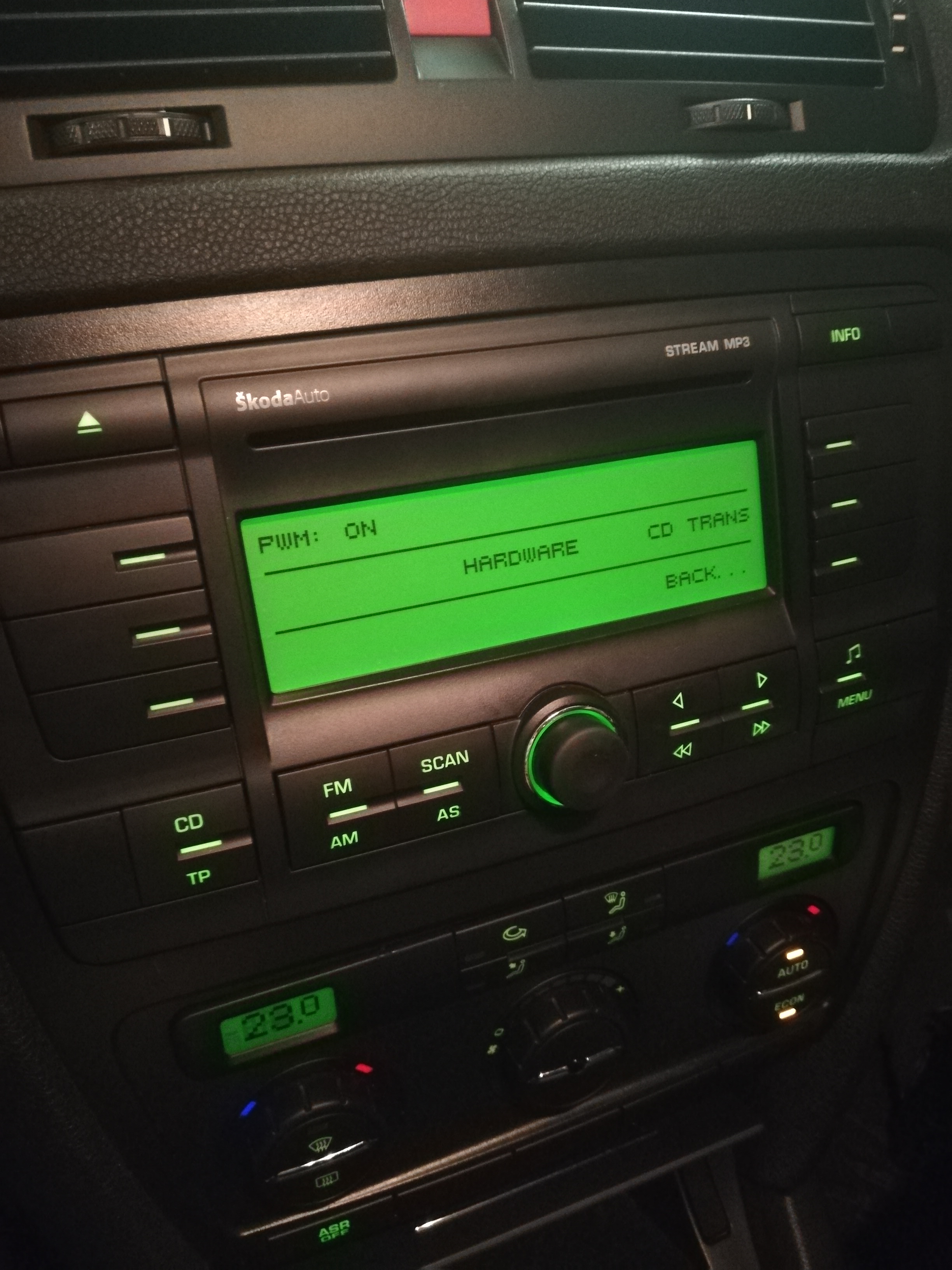

Hello, most probably because of my playing in vcds, light on a radio does not turn on. Before,when i moved a switch to turn on the lights, lights turned on also on a radio, but now not anymore. Awfull felling when driving at night. When i enter into hidden menu there is an option PWM: on/off. If i change to on, light turns on a radio, but immedialty after i exit from hidden menu lights turns off. I definetelly think that actions are required in vcds, but dont know where. Any ideas?
First picture,radio is ON.
Second picture, with pwm on light is on, after leaving this menu light is turned off.
