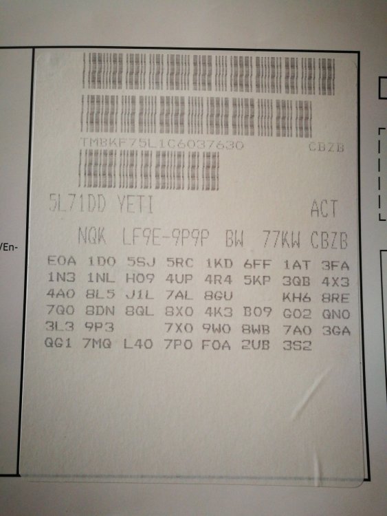

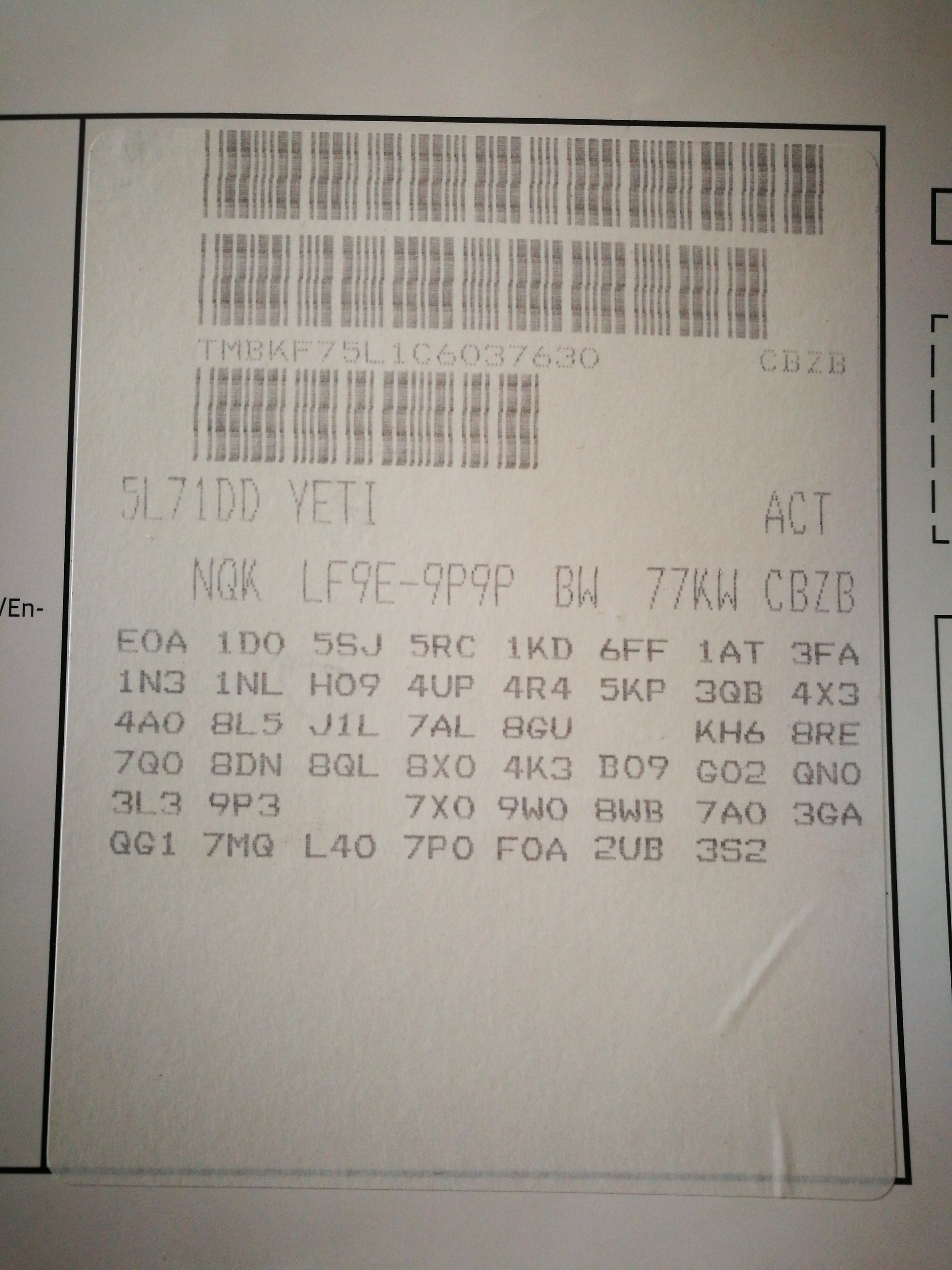

Just needing some clarification. I have a wheel bearing issue and need to find out:
Which bearing should I look for the front...3 bolt or 4 bolt.
How do I find the pr number to confirm this? I have the service manual with a load of codes, but can't find what these mean in relation to the brake specification etc.
Thanks
That shows some of the codes of what is an 8 page list that you could get from ERWIN or your dealer.
20 1T0 498 621 wheel bearing with assembly parts 4 holes 2 PR-1ZA,1ZE,
1LJ
(20) 1K0 498 621 wheel bearing with assembly parts 3 holes 2 PR-1ZF
