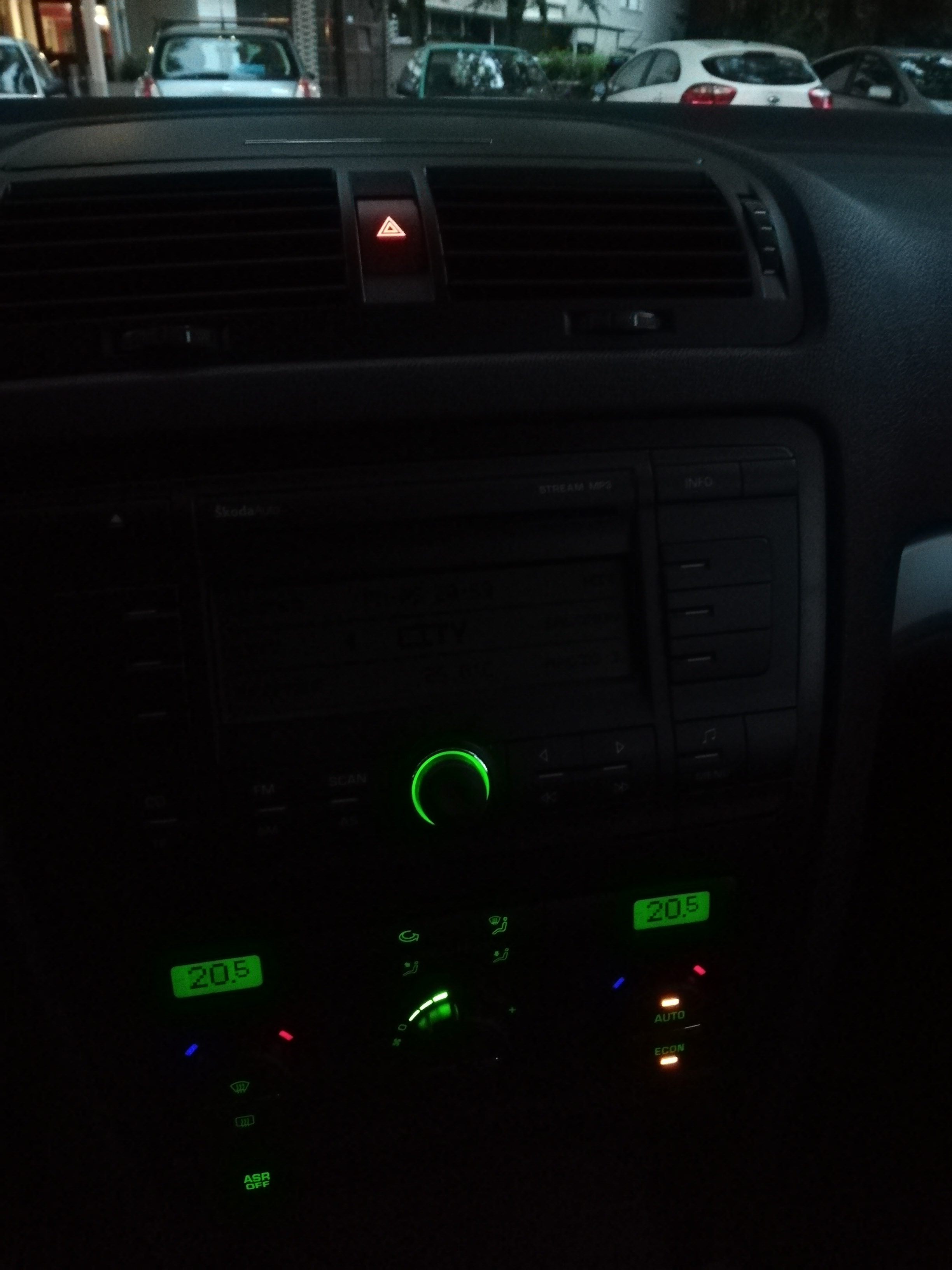

Hi. I have this error shown in vcds,and this causes that backlight is not turned ON on a radio when light switch is turned ON. During the night, this causes froustration as i cannot see radio. After error is deleted, backlight on a radio is back again, until the next ignition start. Error is back again, and backlight is once again not working anymore. New battery just installed, no changes.
Octavia 2, 2008, radio stream mp3.
Any ideas?

Radio turned on:

Yes. Like i said, after error is deleted, radio backlight is working and Error is immediatly shown again. As soon as you start engine once again, backlight is off again. I have even tried to connect other stream radio to my car, and until radio code apeared, the screen was also without backlight. I didnt have a code, so i couldnt test in full
