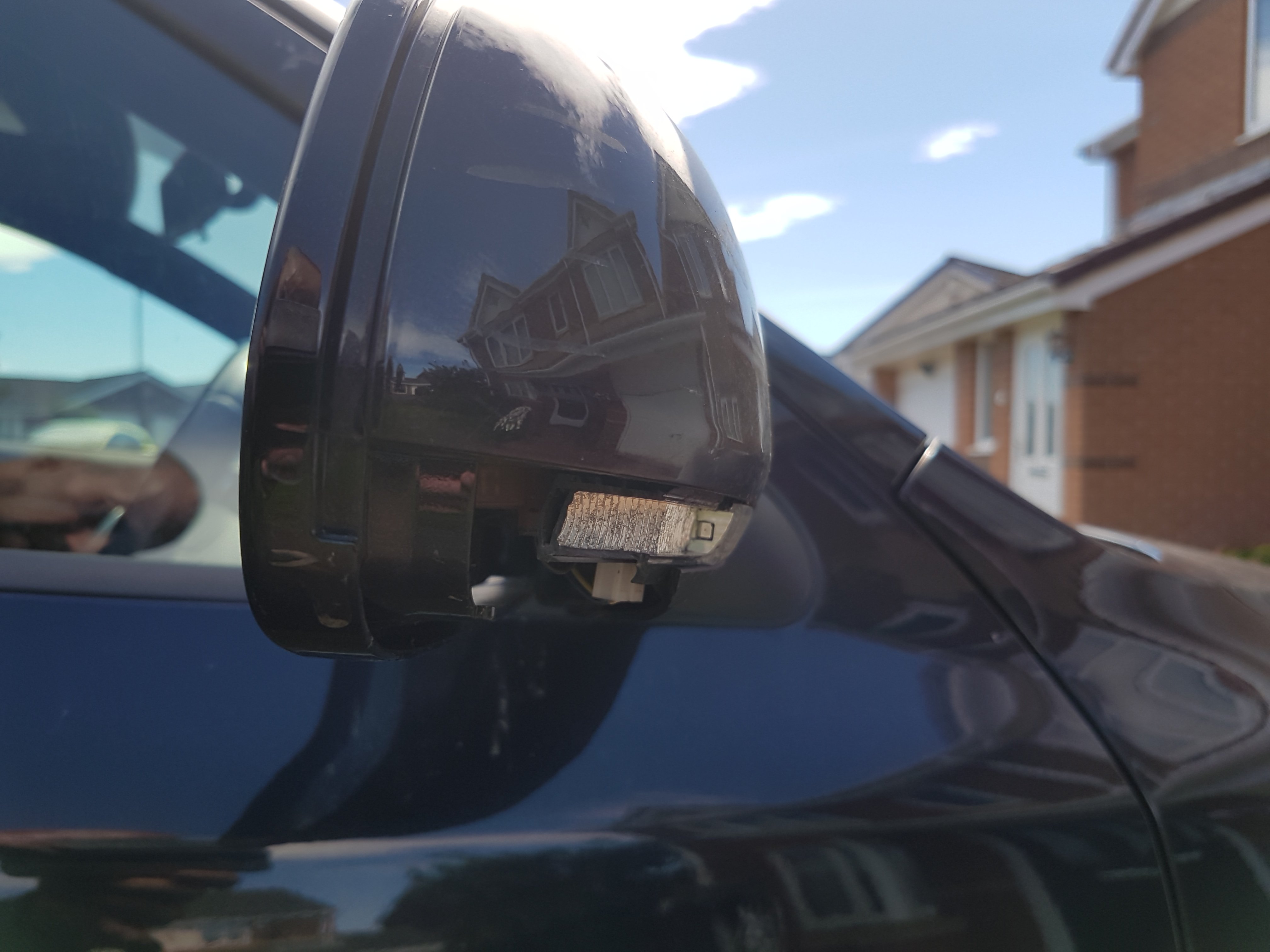

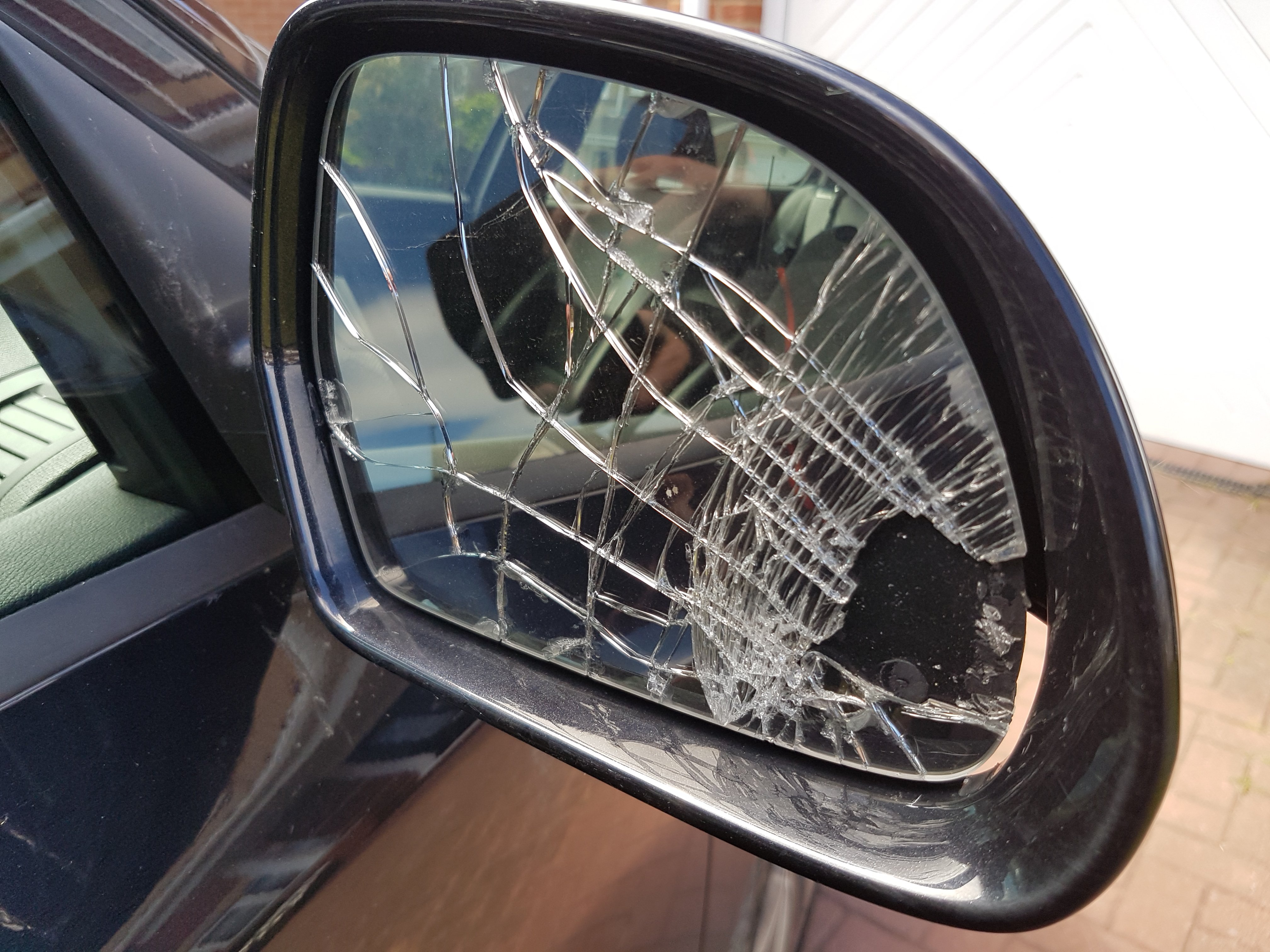

It's the mirror and the clear plastic part that covers the indicator, that are broken. Can I buy these bits separately or is it the whole thing?

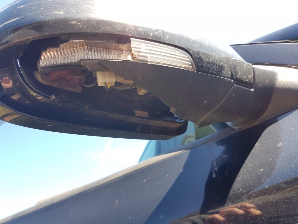

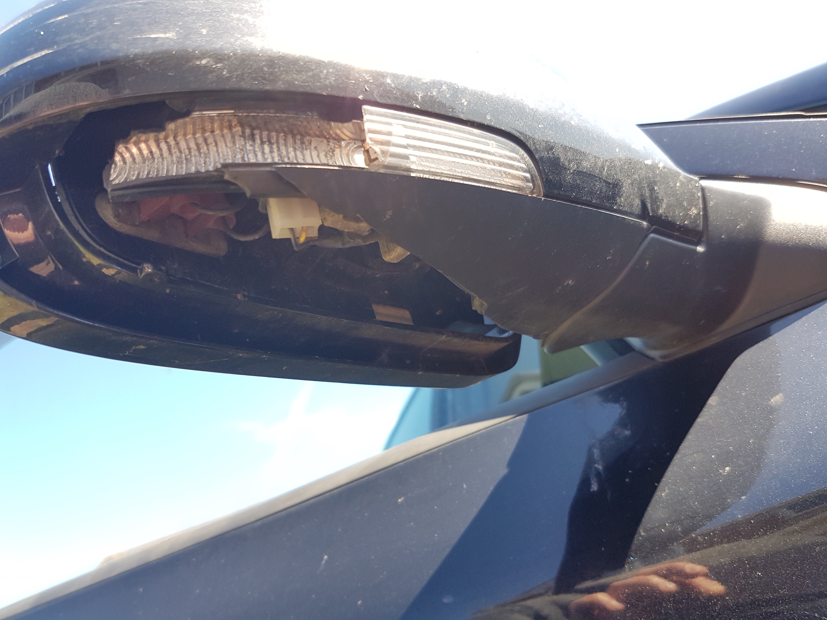

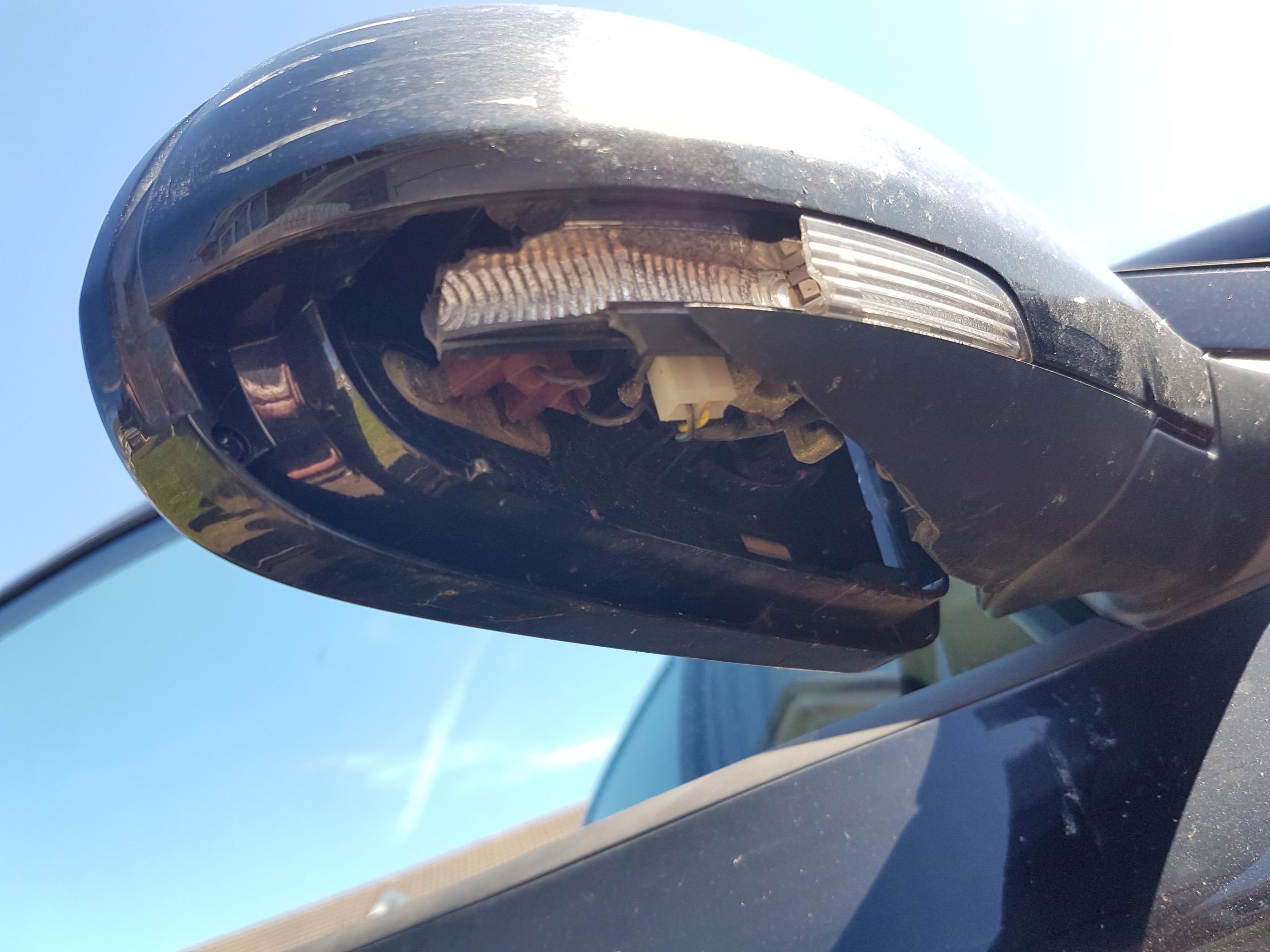

U have pics from under mirror aswell looks as if bottom cover broken?
I have some pics of mirror in bits if that helps you
Here’s a couple from below. I think I need the indicator part and the bottom cover.
I think I need the following part numbers, 3T0949102 and 3t0857604.
