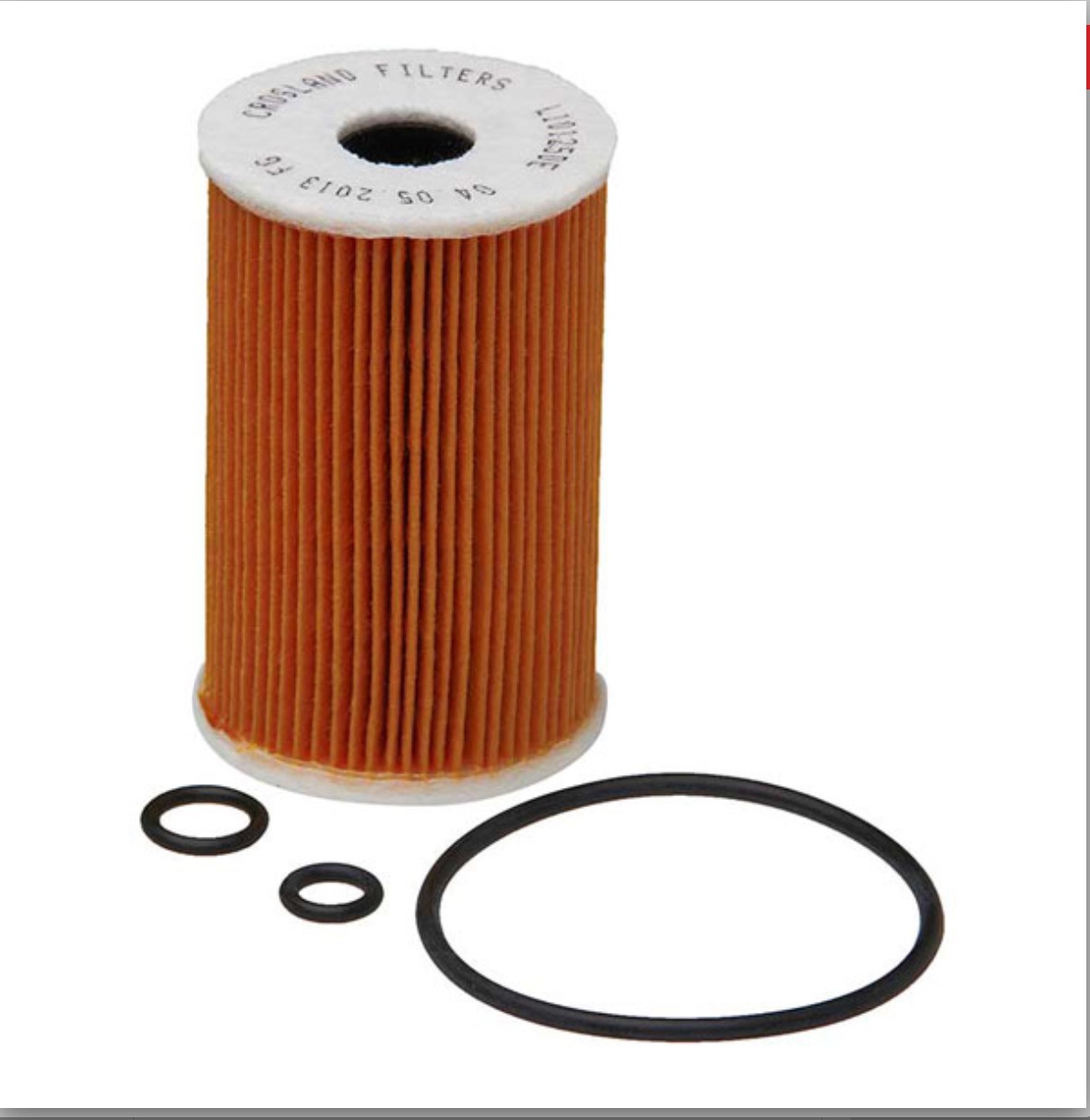

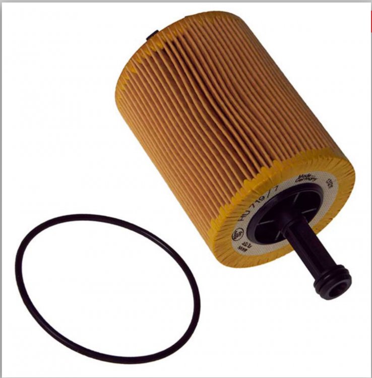

Do you know your engine code as the fitment guide on the likes of ECP will tell you which fits which .... The first photo with the "stick" is mines in the BKD engine ... The second is for the CFHC and CLCB engine codes
