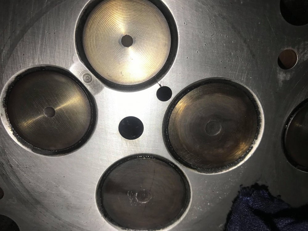

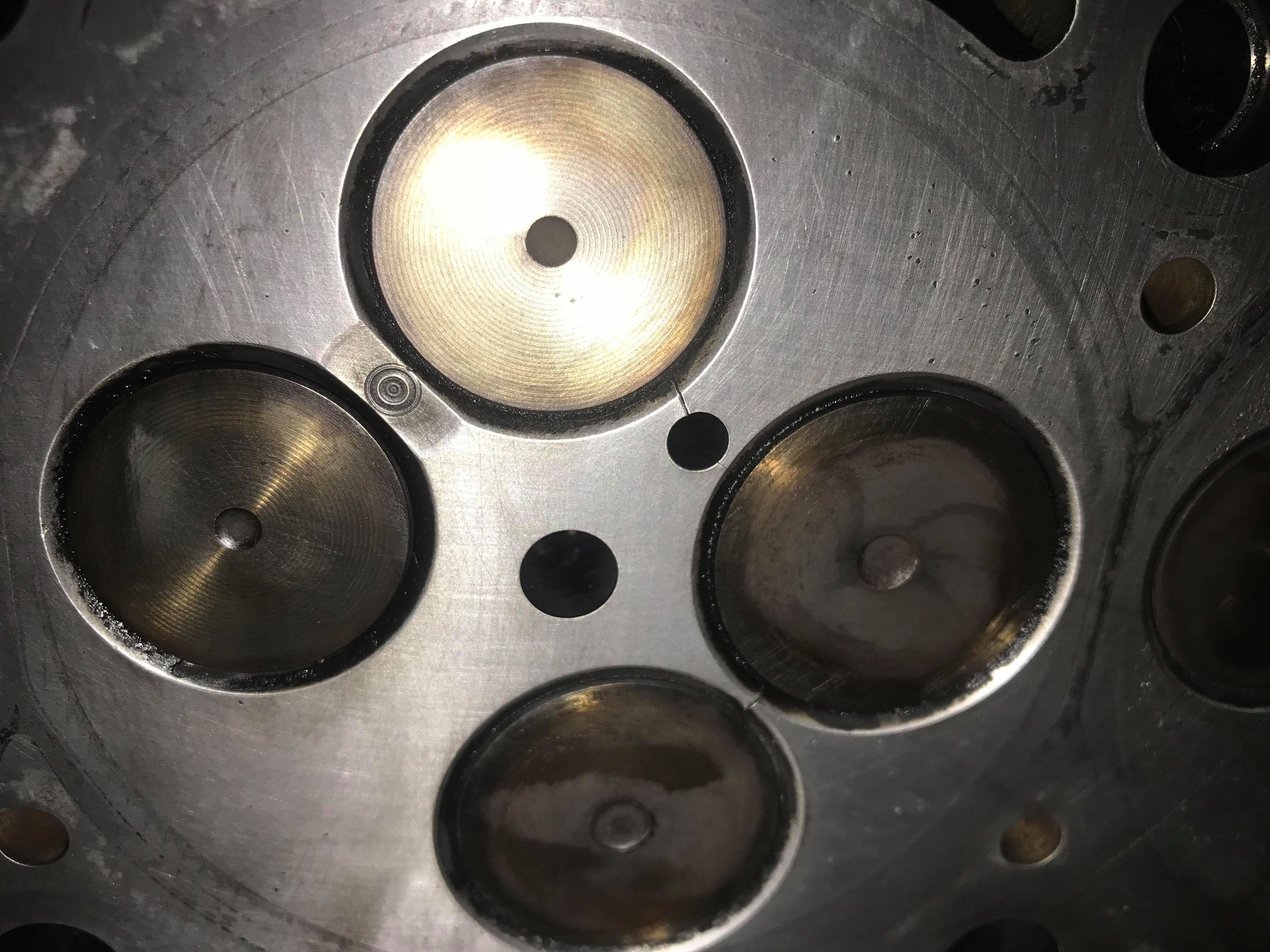

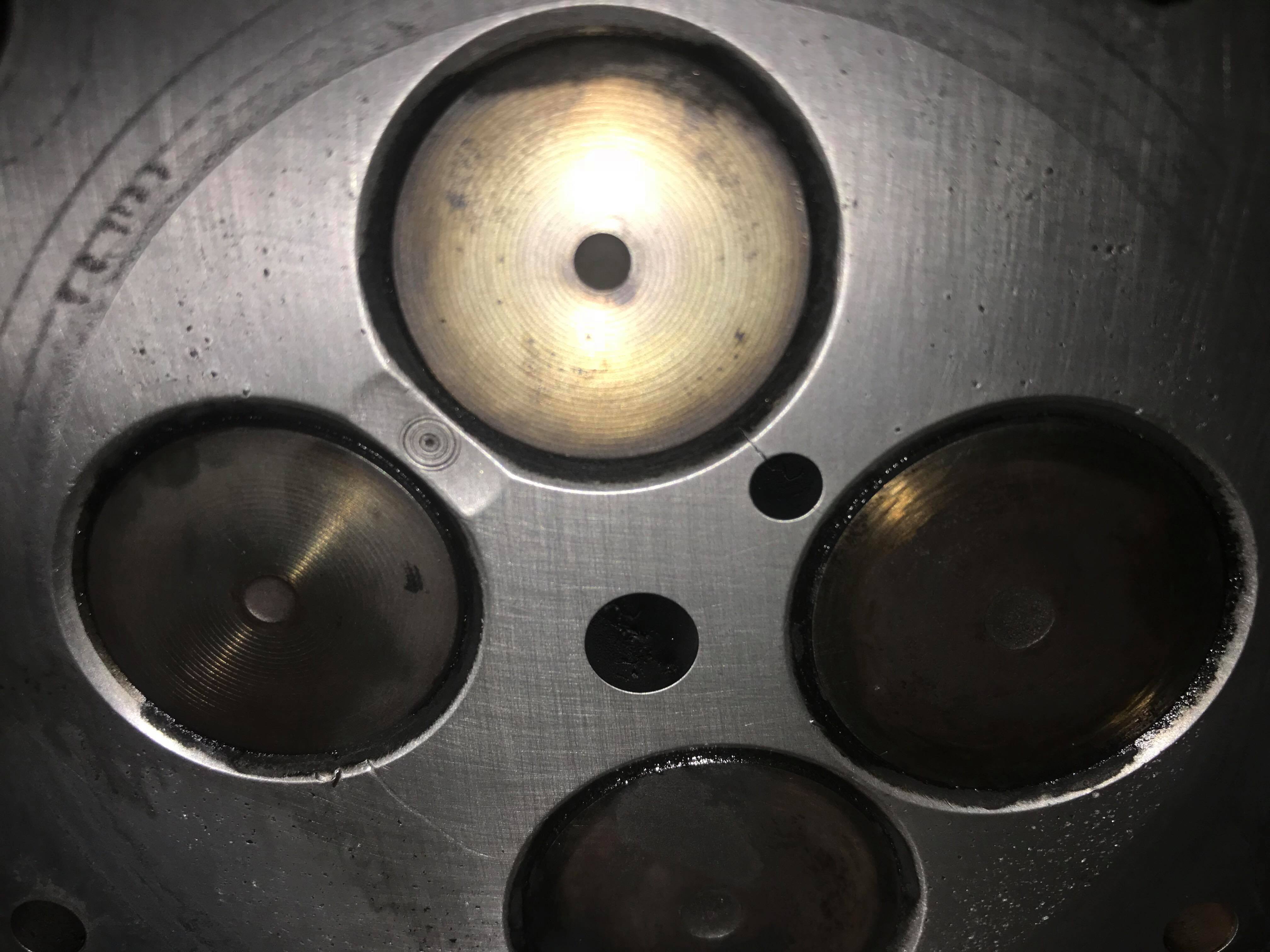

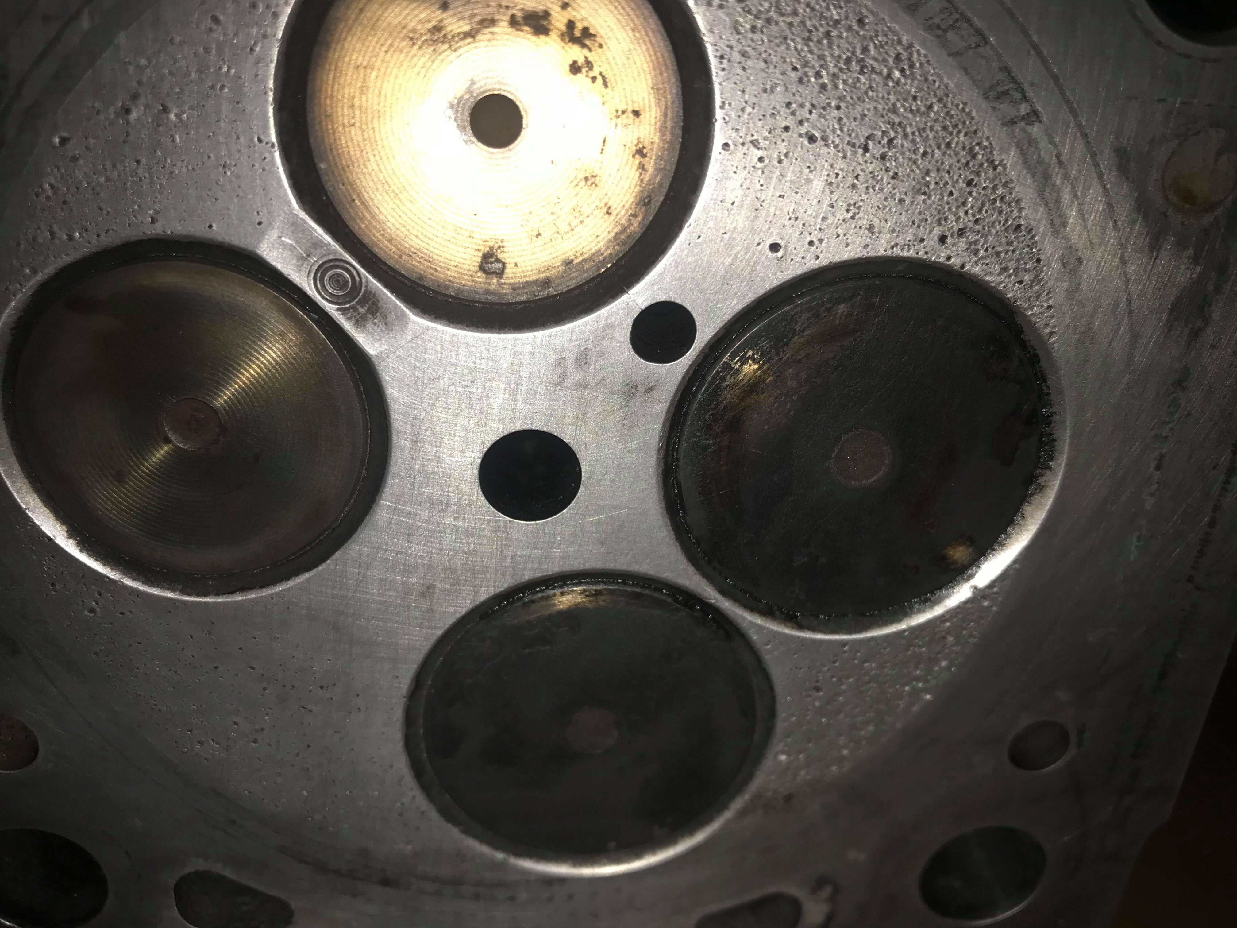

In the end i've decided to have a stab at fixing the turbo/engine, so i've stripped the engine down to see what the cause of the blue smoke is, it has been burning oil chronic so I think the turbo failures are due to starvation.
So I was just wondering if anyone has had any issues with the cylinder head cracking between the valves? I think this may be the reason for the loss of oil, I'm replacing the rings, and bottom end. But just wondered peoples thoughts on whether its deffo scrap and the only alternative is a new head?
Cheers in advance
wilest thinking it's scrapp  I would get a second opinion  IF you have a reputable engine machining outfit near you     the only thing you may be wasting is some time asking
