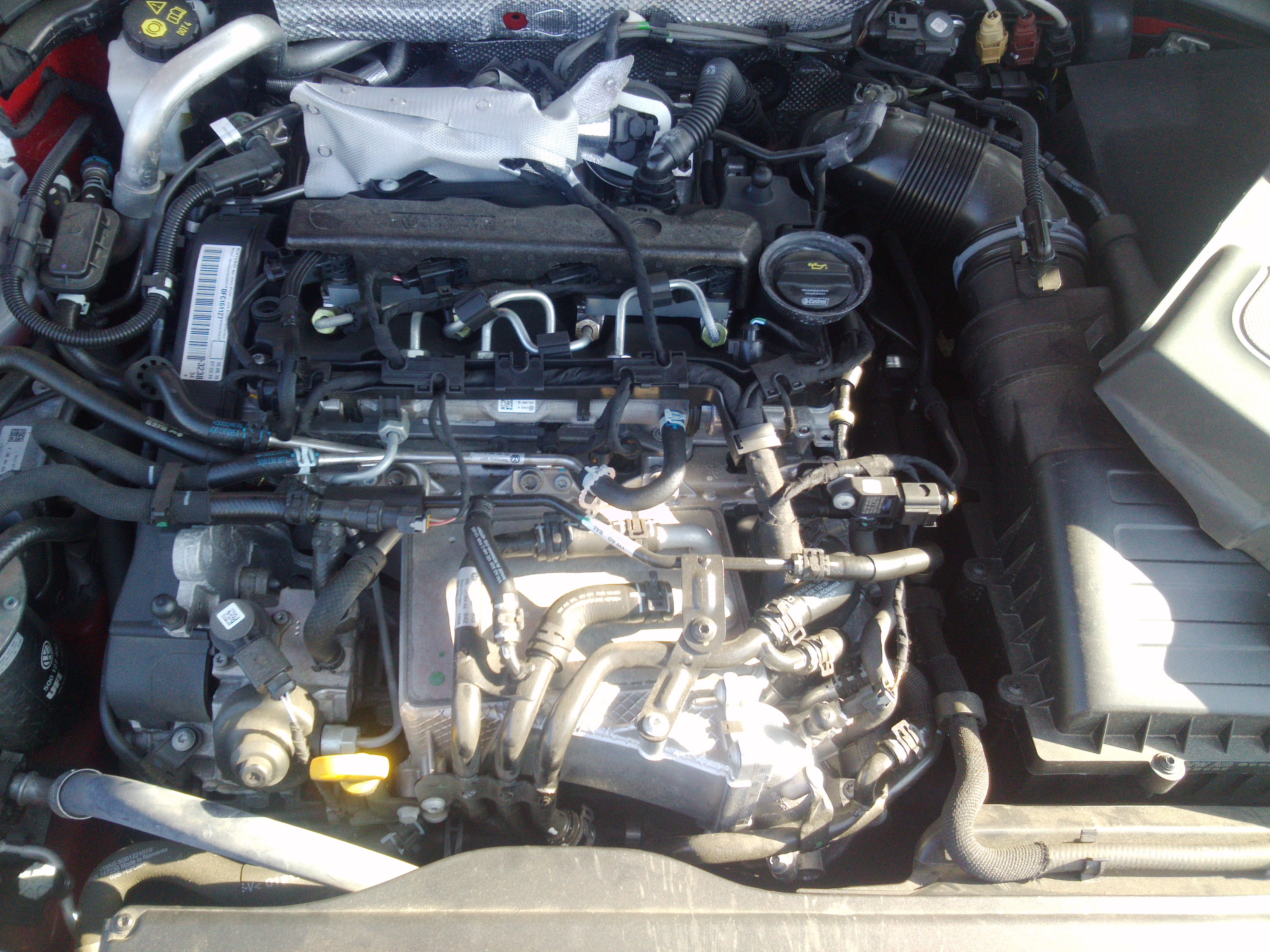

I have a 2016 Skoda Superb 2.0 190hp Diesel now due for oil and filter change. If I could find where!!! the oil filter is hidden I can begin with job, anyone done this job and have pics?
This is view of engine
Iirc underneath or underneath at the front. I don’t think you can get to it from the top.

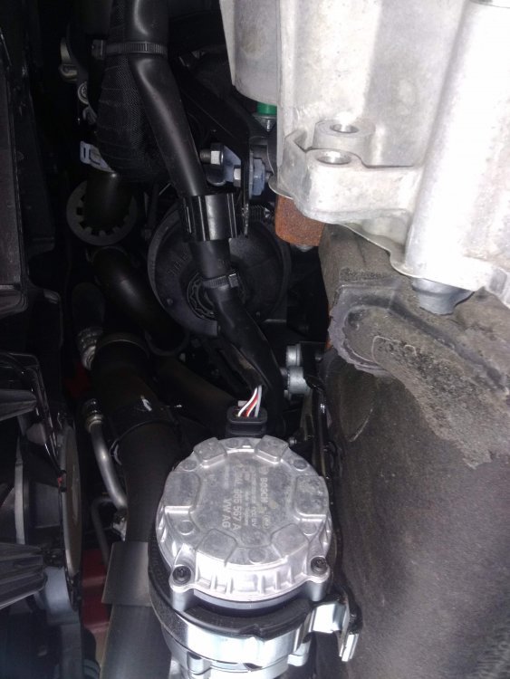

Yes you are correct, after removing the undertray oil filter is accessible from underneath. There is a bit of wiring and pipe need moving out of way to remove oil filter.
So you have to get underneath (not unreasonable assumption), however who on earth thought it was a good idea to run pipes and wires in the way.

4: Underneath Oil filer there is some wiring in the way, best to cut 2 cable ties to allow wiring to be moved clear, and disconnect push in loom clip. There is what looks like some electrical water pump underneath oil filter, disconnect electrical plug on top by pulling grey tab backwards, press on grey tab and multiplug will come off. Pull wiring as clear of filter as possible.
5: At bottom of oil filer there is a plastic drain nut undo this with 13mm socket and long extension. Remove drain plug, oil will now drain out of filter housing, (either small funnell to direct oil draining out into drain container or old rag wrapped around water pump and electrical connections would be good idea as this is messy part of job). Refit drain nut with new seal (should be with new oil filer).
6: To remove oil filter housing you need a 32mm socket. Once removed old oil filter pulls out of housing, clean housing with cloth, fit new rubber seal and new oil filter, refit oil filter housing, don't over tighten 32 nut.
