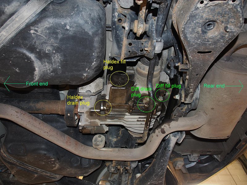

Good morning all, I've been reading on here for a few weeks but need some advice. I have a 2007 4x4 and I understand the Haldex requires frequent oil changes, but I'm struggling to find a diagram with the drain/fill bolt locations, I don't want to fill the diff with Haldex oil! Would I be correct in thinking that a Gen2 Haldex is fitted to a 2007 car? I understand that the FL cars had a Gen4, what year was the FL?

2007 is Gen2. Filling is the same on both, just the filter on the other side thats different.

8 minutes ago, Longship said:
Is this any help;
https://www.elektroda.pl/rtvforum/topic3398295.html
Copy link into address bar.
Scroll down to see a labelled pic.
Thanks, yes it clearly shows the correct bolts to fill/drain. Just need to find more information about filter replacement as my local dealer doesn't think there is one.
