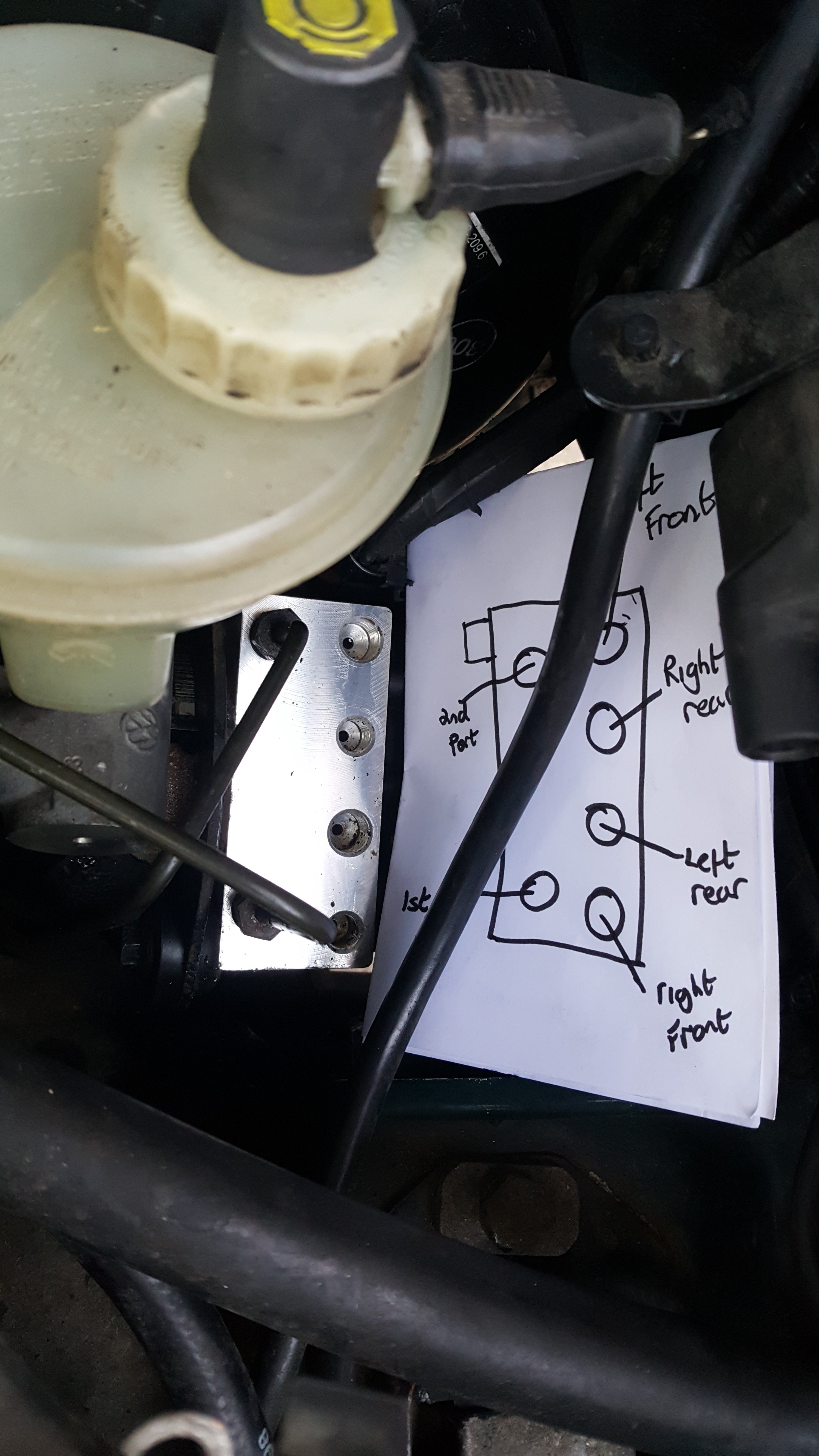

I just fitted ABS upgrade to my 16v running the 256mm vented fronts and rear disk... here's a pic off how they go... copied the doner car before removal

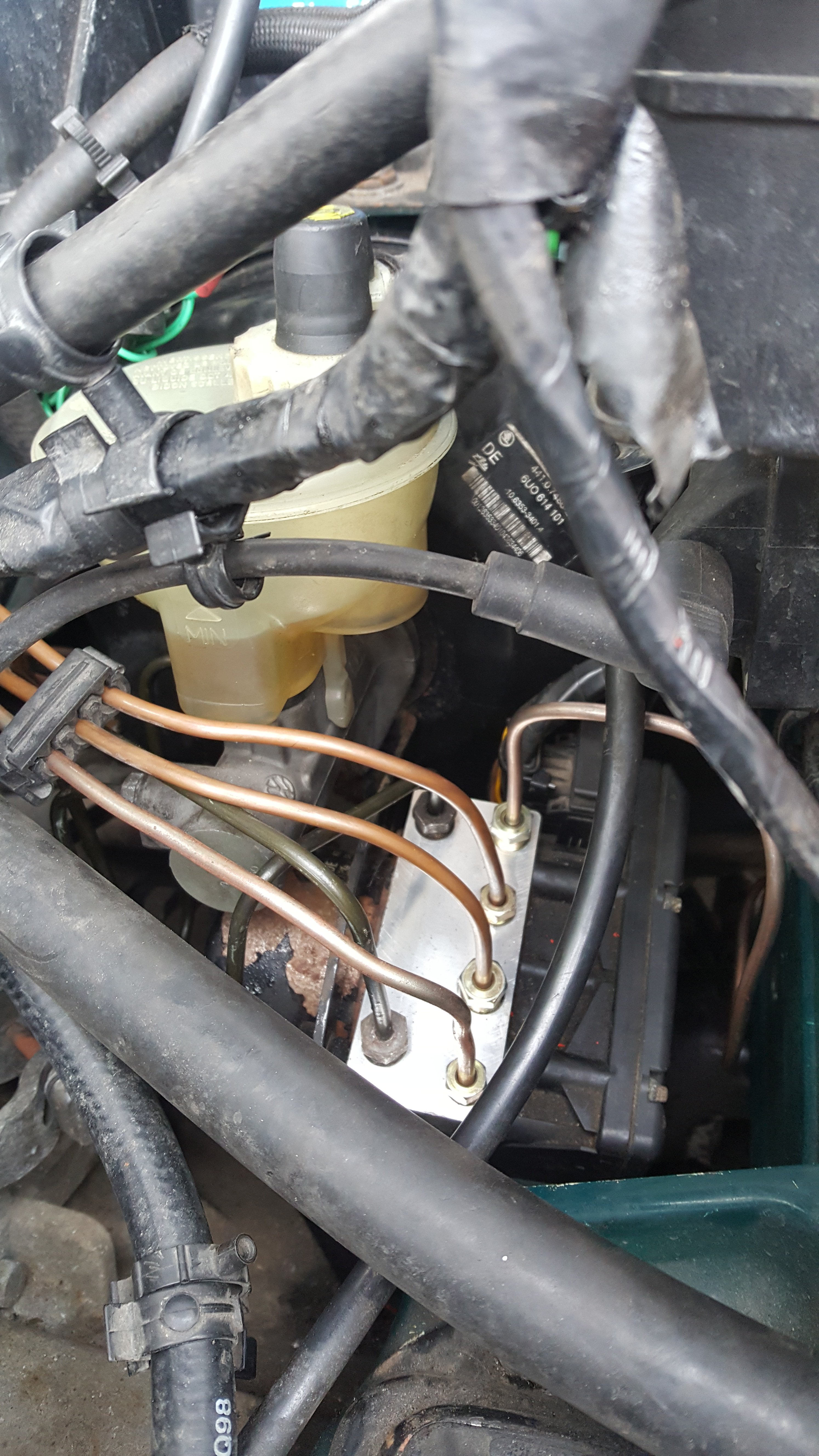

How they ended up looking after a full repipe off the brake lines...
