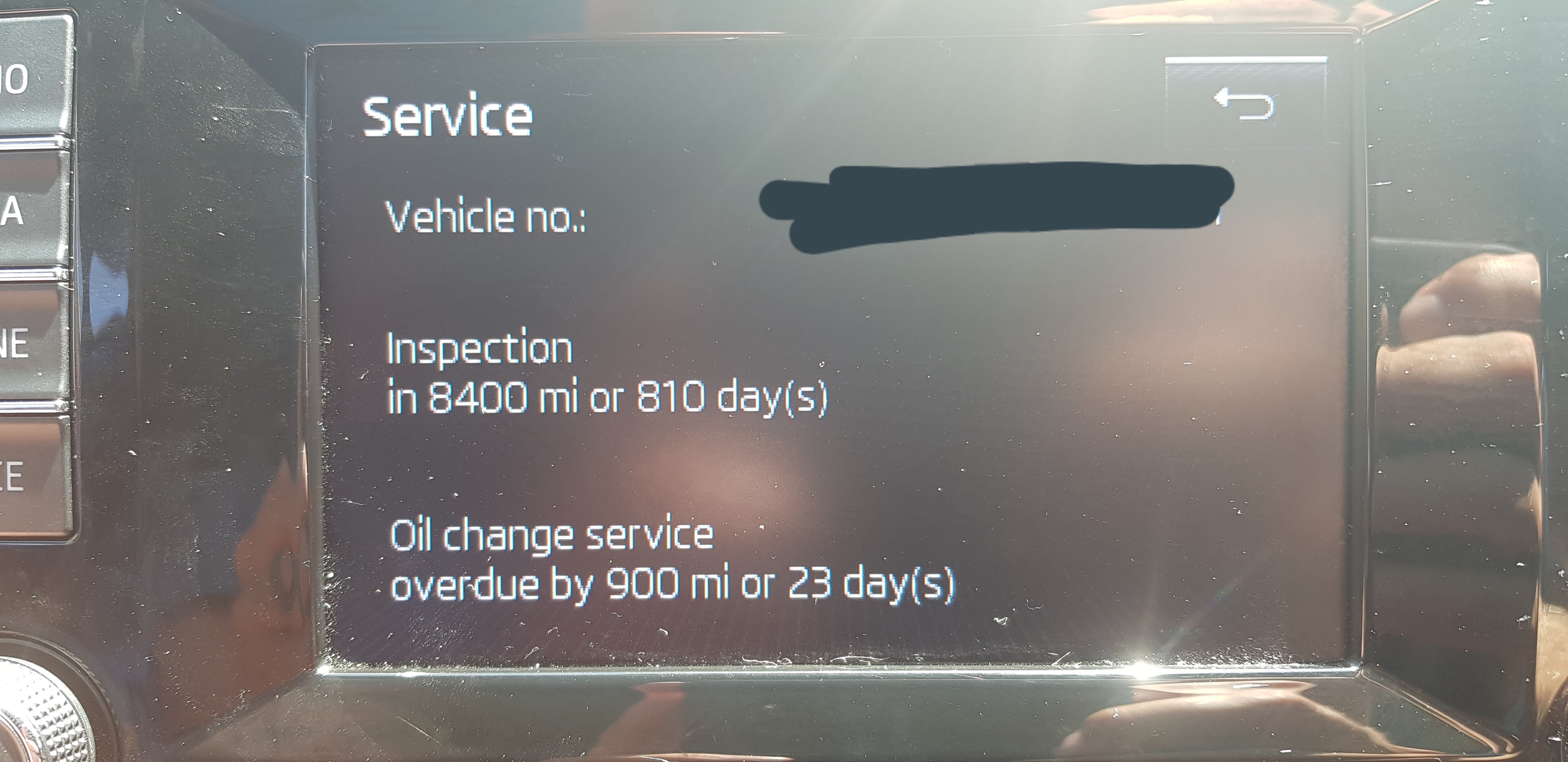

This is what it says, thanks for all the advice people.

Clearly not reset by the garage you bought the car from from this photo!:angry:
