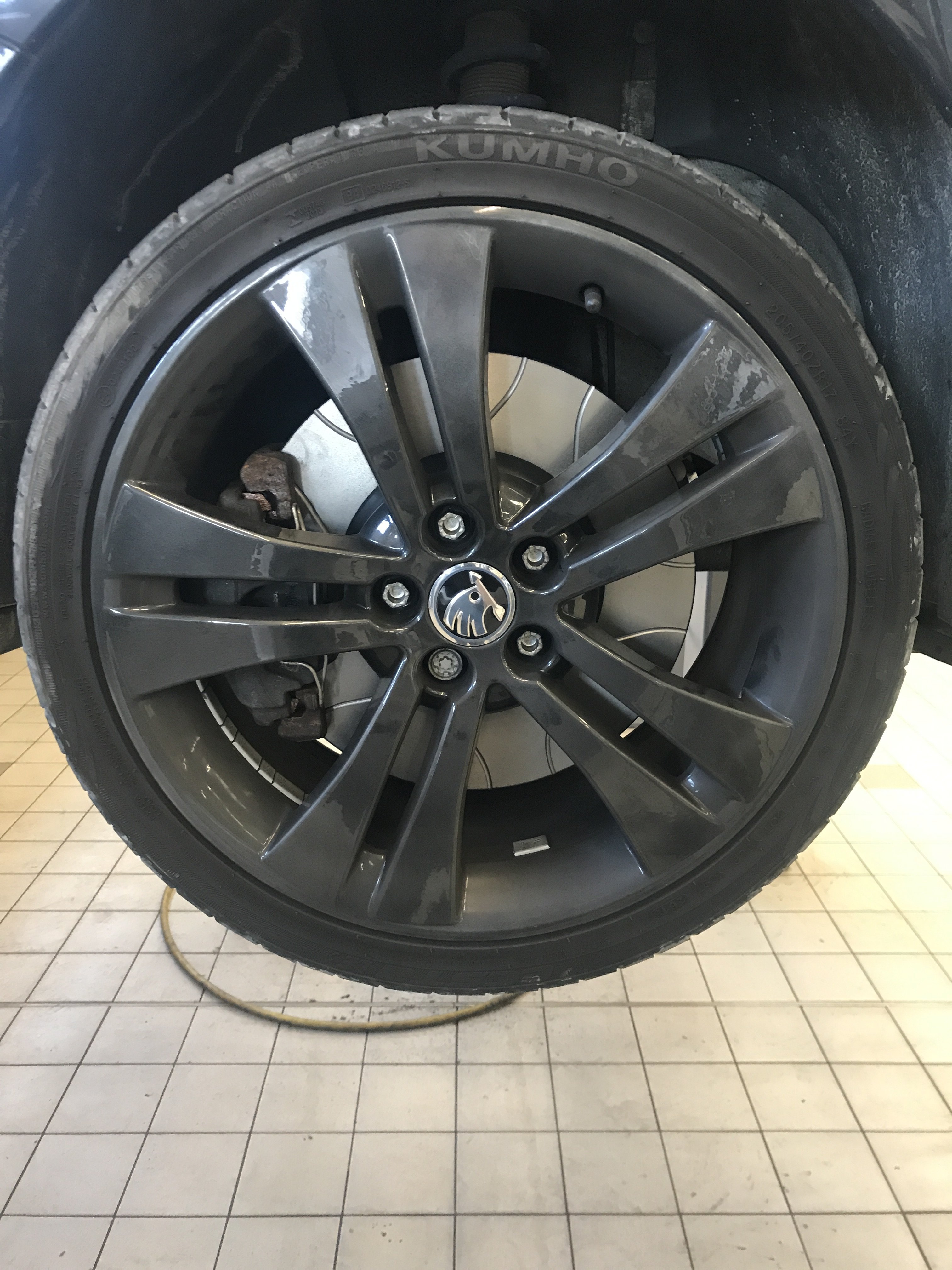

312s with brembos :) amazing I know I don’t track it but can imagine they would be great on track.
I like!Straight fit and what you got on the back?

Umm straight fit but need calipers and carriers. Still got drums on the back never really fancied a disc conversion and trying to stop the spending on the car now. Just tying to keep it maintained now :)
