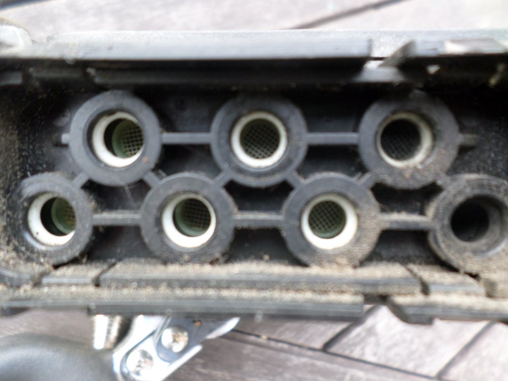

Bit of an old thread I know but I have been following your admirably tenacious thread re: poor EGR flow as I have had exactly the same problem with my Octavia. Including limp mode, which I seem to have sorted with the help of fuel tank additives and driving in low gears like a lunatic to burn off all the coke in the air intake and EGR system.
Anyway today I fitted a £20 vacuum solenoid sourced from "our best friend" Ebay and BINGO! So far and touch wood the dreaded light has not reappeared!
One thing I noticed on the old Vac unit I took out is that two of the ports on it seem to be full of "soot", each port has a little filter doesn't it, could these choked up little filters be that problem?
If I CBA and assuming the fix is indeed permanent I may just clean the filters and re-fit the unit to see?
So I took a piccy of the old vacuum vac unit, the photo vaguely shows the blackness of the gunk in the filters of the two right hand ports on the shot.
