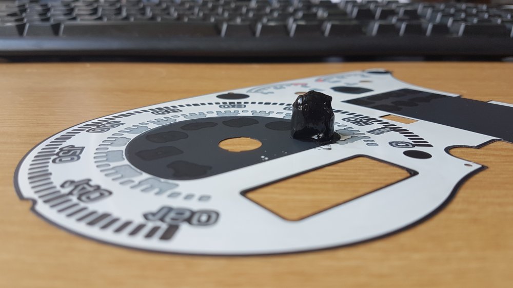

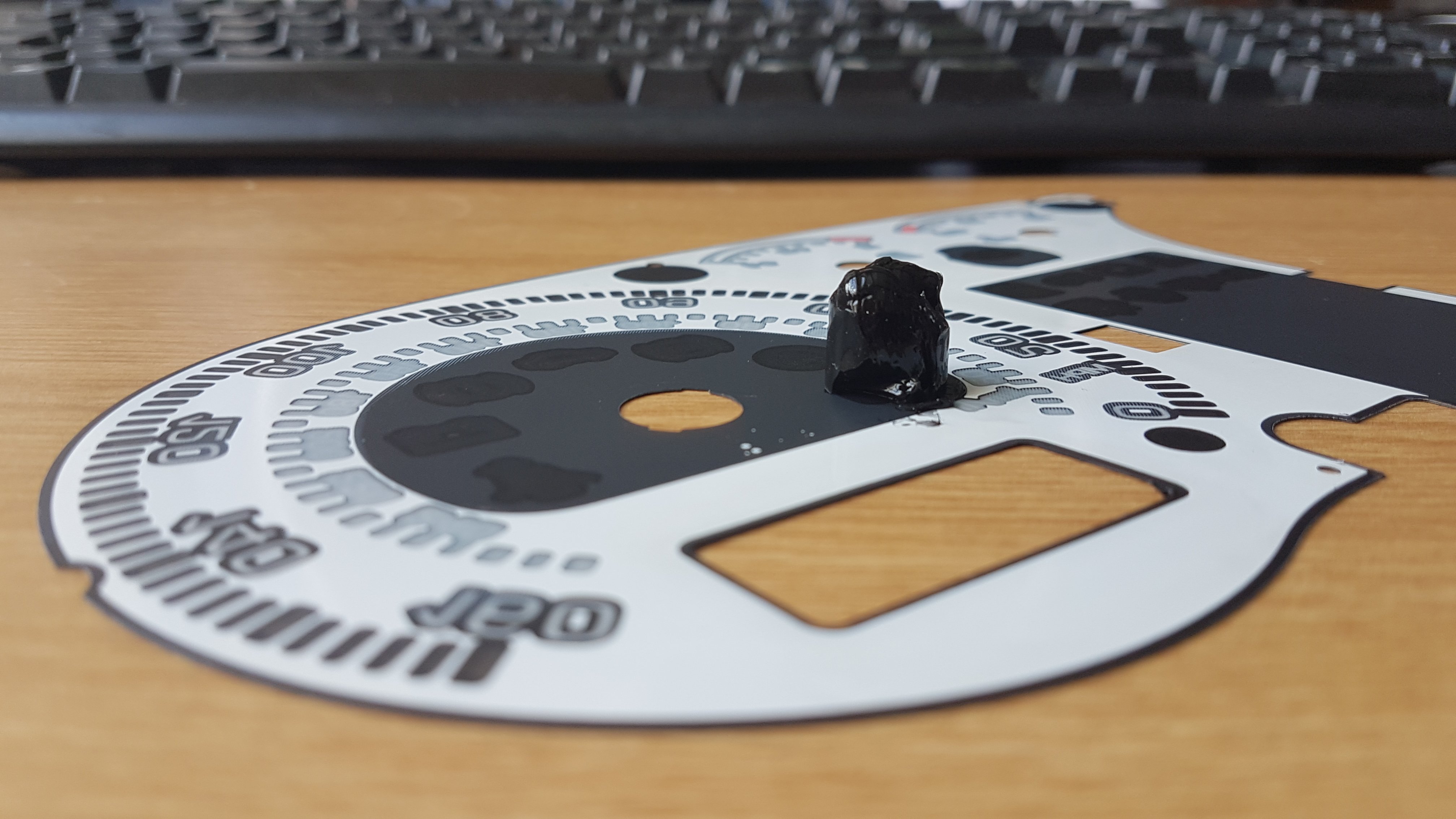

And wouldn't you believe it. someone has put silicone in the recess to cover the eml led.
Edited by drew_smith
naughty naughty!
Problem fixed. Thanks people
