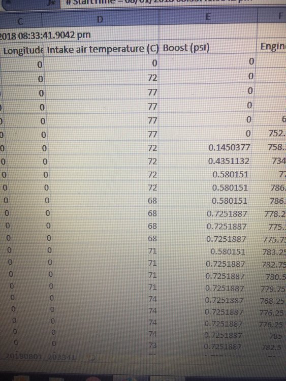

I’ve just had this issue do you have OBD fusion?
No, I have full licence VCDS from Ross-Tech. Engine light back on after 24 hours. Calling Skoda first thing to resolve.
Can you log the intake temp over a drive like this?
Also where in Scotland are you?
I'm in Aberdeenshire. Regards intake temperature - breakdown of statistics, no idea, but I'm sure if I go into the guts of the VCDS, it'll be there somewhere.
It's booked in for Skoda to have a look on Friday. Word of warning if anyone is thinking of claiming against 24 month fix warranty. After speaking to Skoda reception - it's £108 for an hour diagnosis. If they are liable they they'll do the work free-of-charge. If it's a new fault unrelated to emission fix carried out last year, then I pick up the tab. It's a difficult one, as I'd use my local garage who charges a fraction of this and I trust completely, but there's obviously a cost at the end of the day. I need it resolved as it's my daily driver, but seriously thinking of getting rid of this car.
I've just got it through another MOT last month and has had the usual EGR, glow-plug issues which were expensive to fix. Never had as many issues with my old Audi V6 2.5TDI quattro, and that was on double the mileage. Trouble is, there's stricter checks at MOTs, plus the software VW has introduced needs to accurately report and regulate emissions, plus introduction of DPFs so there has to be a trade-off right?
Ah ok thought you might have been local and I could have datalogged it for you.
Only reason I asked was that it was showing intake temp of -40
if you could datalog it and the temps all over then 100% it’s a map sensor.
