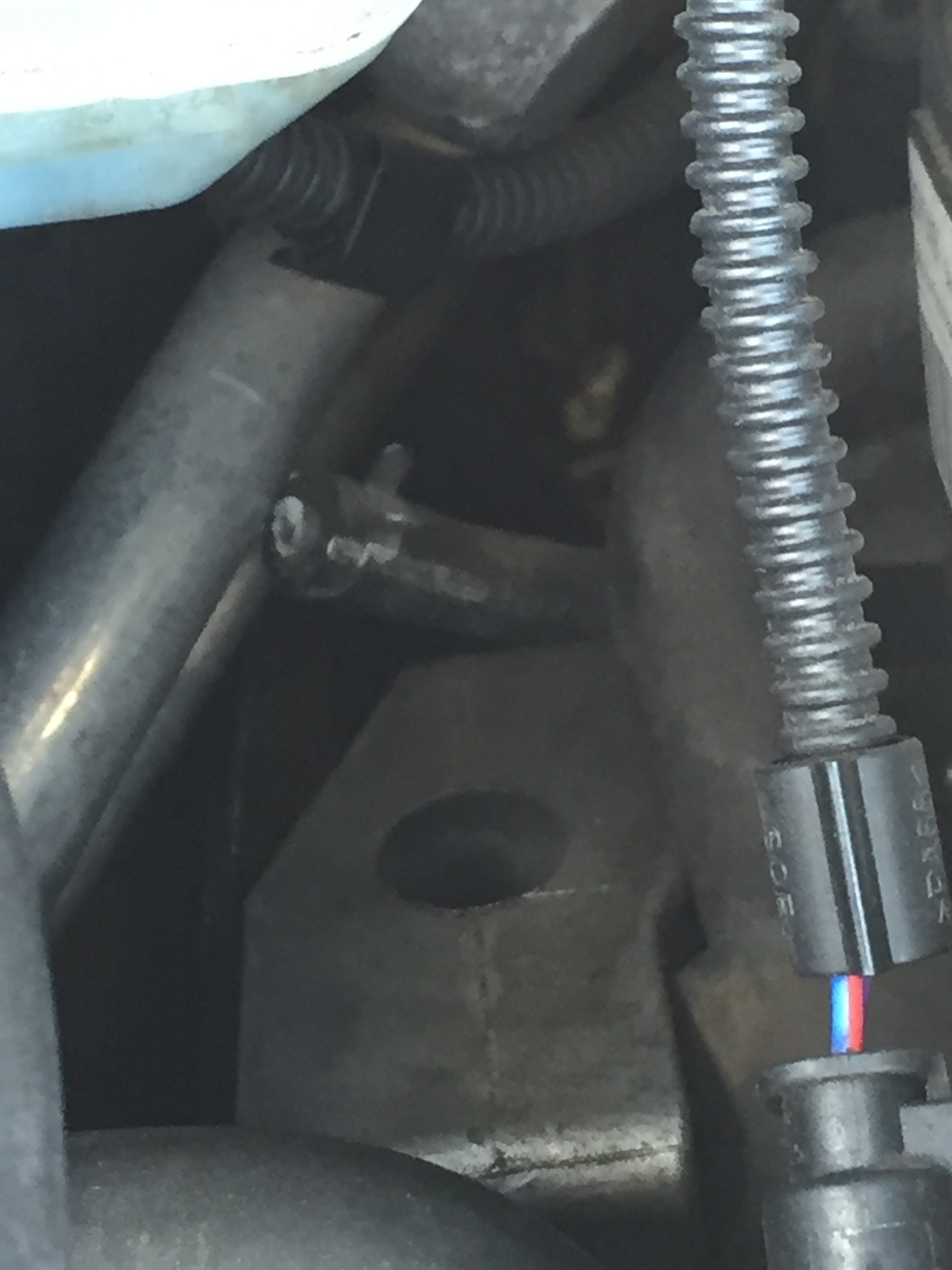

So was having a little look around engine and trying to feel for any air leaked and found this pipe that looks to be broken off somewhere. Any ideas?
