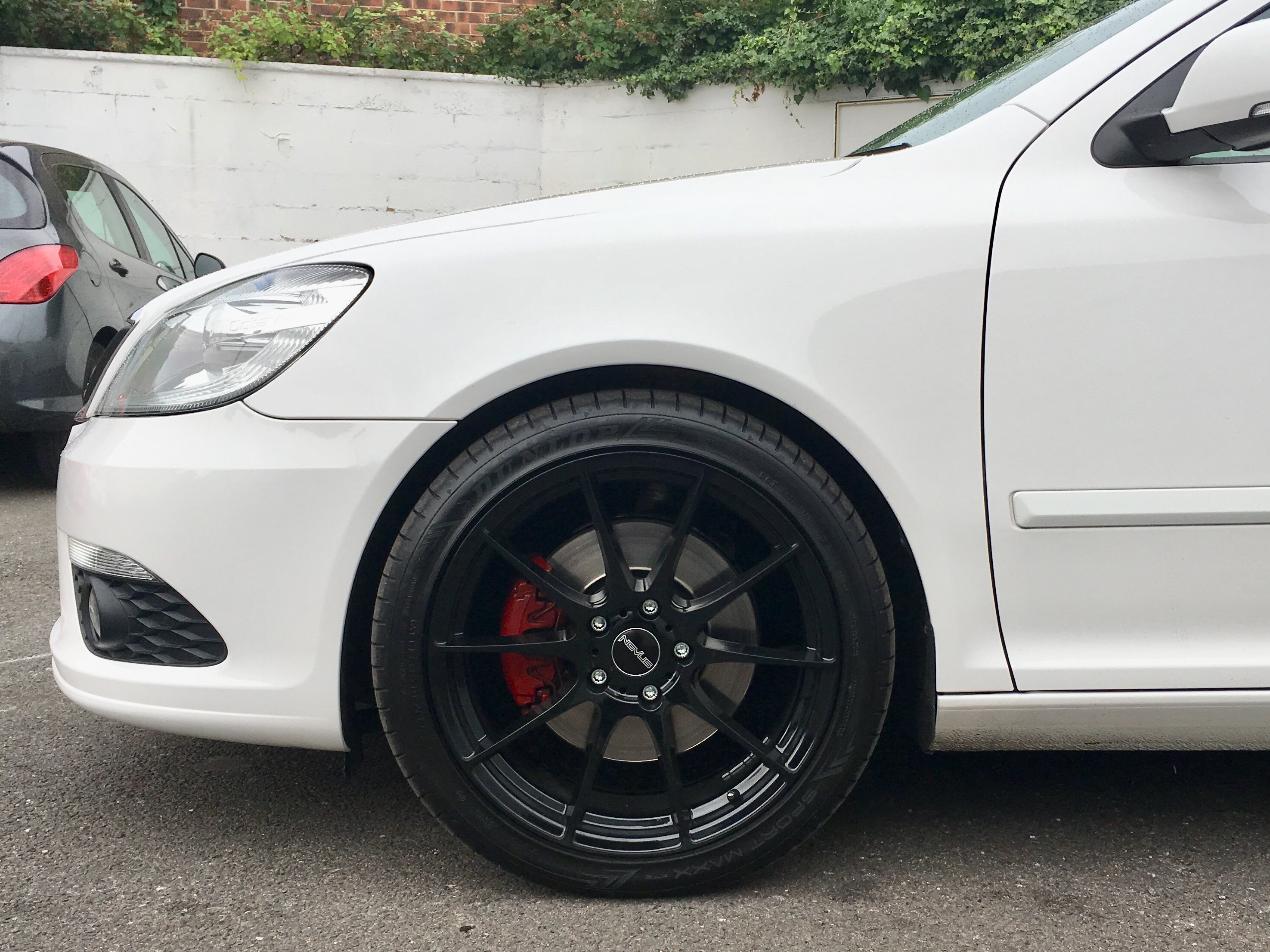

I ve got 235/40 18 on 8J alloys, they look perfect , just enough rim protection .. I’ll take a pic if you want. To see how it looks like. Let me know
Edited by vrsdx57
Yes please if you don't mind :)

There will be 2 benefits: first your alloy will be better protected because the tyre will sit a couple of mm outwards, second 235 has the wall a few mm higher (tyre wall height is percentage from it’s width),  can’t remember how much exactly without the tyre calculator, but it will contribute a bit to ride comfort; if it matters to you. PS 225 should not be stretched on 8j it will probably sit at the same level with alloy..
Edited by vrsdx57
Will do
235/40-18 on 8j pics
As you can see there’s 2-3mm of tyre over the alloy; you should be  alright with 225 also, probably levelled.
Another one from further away.
