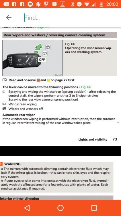

It is meant to happen....
"Automatic rear wiper
If the windscreen wiping is performed without interruption, then the automatic regular intermittent wiping of the rear window takes place."
It's just rather annoying it can't be disabled. If the rain is driving towards the windscreen and you're travelling at motorway speeds the rear screen stays virtually dry.

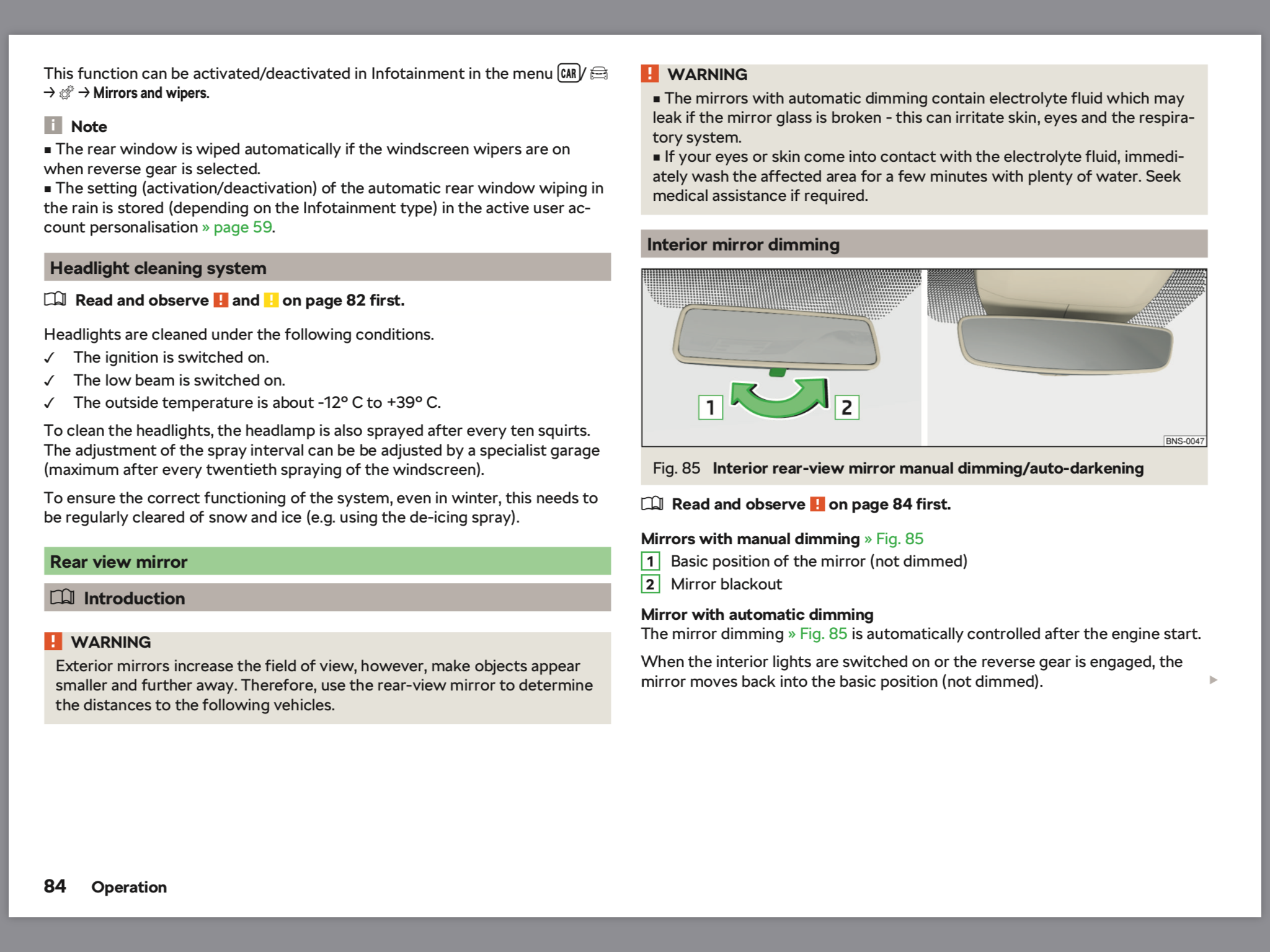

My copy of the eManual suggests this “auto wipe” can be deactivated via the menu.
I know mine is turned off as it seemed to also be connected to (motorway) speed for a certain time with front wipers on.
The manual makes mention of 'active user account personalisation', not sure if I have this?
Mine only seems to do it at motorway speeds. I'd like to turn it off though if possible.
Thanks both. As I mentioned in....
It seems possible if you have personalisation. It's just bizarre you can't disable it without the personalisation!
