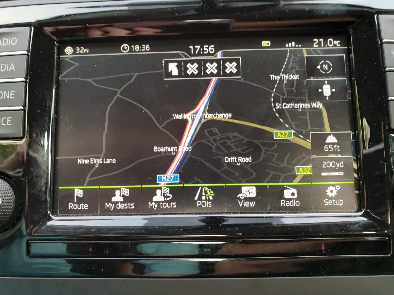

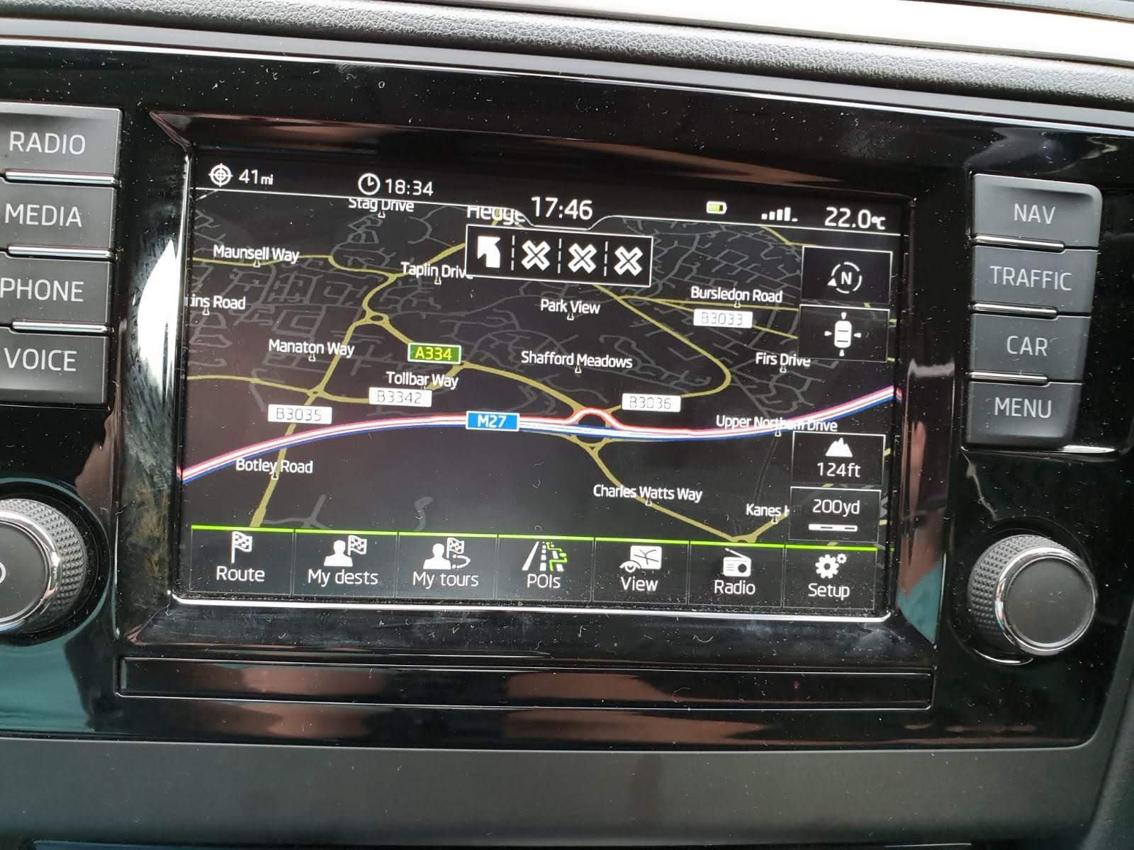

Was out with the family on Wednesday, and as luck would have it - it happened again on the way home - both times on the M27 within 10 mins of each other.
Manged to get my other half to snap some photos of the display.
As you can see, it wants us to take the junction, and carry directly over, and re-join.

I know that section of M27 well (I used to work in Portsmouth and live in Southampton).
Do you have active routing enabled? If so, it's very possible that the TMC data being transmitted via RDS is showing that the M27 is congested enough (at 17:46 that's more than likely based on my commutes!) for it to be quicker to go off and back on at the junction.

Had a couple of Beemers with last generation iDrive, a Volvo with Sensus and Merc with COMAND, and they all did this from time to time; I think @SWBoy is probably on the right track with why they do it.
