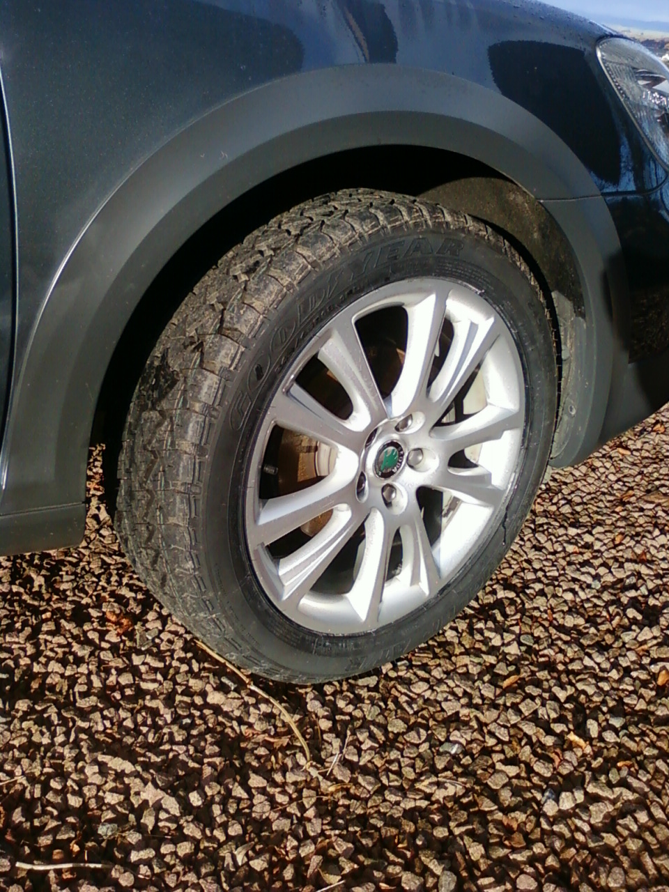

post-8144-0-55822100-1300820387_thumb.jpgpost-8144-0-47001400-1353062321_thumb.jpg245/45 18 or 245/40 19 tyres on similar ET51/ET52 wheels is realistically the maximum you could fit on existing suspension - so less if you (want to) lower it. Ride does improve by this alone, but that's only 1 step in your path.  Wheel arches are filled better, but the turned shoulder clearance is the limiting factor precluding taller/wider fitments.
