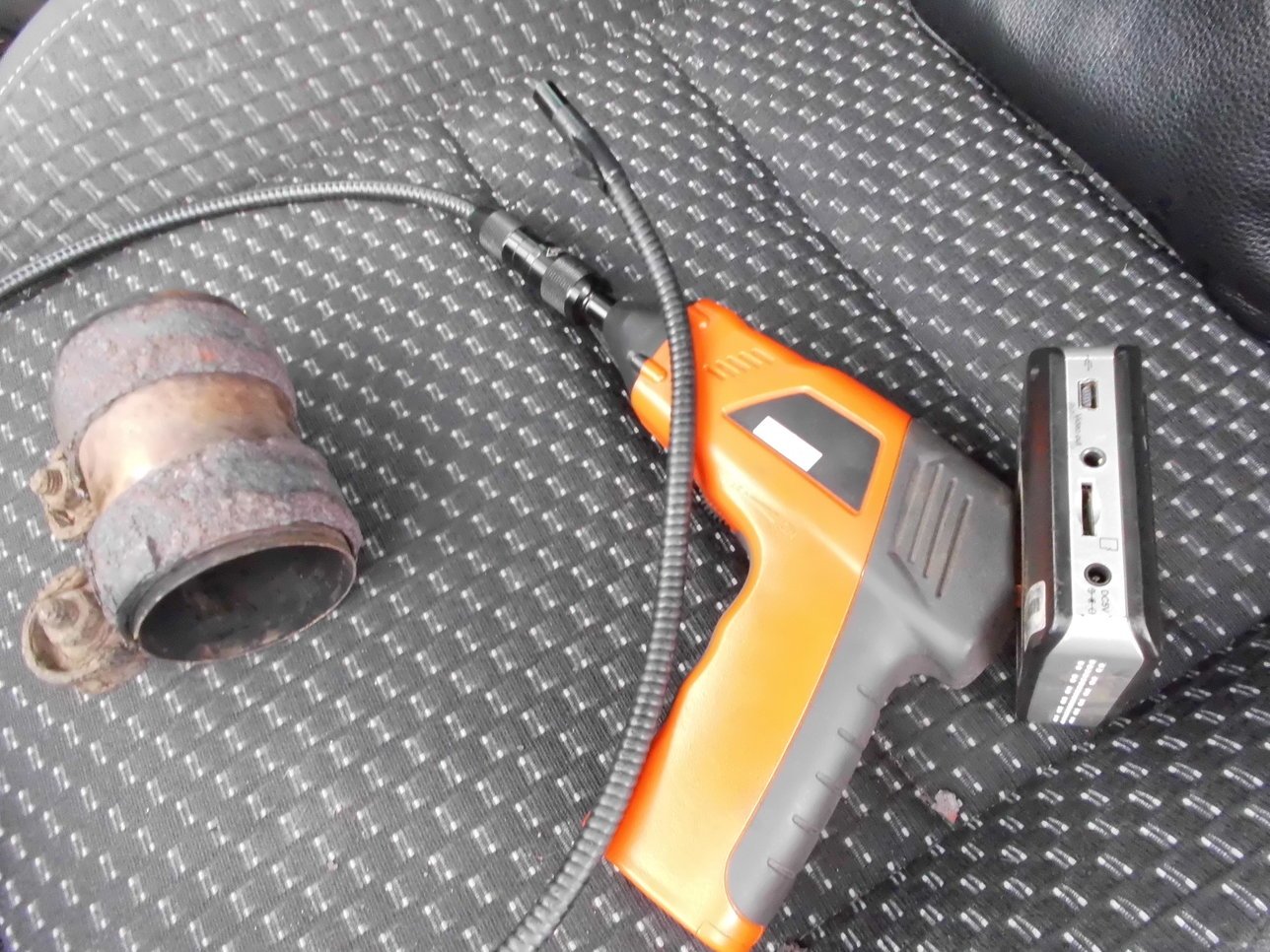

Compression test then.
See what the story is on that cylinder, and the tech / mechanic might use a Borescope,  have a look see down the plug holes.
