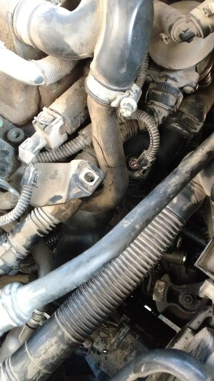

Hello all,
I am looking for the name of this part in the middle of the pic that is torn and the part number,
thank you in advance
Stavros
It's a breather hose. Part number might be on here somewhere already if you hunt around. Lots of people (myself included) have replaced them with silicone ones available on eBay.

thank you petrolbloke :)

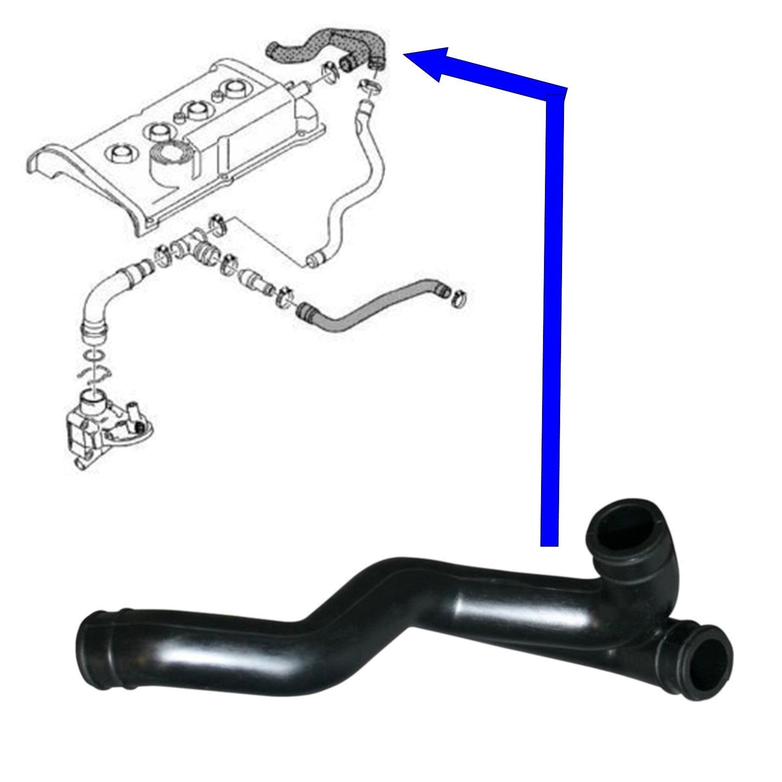

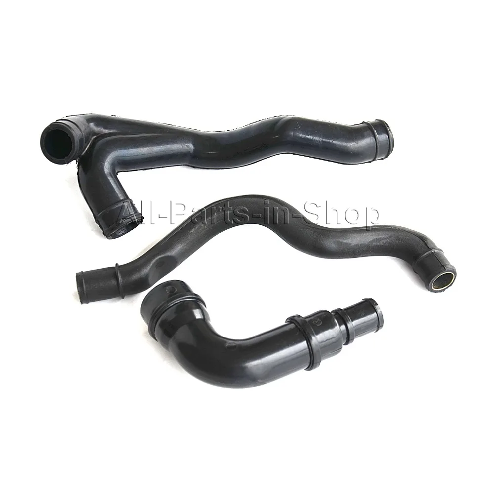

I think it is the one on the top, in the picture, https://ae01.alicdn.com/kf/HTB1fDvmKpXXXXcYXXXXq6xXFXXXy/1-x-Set-Crankcase-Breather-Hose-for-Audi-A3-A4-A6-VW-Bora-Golf-Skoda-Octavia.jpg
What troubles me is that the short arm of the part in my picture looks like it is flexible, but the aftermarket part is not.
On second thought, I think it is the second part in the picture, just get the set on the safe side lol

I've just done this for mine. I replaced the split y pipe, and then broke the pipe connecting to that, replaced that, then that broke the 90degree angle pipe so that had to be replaced.
I didn't bother with TPS replacement parts (except the 90 degree pipe), I got the upgraded silicone like most.
https://www.ebay.co.uk/itm/SEAT-LEON-CUPRA-1-8T-20V-180-BHP-SILICONE-CRANKCASE-BREATHER-PCV-HOSE-AUM-AUQ/162104120837?ssPageName=STRK%3AMEBIDX%3AIT&var=461065101225&_trksid=p2057872.m2749.l2649
https://www.ebay.co.uk/itm/GOLF-MK4-LEON-A3-OCTAVIA-TT-1-8T-PCV-LOWER-BREATHER-PIPE-AUM-AUQ-APY-AMK-BAM-07/161811221364?ssPageName=STRK%3AMEBIDX%3AIT&var=460783912402&_trksid=p2057872.m2749.l2649
Got the part number for vw/tps too if it helps:
90degree pipe (06A 103 213 F  -  breather line)
Y Pipe (06A 103 213 M  -  breather line)
Breather Pipe that connect to the Y pipe (06A 103 213 BG  -  breather line)

yes mine is the 9A part, yours is the 9. My engine is AUM
http://www.oemepc.com/skoda/part_single/catalog/sk/markt/CZ/modell/OCT/year/2001/drive_standart/252/hg_ug/103/subcategory/103085/part_id/0/lang/e
