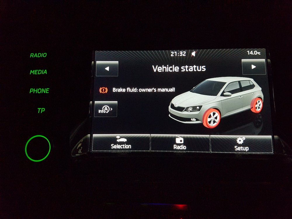

I was driving home from work last night & I had a "brake fluid" warning come up on the dash & it also shows up on the main screen under the car menu, the brakes didn't feel as sharp as usual but the pedal didn't feel spongy.
I noticed in the service history that it's had the brake fluid changed in may & I was wondering if it's something to do with that, maybe it wasn't topped up enough after the brakes were bled or is it something else?

So after a trip back to the dealers the car is fine, they basically admitted that they messed up when they changed the brake fluid, topped up the fluid & bled the brakes & they certainly feel better.
