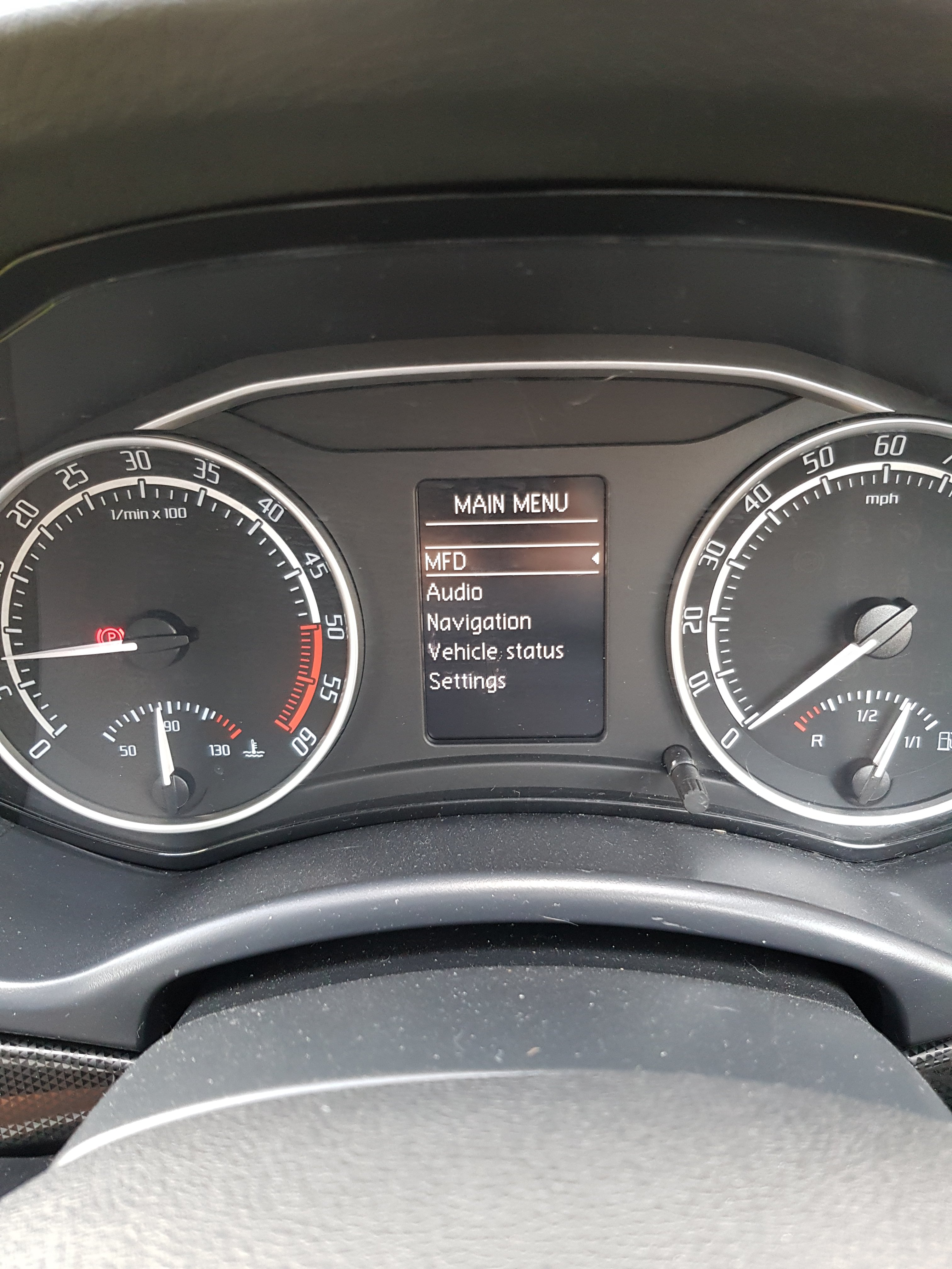

I had a small accident in my 12plate octavia vrsand had my bumper, grill, light and intercooler changed by the body shop. I've picked my car up today and I have no phone options on the maxidot or on the display screen and if I press the phone button it mutes the radio. my phone is showing as connected but there is no function in the car. i had to reset the time so im guessinv the battery was disconnected. Anyone know if this is something silly I have missed or should I be heading back to the repair centre?

oh I'm not sure just the one that fitted as standard in the 62 plate black edition. both Samsung and I phone are saying connected but the phone function no longer exists on the car.

That is strange .... I cant see how disconnecting the battery would remove the Bluetooth option from the Maxi Dot display/Main Menu.
It'd be worth checking the Bluetooth module is plugged in and that plug isn't lose (under drivers seat).  I dont know if there is a fuse on the module but that would be worth checking as well.
